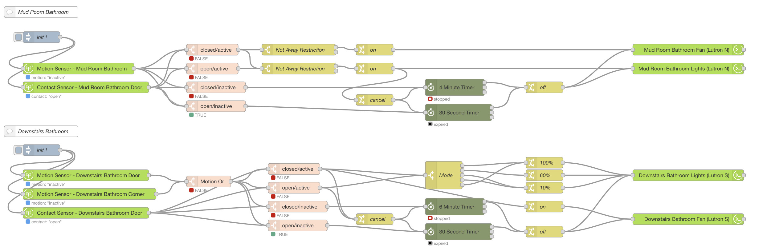

here are a couple examples for you. These are two of my bathrooms. one with two motion sensors, and one with only one. I have contact sensors on the doors also. If the door is open the timeout is very short, if the door is closed, then the fan comes on and the timeout is much longer, in order to account for less movement or visibility (on toilet or shower). If the lights turn out on me, it means I should probably stop reading forum posts and get off the pot!
Flow
[{"id":"5b27ad0.730cdd4","type":"tab","label":"Flow 3","disabled":false,"info":""},{"id":"1e101ad6.d58445","type":"hubitat device","z":"5b27ad0.730cdd4","name":"Motion Sensor - Mud Room Bathroom","server":"319c6842.9a57d8","deviceId":"426","attribute":"motion","sendEvent":true,"x":303,"y":289,"wires":[["22c7000.7b4c08","a9221931.e3bfe","3c7c7417.36990c","fdc49ec6.436ca"]]},{"id":"c9531a35.a85ff8","type":"hubitat device","z":"5b27ad0.730cdd4","name":"Contact Sensor - Mud Room Bathroom Door","server":"319c6842.9a57d8","deviceId":"1462","attribute":"contact","sendEvent":true,"x":323,"y":340,"wires":[["fdc49ec6.436ca","3c7c7417.36990c","a9221931.e3bfe","22c7000.7b4c08"]]},{"id":"57f0a236.b4ec7c","type":"change","z":"5b27ad0.730cdd4","name":"on","rules":[{"t":"set","p":"payload","pt":"msg","to":"100","tot":"num"},{"t":"set","p":"command","pt":"msg","to":"on","tot":"str"}],"action":"","property":"","from":"","to":"","reg":false,"x":1104,"y":289,"wires":[["b1b1c9d6.708d8","dae6ce96.84bed"]]},{"id":"a538682c.51a9d8","type":"change","z":"5b27ad0.730cdd4","name":"off","rules":[{"t":"set","p":"payload","pt":"msg","to":"0","tot":"str"},{"t":"set","p":"command","pt":"msg","to":"off","tot":"str"}],"action":"","property":"","from":"","to":"","reg":false,"x":1563,"y":340,"wires":[["dae6ce96.84bed","9f630a75.c7fa5"]]},{"id":"b1b1c9d6.708d8","type":"change","z":"5b27ad0.730cdd4","name":"cancel","rules":[{"t":"delete","p":"payload.value","pt":"msg"},{"t":"set","p":"payload","pt":"msg","to":"stop","tot":"str"}],"action":"","property":"","from":"","to":"","reg":false,"x":1104,"y":374,"wires":[["a566d30a.dcd26","674afebd.0d7fe8"]]},{"id":"22c7000.7b4c08","type":"and-gate","z":"5b27ad0.730cdd4","name":"closed/active","rules":[{"t":"eq","v":"active","vt":"str","propertyType":"msg","property":"payload.value","topic":"Motion Sensor - Mud Room Bathroom"},{"t":"eq","v":"closed","vt":"str","propertyType":"msg","property":"payload.value","topic":"Contact Sensor - Mud Room Bathroom Door"}],"outputTopic":"","gateType":"and","emitOnlyIfTrue":true,"x":665,"y":238,"wires":[["242d7418.94a934","fd7cd315.405368"]]},{"id":"3c7c7417.36990c","type":"and-gate","z":"5b27ad0.730cdd4","name":"closed/inactive","rules":[{"t":"eq","v":"inactive","vt":"str","propertyType":"msg","property":"payload.value","topic":"Motion Sensor - Mud Room Bathroom"},{"t":"eq","v":"closed","vt":"str","propertyType":"msg","property":"payload.value","topic":"Contact Sensor - Mud Room Bathroom Door"}],"outputTopic":"","gateType":"and","emitOnlyIfTrue":true,"x":675,"y":340,"wires":[["674afebd.0d7fe8"]]},{"id":"a9221931.e3bfe","type":"and-gate","z":"5b27ad0.730cdd4","name":"open/active","rules":[{"t":"eq","v":"active","vt":"str","propertyType":"msg","property":"payload.value","topic":"Motion Sensor - Mud Room Bathroom"},{"t":"eq","v":"open","vt":"str","propertyType":"msg","property":"payload.value","topic":"Contact Sensor - Mud Room Bathroom Door"}],"outputTopic":"","gateType":"and","emitOnlyIfTrue":true,"x":665,"y":289,"wires":[["242d7418.94a934"]]},{"id":"fdc49ec6.436ca","type":"and-gate","z":"5b27ad0.730cdd4","name":"open/inactive","rules":[{"t":"eq","v":"inactive","vt":"str","propertyType":"msg","property":"payload.value","topic":"Motion Sensor - Mud Room Bathroom"},{"t":"eq","v":"open","vt":"str","propertyType":"msg","property":"payload.value","topic":"Contact Sensor - Mud Room Bathroom Door"}],"outputTopic":"","gateType":"and","emitOnlyIfTrue":true,"x":675,"y":391,"wires":[["a566d30a.dcd26"]]},{"id":"d8e1f318.1483b","type":"inject","z":"5b27ad0.730cdd4","name":"init","props":[{"p":"payload"},{"p":"topic","vt":"str"}],"repeat":"","crontab":"","once":true,"onceDelay":"10","topic":"","payload":"","payloadType":"date","x":203,"y":204,"wires":[["c9531a35.a85ff8","1e101ad6.d58445"]]},{"id":"7f53ef6e.facb48","type":"change","z":"5b27ad0.730cdd4","name":"on","rules":[{"t":"set","p":"payload","pt":"msg","to":"100","tot":"num"},{"t":"set","p":"command","pt":"msg","to":"on","tot":"str"}],"action":"","property":"","from":"","to":"","reg":false,"x":1104,"y":238,"wires":[["9f630a75.c7fa5"]]},{"id":"a9444693.527e38","type":"hubitat device","z":"5b27ad0.730cdd4","name":"Motion Sensor - Downstairs Bathroom Corner","server":"cd816c39.6978b","deviceId":"1382","attribute":"motion","sendEvent":true,"x":333,"y":629,"wires":[["a0d98dfa.6e7e5"]]},{"id":"148b10a8.aca03f","type":"hubitat device","z":"5b27ad0.730cdd4","name":"Contact Sensor - Downstairs Bathroom Door","server":"cd816c39.6978b","deviceId":"1383","attribute":"contact","sendEvent":true,"x":323,"y":680,"wires":[["6e4b42f8.a5ae9c","c91bafca.88a358","dd1568e5.c3c798","35709110.9f3a16"]]},{"id":"c9a48b2.66042f8","type":"change","z":"5b27ad0.730cdd4","name":"off","rules":[{"t":"set","p":"payload","pt":"msg","to":"0","tot":"str"},{"t":"set","p":"command","pt":"msg","to":"off","tot":"str"}],"action":"","property":"","from":"","to":"","reg":false,"x":1563,"y":731,"wires":[["10e9c09c.4ed167","ffaa1af6.f637f8"]]},{"id":"c4b8999b.df5898","type":"change","z":"5b27ad0.730cdd4","name":"cancel","rules":[{"t":"delete","p":"payload.value","pt":"msg"},{"t":"set","p":"payload","pt":"msg","to":"stop","tot":"str"}],"action":"","property":"","from":"","to":"","reg":false,"x":1104,"y":697,"wires":[["77d86b84.e5a25c","a03f77b1.f714c8"]]},{"id":"8c3ac8a.3e399b8","type":"inject","z":"5b27ad0.730cdd4","name":"init","props":[{"p":"payload"},{"p":"topic","vt":"str"}],"repeat":"","crontab":"","once":true,"onceDelay":"10","topic":"","payload":"","payloadType":"date","x":203,"y":510,"wires":[["a9444693.527e38","caecd6bc.93aac8","148b10a8.aca03f"]]},{"id":"90931144.ab51","type":"change","z":"5b27ad0.730cdd4","name":"on","rules":[{"t":"set","p":"payload","pt":"msg","to":"100","tot":"num"},{"t":"set","p":"command","pt":"msg","to":"on","tot":"str"}],"action":"","property":"","from":"","to":"","reg":false,"x":1563,"y":663,"wires":[["ffaa1af6.f637f8"]]},{"id":"4b036700.e9374","type":"comment","z":"5b27ad0.730cdd4","name":"Downstairs Bathroom","info":"","x":202,"y":459,"wires":[]},{"id":"96bfdbf0.08e5b8","type":"comment","z":"5b27ad0.730cdd4","name":"Mud Room Bathroom","info":"","x":202,"y":136,"wires":[]},{"id":"caecd6bc.93aac8","type":"hubitat device","z":"5b27ad0.730cdd4","name":"Motion Sensor - Downstairs Bathroom Door","server":"cd816c39.6978b","deviceId":"1381","attribute":"motion","sendEvent":true,"x":323,"y":578,"wires":[["a0d98dfa.6e7e5"]]},{"id":"a0d98dfa.6e7e5","type":"or-gate","z":"5b27ad0.730cdd4","name":"Motion Or","rules":[{"t":"eq","v":"active","vt":"str","propertyType":"msg","property":"payload.value","topic":"Motion Sensor - Downstairs Bathroom Door"},{"t":"eq","v":"active","vt":"str","propertyType":"msg","property":"payload.value","topic":"Motion Sensor - Downstairs Bathroom Corner"}],"outputTopic":"motion","gateType":"or","emitOnlyIfTrue":false,"x":655,"y":595,"wires":[["6e4b42f8.a5ae9c","c91bafca.88a358","dd1568e5.c3c798","35709110.9f3a16"]]},{"id":"6e4b42f8.a5ae9c","type":"and-gate","z":"5b27ad0.730cdd4","name":"closed/active","rules":[{"t":"true","propertyType":"msg","property":"bool","topic":"motion"},{"t":"eq","v":"closed","vt":"str","propertyType":"msg","property":"payload.value","topic":"Contact Sensor - Downstairs Bathroom Door"}],"outputTopic":"","gateType":"and","emitOnlyIfTrue":true,"x":886,"y":561,"wires":[["90931144.ab51","c4b8999b.df5898","2fff3924.ed427e"]]},{"id":"c91bafca.88a358","type":"and-gate","z":"5b27ad0.730cdd4","name":"open/active","rules":[{"t":"true","propertyType":"msg","property":"bool","topic":"motion"},{"t":"eq","v":"open","vt":"str","propertyType":"msg","property":"payload.value","topic":"Contact Sensor - Downstairs Bathroom Door"}],"outputTopic":"","gateType":"and","emitOnlyIfTrue":true,"x":886,"y":612,"wires":[["c4b8999b.df5898","2fff3924.ed427e"]]},{"id":"dd1568e5.c3c798","type":"and-gate","z":"5b27ad0.730cdd4","name":"closed/inactive","rules":[{"t":"false","propertyType":"msg","property":"bool","topic":"motion"},{"t":"eq","v":"closed","vt":"str","propertyType":"msg","property":"payload.value","topic":"Contact Sensor - Downstairs Bathroom Door"}],"outputTopic":"","gateType":"and","emitOnlyIfTrue":true,"x":896,"y":663,"wires":[["77d86b84.e5a25c"]]},{"id":"35709110.9f3a16","type":"and-gate","z":"5b27ad0.730cdd4","name":"open/inactive","rules":[{"t":"false","propertyType":"msg","property":"bool","topic":"motion"},{"t":"eq","v":"open","vt":"str","propertyType":"msg","property":"payload.value","topic":"Contact Sensor - Downstairs Bathroom Door"}],"outputTopic":"","gateType":"and","emitOnlyIfTrue":true,"x":896,"y":714,"wires":[["a03f77b1.f714c8"]]},{"id":"ecb1277a.3f6248","type":"change","z":"5b27ad0.730cdd4","name":"10%","rules":[{"t":"set","p":"payload","pt":"msg","to":"10","tot":"num"},{"t":"set","p":"command","pt":"msg","to":"setLevel","tot":"str"},{"t":"set","p":"arguments","pt":"msg","to":"10,0","tot":"str"}],"action":"","property":"","from":"","to":"","reg":false,"x":1563,"y":612,"wires":[["10e9c09c.4ed167"]]},{"id":"efedd172.9ec6d","type":"change","z":"5b27ad0.730cdd4","name":"60%","rules":[{"t":"set","p":"payload","pt":"msg","to":"60","tot":"num"},{"t":"set","p":"command","pt":"msg","to":"setLevel","tot":"str"},{"t":"set","p":"arguments","pt":"msg","to":"60,0","tot":"str"}],"action":"","property":"","from":"","to":"","reg":false,"x":1563,"y":578,"wires":[["10e9c09c.4ed167"]]},{"id":"1a0bbf58.daa851","type":"change","z":"5b27ad0.730cdd4","name":"100%","rules":[{"t":"set","p":"payload","pt":"msg","to":"100","tot":"num"},{"t":"set","p":"command","pt":"msg","to":"setLevel","tot":"str"},{"t":"set","p":"arguments","pt":"msg","to":"100,0","tot":"str"}],"action":"","property":"","from":"","to":"","reg":false,"x":1563,"y":544,"wires":[["10e9c09c.4ed167"]]},{"id":"2fff3924.ed427e","type":"switch","z":"5b27ad0.730cdd4","name":"Mode","property":"mode","propertyType":"global","rules":[{"t":"eq","v":"day","vt":"str"},{"t":"eq","v":"evening","vt":"str"},{"t":"eq","v":"night","vt":"str"},{"t":"eq","v":"sleep","vt":"str"},{"t":"eq","v":"cleaninglady","vt":"str"}],"checkall":"true","repair":false,"outputs":5,"x":1291,"y":578,"wires":[["1a0bbf58.daa851"],["efedd172.9ec6d"],["ecb1277a.3f6248"],["ecb1277a.3f6248"],["1a0bbf58.daa851"]],"outputLabels":["Day","Evening","Night","Sleep","Cleaning Lady"]},{"id":"242d7418.94a934","type":"switch","z":"5b27ad0.730cdd4","name":"Not Away Restriction","property":"mode","propertyType":"global","rules":[{"t":"neq","v":"away","vt":"str"},{"t":"eq","v":"away","vt":"str"}],"checkall":"true","repair":false,"outputs":2,"x":899,"y":289,"wires":[["57f0a236.b4ec7c"],[]]},{"id":"fd7cd315.405368","type":"switch","z":"5b27ad0.730cdd4","name":"Not Away Restriction","property":"mode","propertyType":"global","rules":[{"t":"neq","v":"away","vt":"str"},{"t":"eq","v":"away","vt":"str"}],"checkall":"true","repair":false,"outputs":2,"x":899,"y":238,"wires":[["7f53ef6e.facb48"],[]]},{"id":"674afebd.0d7fe8","type":"stoptimer-varidelay","z":"5b27ad0.730cdd4","duration":"4","durationType":"num","units":"Minute","payloadtype":"num","payloadval":"0","name":"","reporting":"every_second","persist":false,"x":1321,"y":340,"wires":[["a538682c.51a9d8"],[],[]]},{"id":"a566d30a.dcd26","type":"stoptimer-varidelay","z":"5b27ad0.730cdd4","duration":"30","durationType":"num","units":"Second","payloadtype":"num","payloadval":"0","name":"","reporting":"every_second","persist":false,"x":1331,"y":408,"wires":[["a538682c.51a9d8"],[],[]]},{"id":"a03f77b1.f714c8","type":"stoptimer-varidelay","z":"5b27ad0.730cdd4","duration":"30","durationType":"num","units":"Second","payloadtype":"num","payloadval":"0","name":"","reporting":"every_second","persist":false,"x":1331,"y":731,"wires":[["c9a48b2.66042f8"],[],[]]},{"id":"77d86b84.e5a25c","type":"stoptimer-varidelay","z":"5b27ad0.730cdd4","duration":"6","durationType":"num","units":"Minute","payloadtype":"num","payloadval":"0","name":"","reporting":"every_second","persist":false,"x":1321,"y":663,"wires":[["c9a48b2.66042f8"],[],[]]},{"id":"dae6ce96.84bed","type":"hubitat command","z":"5b27ad0.730cdd4","deviceLabel":"Mud Room Bathroom Lights (Lutron N)","name":"","server":"319c6842.9a57d8","deviceId":"1272","command":"","commandArgs":"","x":1952,"y":289,"wires":[[]]},{"id":"9f630a75.c7fa5","type":"hubitat command","z":"5b27ad0.730cdd4","deviceLabel":"Mud Room Bathroom Fan (Lutron N)","name":"","server":"319c6842.9a57d8","deviceId":"1273","command":"","commandArgs":"","x":1952,"y":238,"wires":[[]]},{"id":"10e9c09c.4ed167","type":"hubitat command","z":"5b27ad0.730cdd4","deviceLabel":"Downstairs Bathroom Lights (Lutron S)","name":"","server":"cd816c39.6978b","deviceId":"1010","command":"","commandArgs":"","x":1952,"y":578,"wires":[[]]},{"id":"ffaa1af6.f637f8","type":"hubitat command","z":"5b27ad0.730cdd4","deviceLabel":"Downstairs Bathroom Fan (Lutron S)","name":"","server":"cd816c39.6978b","deviceId":"1011","command":"","commandArgs":"","x":1952,"y":697,"wires":[[]]},{"id":"319c6842.9a57d8","type":"hubitat config","name":"Hubitat North","usetls":false,"host":"192.168.20.21","port":"80","appId":"1685","nodeRedServer":"http://192.168.20.35:1880/","webhookPath":"/hubitat/webhook_","autoRefresh":true,"useWebsocket":false},{"id":"cd816c39.6978b","type":"hubitat config","name":"Hubitat South","usetls":false,"host":"192.168.20.20","port":"80","appId":"2064","nodeRedServer":"http://192.168.20.35:1880","webhookPath":"/hubitat/webhook","autoRefresh":true,"useWebsocket":false}] ‘’’

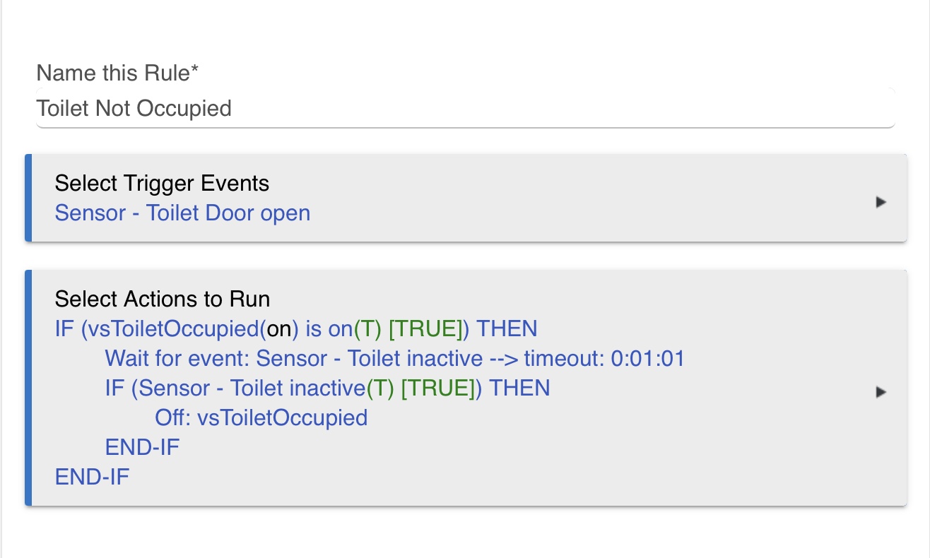

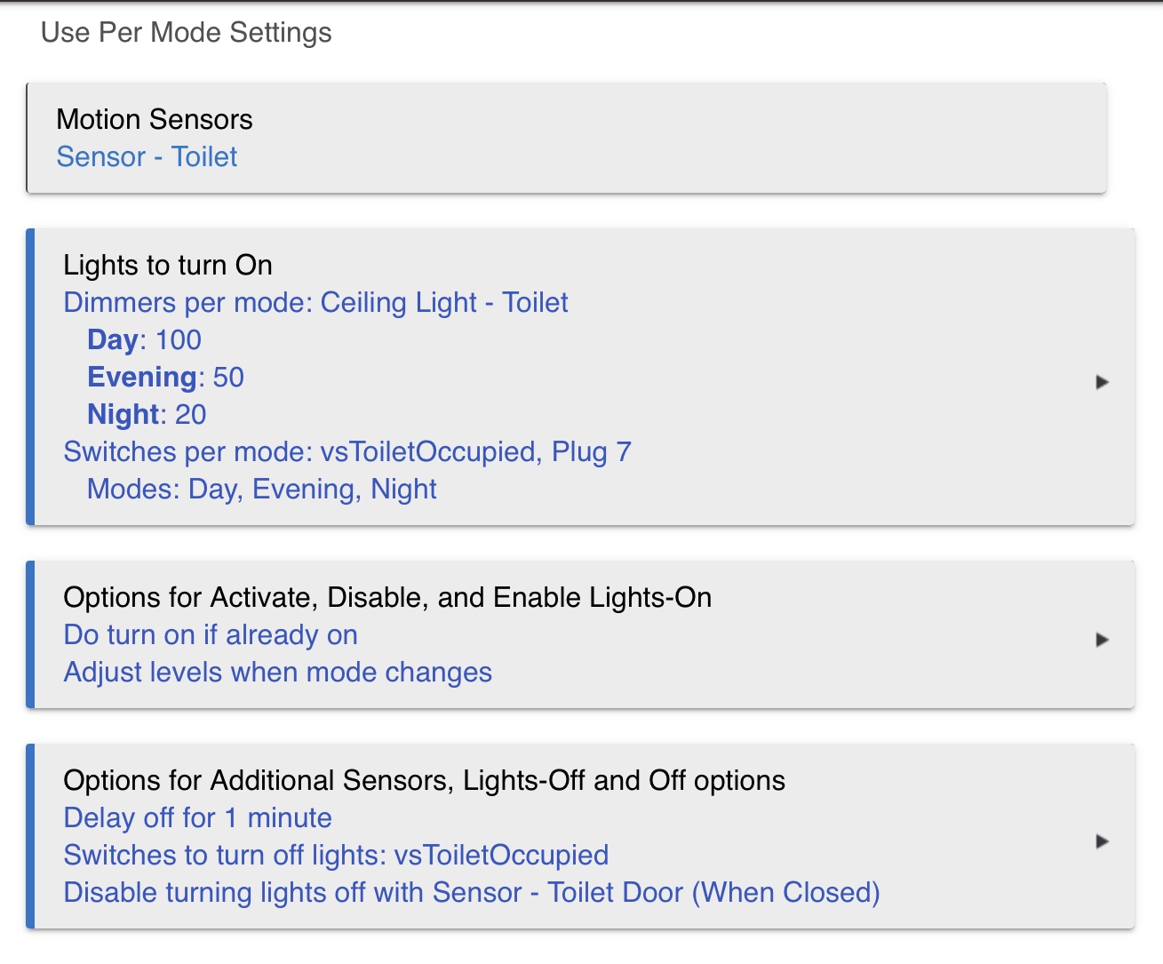

This isn’t a Node-Red solution, but it’s an attempt to solve the same problem. There are a number of different use cases regarding whether the door is closed, open on entry and exit, so I’m finding it difficult to solve.
My latest attempt includes a motion sensor with a 1 minute timeout, and a contact sensor on the door, a virtual switch ,Motion Lighting app, and an RM rule to help with the change to unoccupied.
Based on what I’ve read in this thread I’m adding a Philips Hue motion sensor to the door threshold, as it has a configurable retrigger value. It remains to be seen if that will allow me to finally get this right for all use cases :slight_smile:
