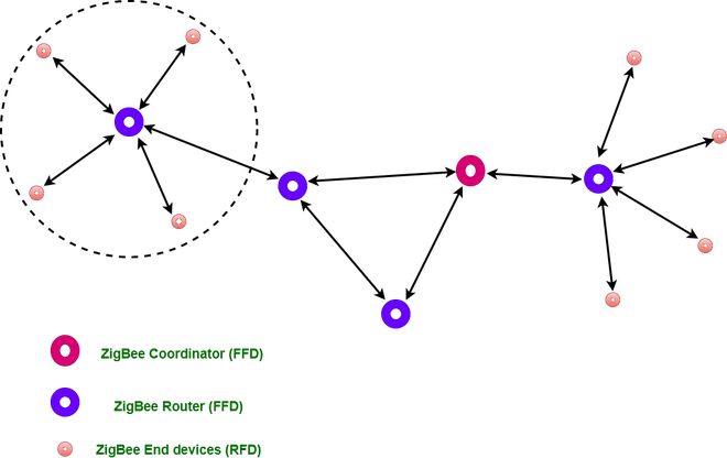

Having a stable and performant zigbee network requires a basic understanding of how zigbee networks function.
Zigbee is a MESH protocol. It relies on end devices of the mesh communicating with a central coordinator via zigbee routers.
In common parlance, end devices are things like battery powered sensors. Zigbee routers (also called repeaters) are devices that are directly plugged into the mains (i.e. in the US they are 120V devices). The zigbee coordinator is the hub, of which there can only be a single one in any mesh (so one hub per mesh).
Here’s a simple mesh demonstrating the function of all three types of devices:
IMG_0380
A zigbee hub can connect directly with a set number of devices - in the case of Hubitat that number is 32. This number of 32 includes both end devices and routers/repeaters (fyi - @LearningHubitat).
However, through routers/repeaters, a zigbee coordinator/hub can connect to as many as 65535 devices.
A stable and performant zigbee mesh needs a large number of routers/repeaters. My recommendation is one repeater for every 4-5 end devices. In the sample mesh shown above, there are 8 end devices (pink) and 4 routers (purple). That's one repeater for every 2 devices. A ratio of 2:1 is even better than a ratio of 4:1 or 5:1, but from many years of maintaining multiple zigbee networks, I am comfortable with the ratio I've indicated.
Because zigbee routers can only repeat for the coordinator they are paired/joined to, the repeaters in your mesh will have to be paired directly to Hubitat - there’s no need for any other hub.
I’m happy to answer any further questions you may have.
Edit - As @hydro311 has indicated, zigbee repeaters are not uniform in their performance. I don't have any iNovelli Blues, but I have had other devices installed in gangboxes. In general, metal gangboxes can interfere with the performance of zigbee routers. Sometimes other devices within the wall can interfere with their function as well. So in general, plug in devices tend to function better as zigbee routers/repeaters.
