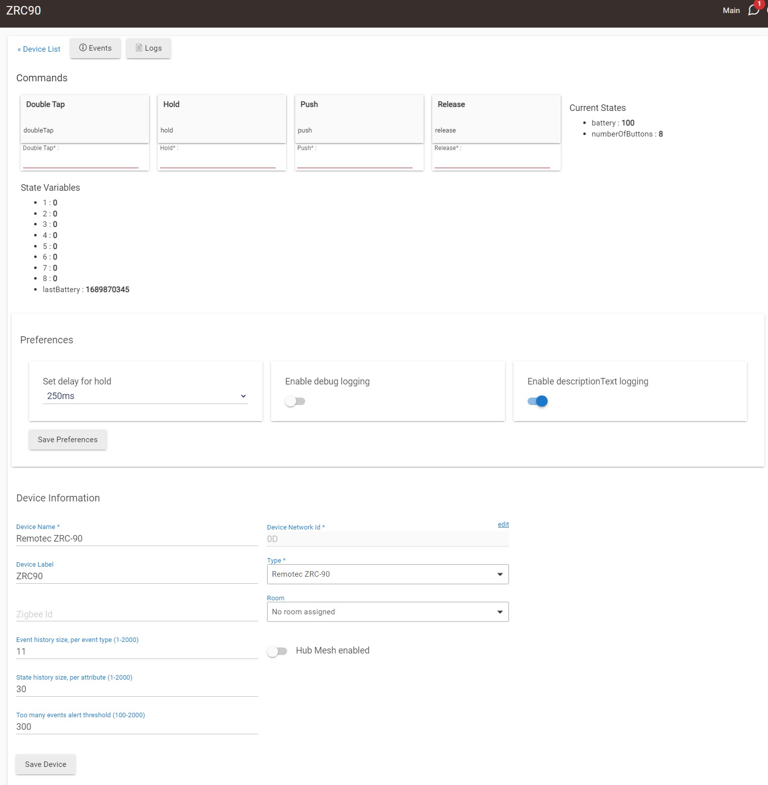

I'm not sure where I'd find that info. It's added by HE as a Remotec ZRC-90. I don't see anything on the device details page about a driver.
It is on the device page.
Nothing labeled driver on that page:
The dropdown labeled Type is the driver. Looks like the correct driver is selected. Next thing to do is to check if button pushes are registered as events.
Can you push each button in succession, and then screenshot the EVENTS tab on the driver page (Events is found near the top of the device page).
Post that screenshot

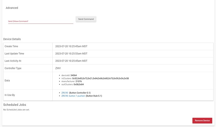

Edit: Also, here's what the info under device Data looks like after a successful pairing:
  • deviceId: 34064
  • inClusters: 0x5E,0x85,0x72,0x21,0x84,0x86,0x80,0x73,0x59,0x5A,0x5B
  • manufacturer: 21076
  • outClusters: 0x5B,0x84
  • zwNNUR: 1
  • zwWakeupInterval: 0
This is what the log looks like when the ZRC-90 is communicating correctly; there is one debug line that doesn't change (what I was seeing before), but two others that do change and and info line describing the button push.
