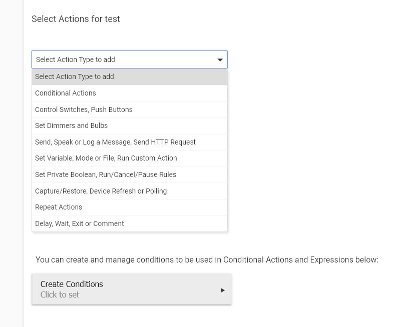

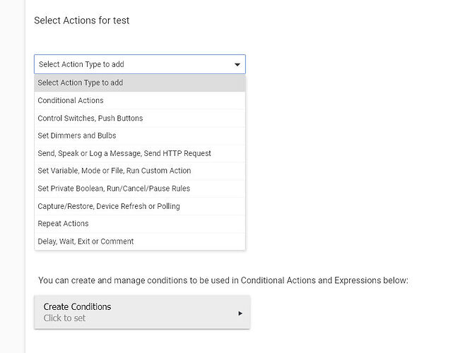

I've created a test app in both Basic Rules and Rule Machine 5.1 to send an email notification when a button is pushed. In Basic Rules (1st pic below), everything works fine. When I try to do the same thing in Rule Machine 5.1, there is no "Send Notification" selection in the actions box (pic #2). What am I doing wrong?
It's under Send, Speak or Log a Message...
Handy tip: the Rule 5.1 docs (and prior versions too) contain a list of actions by type at the end. :smiley: This can be helpful when you're trying find something without needing to dig through the menus each time, though you do get used to that, too. :slight_smile:
https://docs.hubitat.com/index.php?title=Rule-5.1#List_of_Actions
