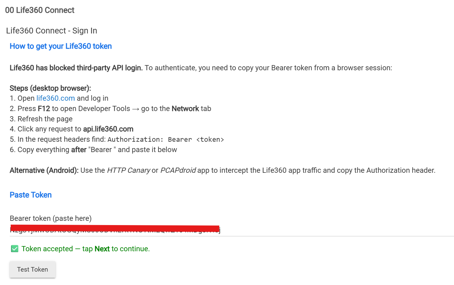

I can't remember exactly what I did, but I've been testing a version for a month or so now and it has not died on me yet - the same Bearer token has been working for me, even after a accidental uninstall then install again.
As I made too many changes, and there are still some issues, including, still trying to get an accurate journey log, I will PM you a modified version of your code with just changes to the authentication method for your review.

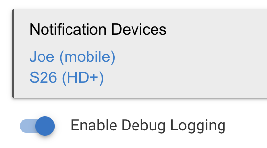

I had pushed the changes I was testing with as long as 1 more really small but hopefully useful one -- the app will notify my phone when the token expires.. just makes detection a little faster :slight_smile:
add device notification when token expires
that's pretty handy for sure.

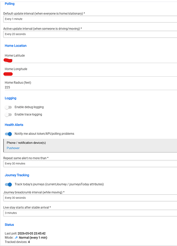

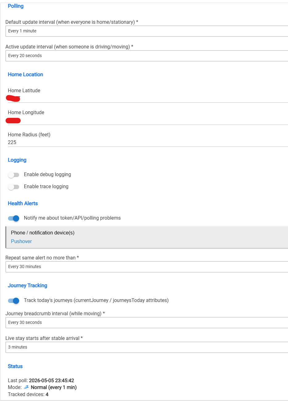

@jpage4500, I have been running your latest version with my original access token created around 20th March 2026 (still working :smile:)... will keep your version with one member running alongside my version with 4 members.

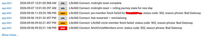

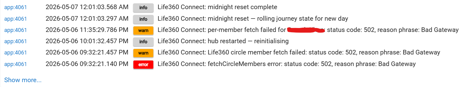

Hopefully - running two versions will not have any adverse affects, I have recently seen some errors, see below - everything is still working fine.

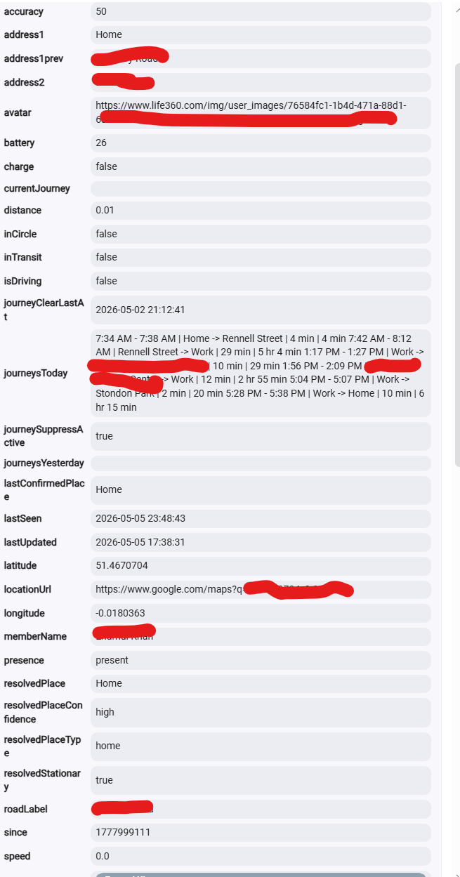

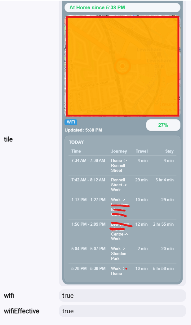

Life360 Connect - testing since 20th March 2026

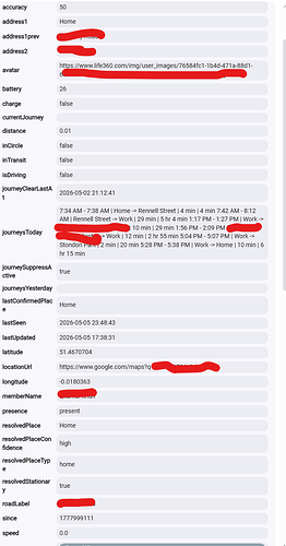

I am still trying to get the journey log working as best as possible:
My Hubitat is using the same token as my HomeAssistant, so we'll see what happens... :grin:

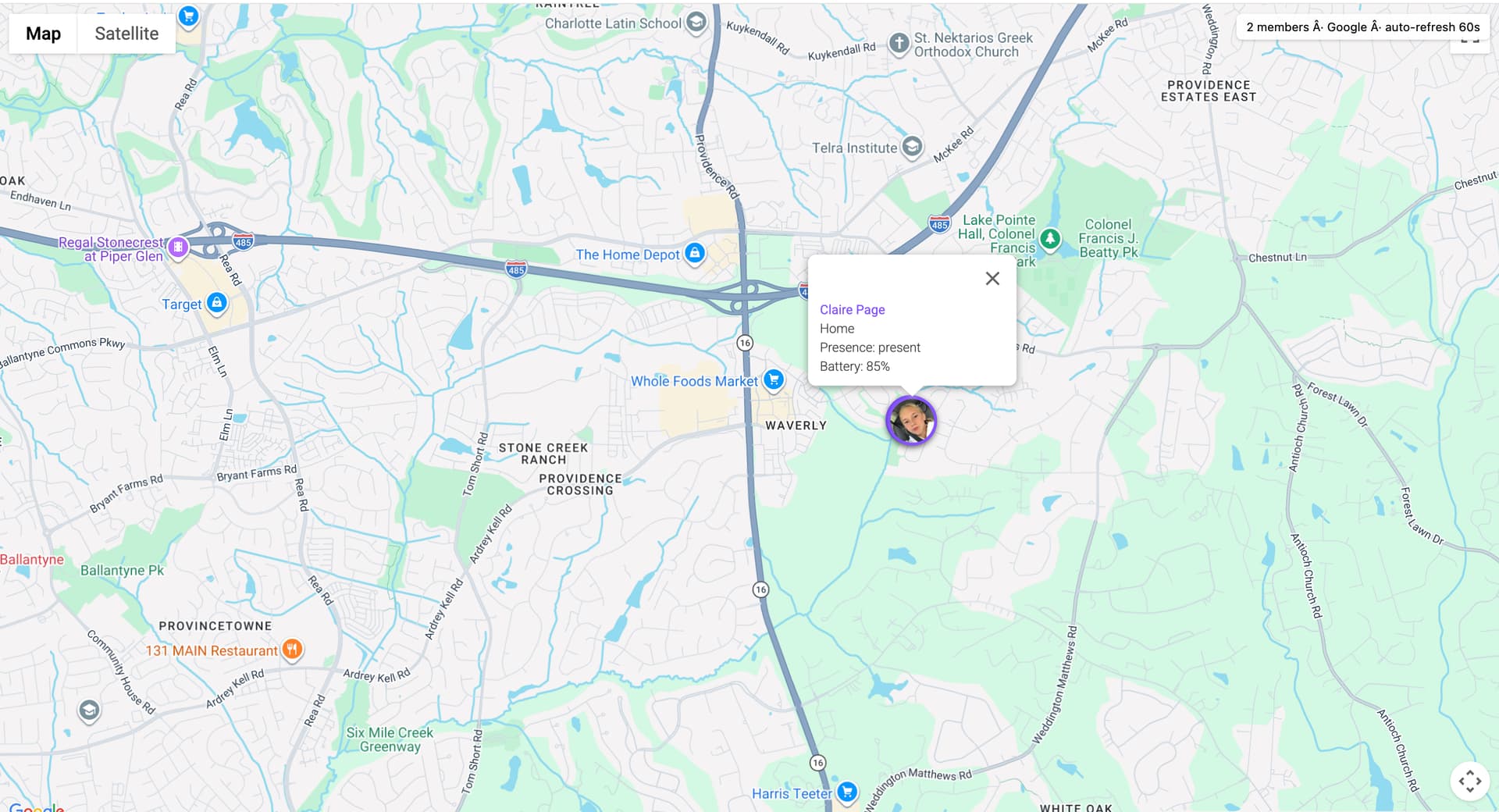

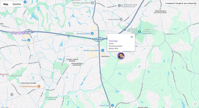

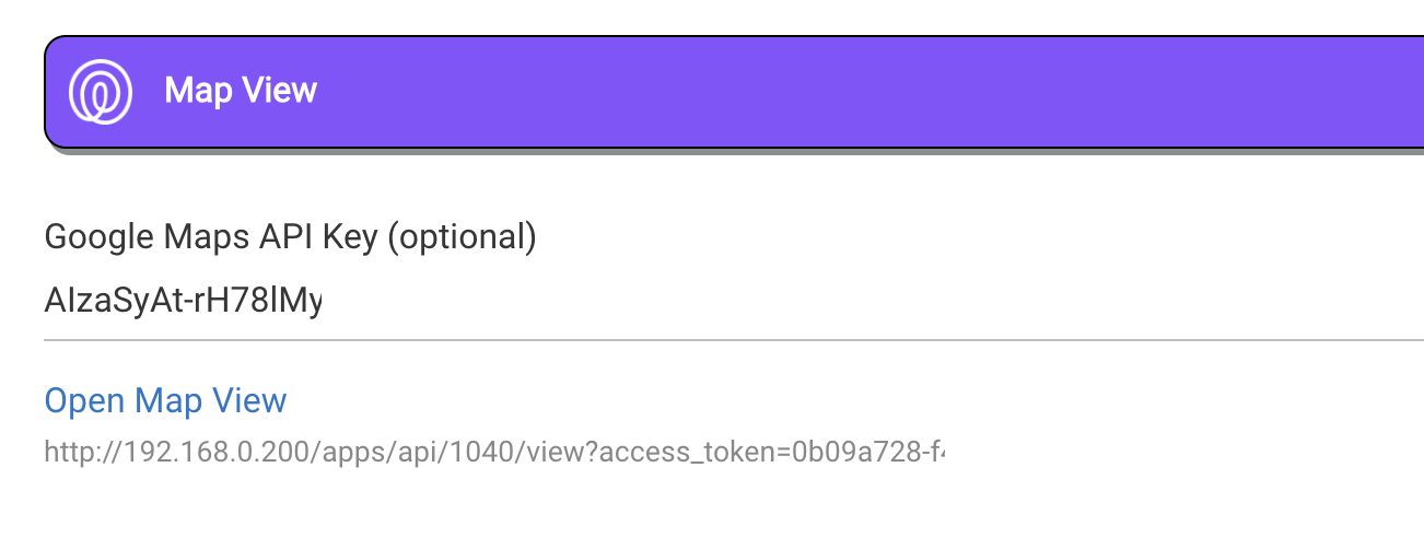

  • add /view endpoint to view life360 members on map (either google w/API key or openstreetmap)
Fun little extra for anyone who wished Life360 had a web view..
I added a new section called Map View -- there's a field for a google maps API key but it's optional and a "Generate Map Link" button. Click the button and a URL will show up that you can bookmark -- it'll show all of the Life360 members on a full screen map (google maps if you set a key otherwise OpenStreetMap)
Google Maps is more detailed and getting a Maps API key is free -- just requires a little setup work.. make sure you lock it down as well so you can't get charged. I have a guide on how to do this here
