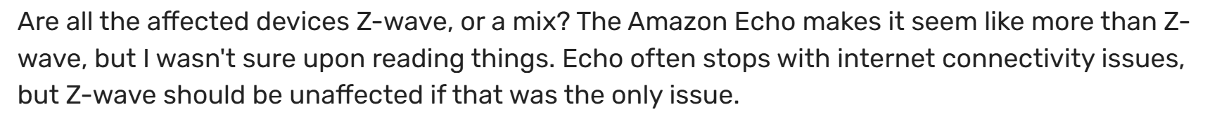

Are all the affected devices Z-wave, or a mix? The Amazon Echo makes it seem like more than Z-wave, but I wasn't sure upon reading things. Echo often stops with internet connectivity issues, but Z-wave should be unaffected if that was the only issue.

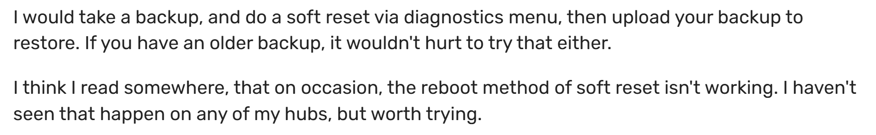

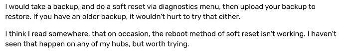

I would take a backup, and do a soft reset via diagnostics menu, then upload your backup to restore. If you have an older backup, it wouldn't hurt to try that either.
I think I read somewhere, that on occasion, the reboot method of soft reset isn't working. I haven't seen that happen on any of my hubs, but worth trying.

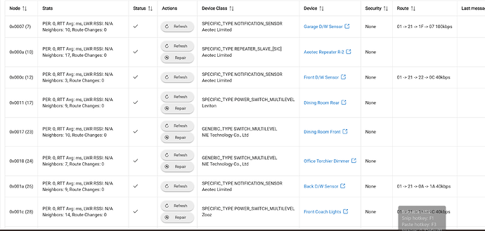

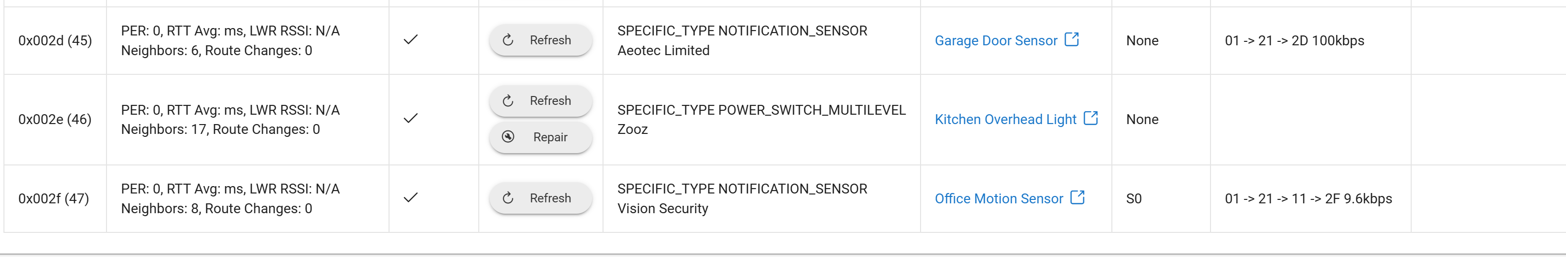

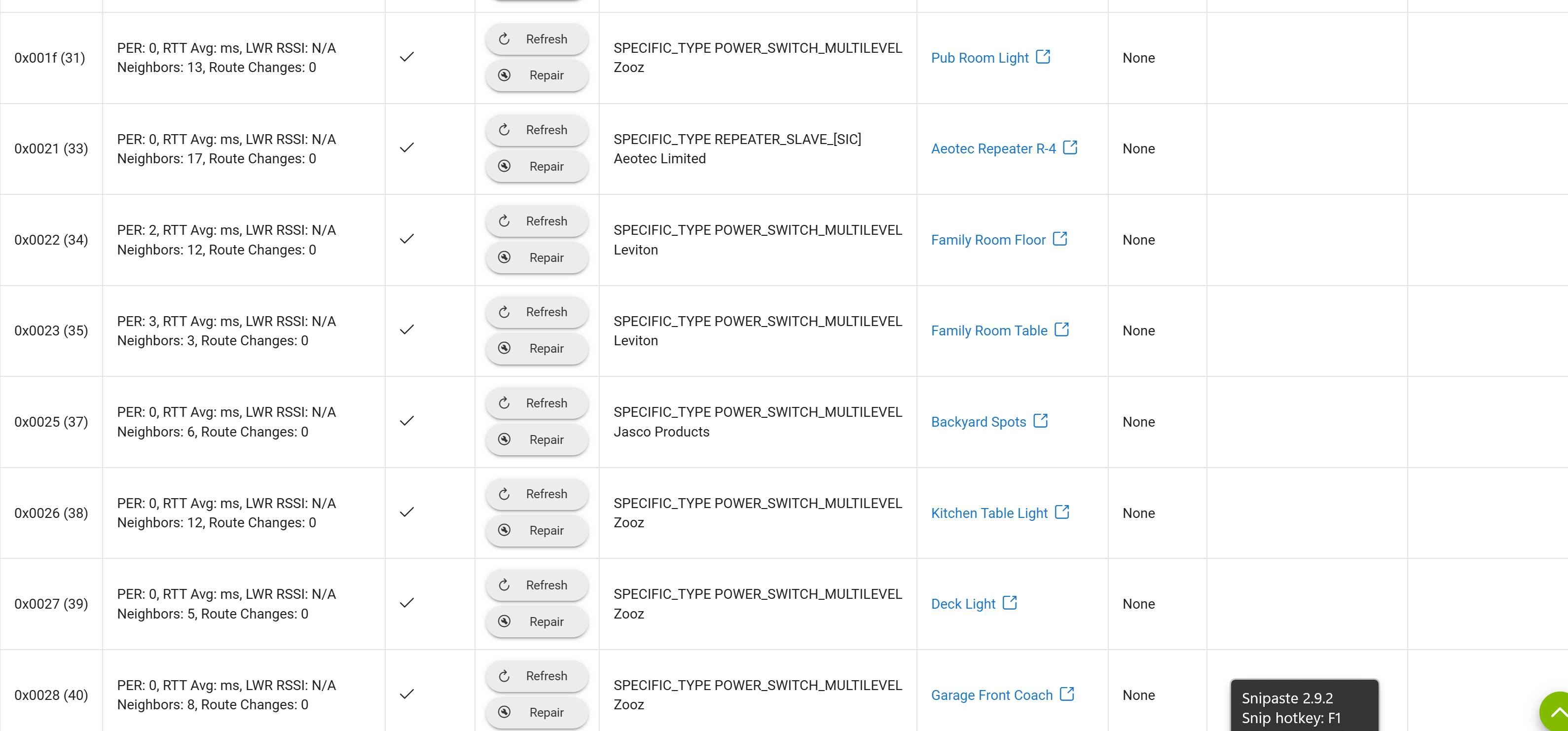

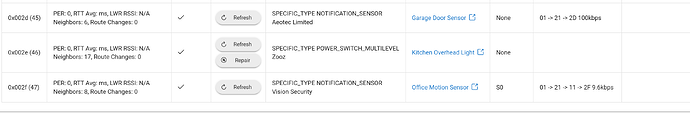

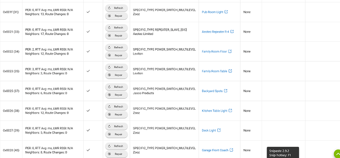

I did just try an older backup. A couple of months old. It restored fine, but the issue remained the same. The hub will not control the devices, despite the hub management UI working. Screenshots of zwave details here:
The Z-wave table doesn't look right, very few routes, no RSSI, no Last Message.
This is above what I can diagnose, maybe @bobbyD will be able to look at it.
