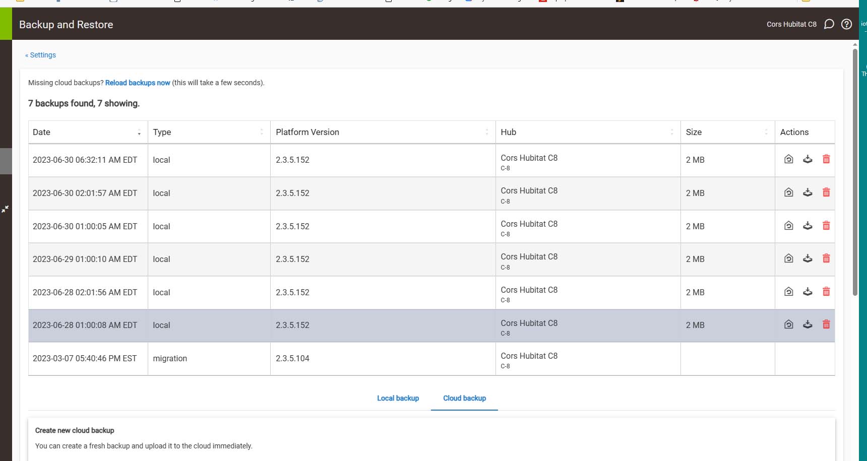

Way ahead of you. While backing up, it spins for a few minutes. No errors or any messages. I click on Reload backups followed by Show All and nothing changes. Just the 7 Local and 1 Migration backups appear
Very weird, tagging @support_team
Before and after (creating new cloud backup)

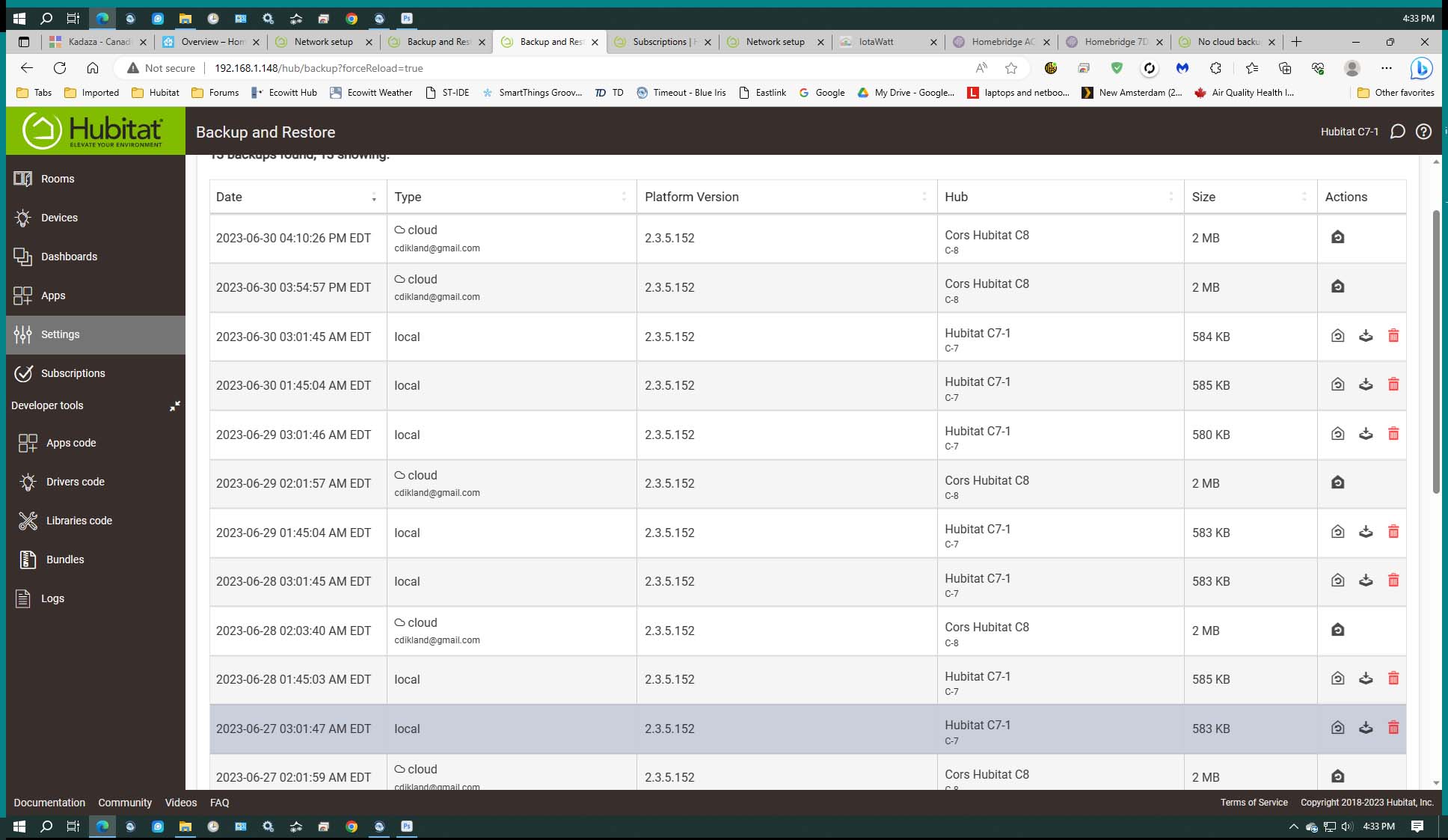

Ok, it gets a whole lot weirder. Here is a screen shot of my old C7 which does not have a subscription. The cloud backups, including the 2 I just created trying to figure what was going on, show up under backup/restore of this old hub. Note that the local backup have the correct hub name but the cloud are that of the C8
Definitely strange. I assume you're on the latest platform on the c8?
Have you tried rebooting the C8? Looks like the backups are created. The fact that they don't show on C8 is some kind of UI glitch. Will look into it. Also, can you try connecting to C8 from an incognito session?
