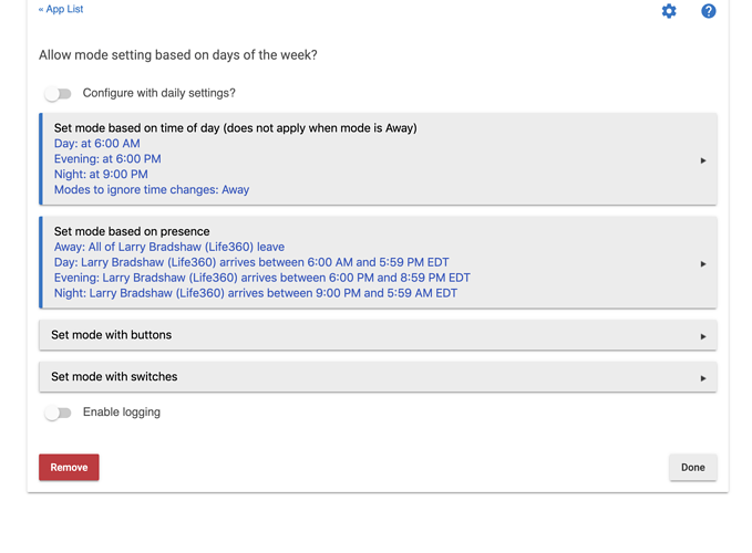

Here's a snapshot of mine for reference.

Ok, I see the problem. You need to have the mode based on presence match your time settings in mode based on time of day. Since you don't have the time settings in there, it's defaulting to the first mode that matches the condition (Day mode, since it is first).
If you look at mine, I have specified times for when presence changes from AWAY to what mode it should be set to.
You have specified when the mode changes if you are home, but not when you return home. If that makes sense.

Change the x:59 to the next hour. The reason being (and I fell victim to this too) is that if you happen to arrive at 5:59 PM, the mode will get messed up. Beyond that, you should be golden!
