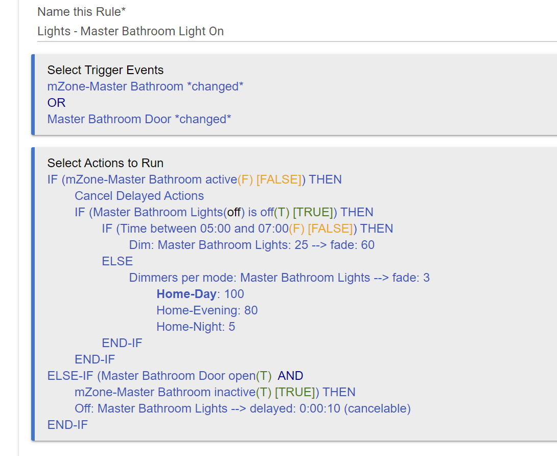

Here's how I do something similar in my master bathroom (though instead of a door opening, you'll trigger on the LED changing/other lights being turned on).

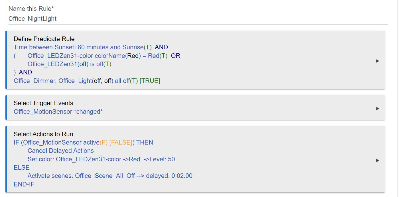

ok i think i have it now!
So I still have one problem. If the motion goes inactive....it starts the timer delay. If i turn on Office_LEDZen31 while that is ticking down...it still turns it back off.
  1. I think you need a 2nd trigger and IF statement to handle the other lights being turned on. That 2nd IF needs to cancel the delayed action. Same as my bathroom door being closed in my code.
  2. You’ll also have to then update the predicate so the rule will still fire when those lights are on.

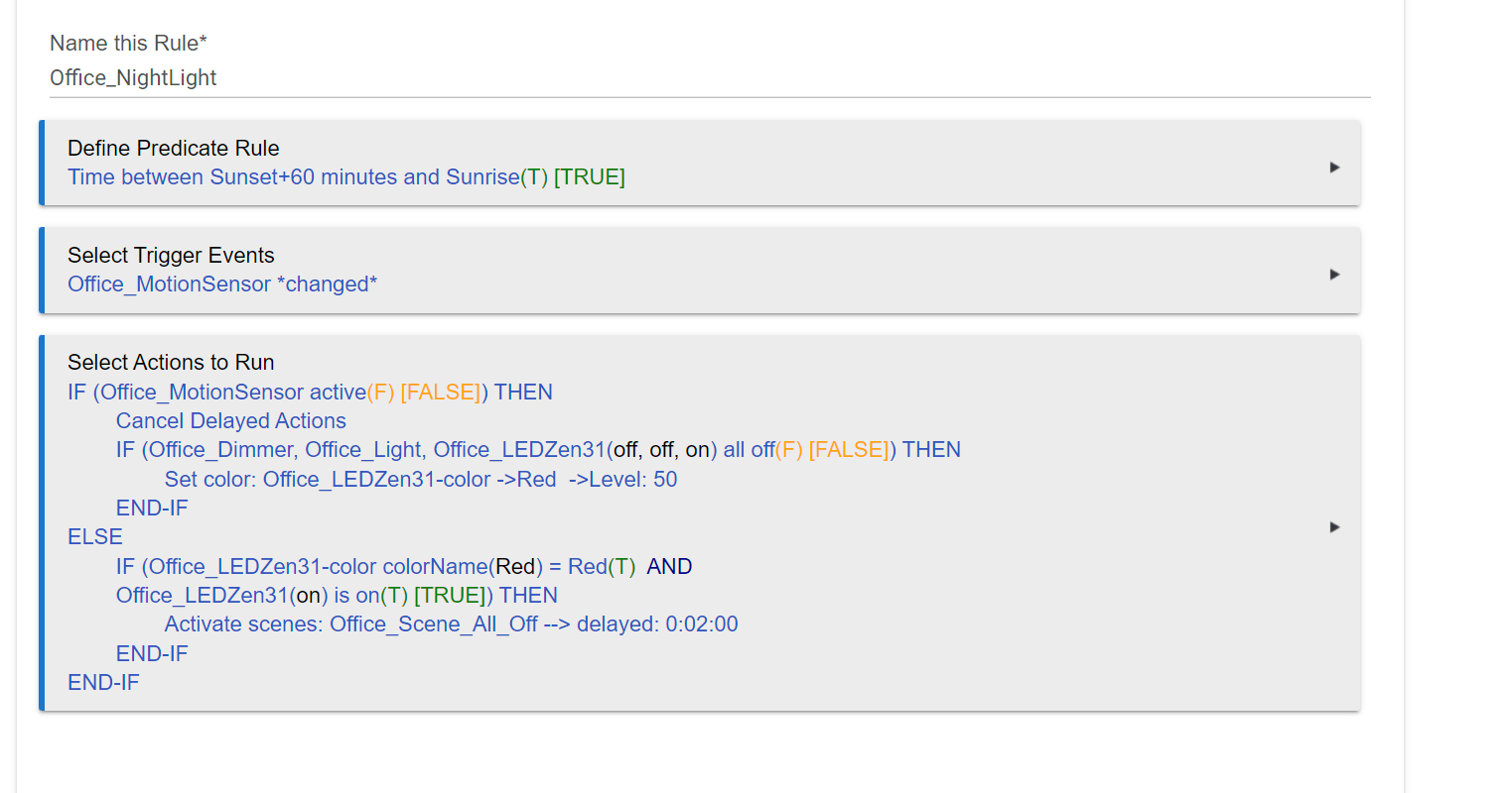

Ok NOW i think i really have it. It was even more simple when I really thought i through. What sucks is that the only reason I cannot do this with "Motion Lighting" is because it cant do anything with color properly.
That looks clean. It does require motion to trigger though, e.g., if you turn on office_light from your phone (or Alexa) it won’t trigger and the timer will still expire.
Minor thing, but you can use a single IF-THEN statement instead of two separate ones (it’s in the drop down instead of a button).
