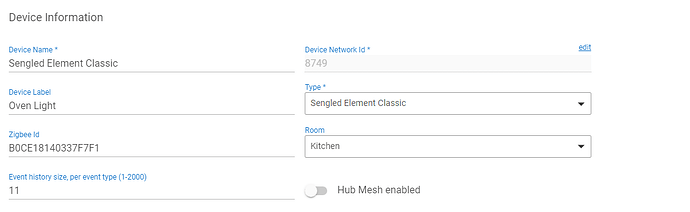

What driver are you using for these bulbs? (This is the "Type" dropdown on the device detail page.)
