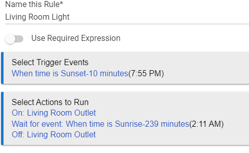

I created my first three rules. Two of them do not turn the light off. The light turns on but never turns off. The third rule works. Any help will be appreciated.
This one does not turn the light off.

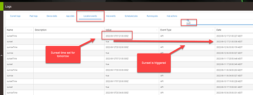

In addition to the logs from your rules, you may also want to look through the Location Events for your hub, also available from the Logs page. It will show you when the sunset and sunrise are triggered and when they are set for the next day.

Rules is:

When I broke the rule up into two. One for "on" and the other for "off" it worked.
Is there anything special about the "wait event"?
Odd - both should have worked. The wait event will get cancelled by the rule running again, but this shouldn’t happen in your case as the trigger is a time event…
