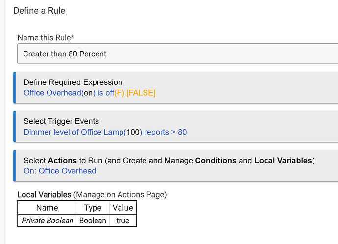

It might be easiest to break this up into two separate Rule Machine rules for now.
Here is an example that I just created to get you started. The following rule will be triggered by my "Office Lamp" having a dimmer level above 80%. The Required Expression will only allow the actions of this rule to run if the "Office Overhead" light is "Off". If both conditions are met, then the "Office Overhead" light is turned on.
You could then create a second rule that reverses the logic to handle turning off the light when the level of your dimmer drops <= to 80.
Note: I have not fully tested this rule, so some tweaks may be required to get the desired behavior under all circumstances.

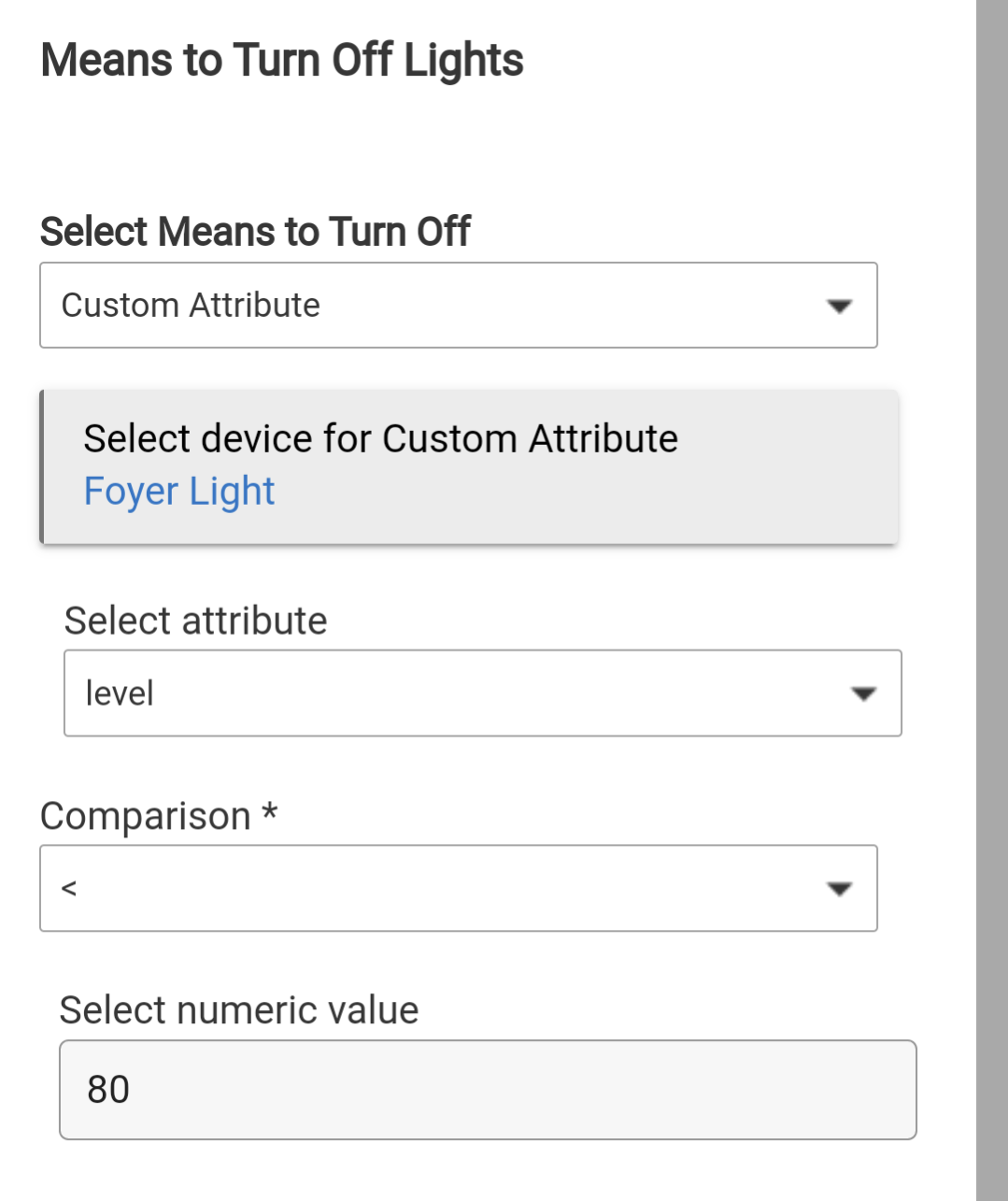

Can also be done in Room Lighting.

Maybe not simple per se, but this should be an easy fix. It was something I didn't think about with my recommendation.
When a dimmer is just turned off, the 'level' value does not change. So just using the level would result in what you are seeing. If you dim the down lights, then the level will change and turn off the other. If you just turn the down lights off, the level doesn't change so your other light doesn't turn off.
The easy fix, add an additional 'means to turn off' for the down light switches being turned off.
