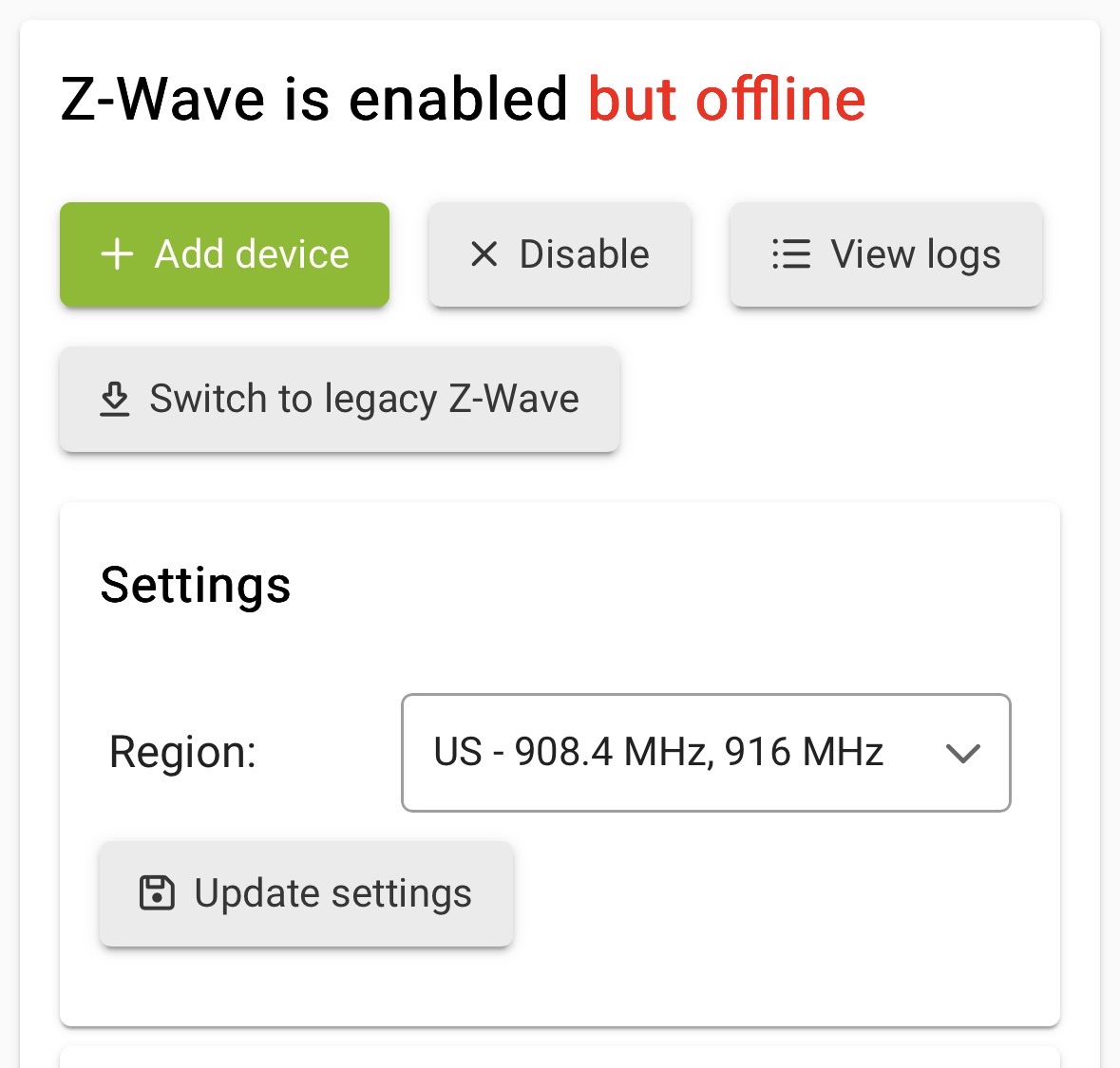

My zwave after the FW update.
Shutdown - unplug - reboot = same result.
Yes it a C8 pro.
Can you please send us your hub ID @support_team team
Sorry for the delay
Hub ID sent
