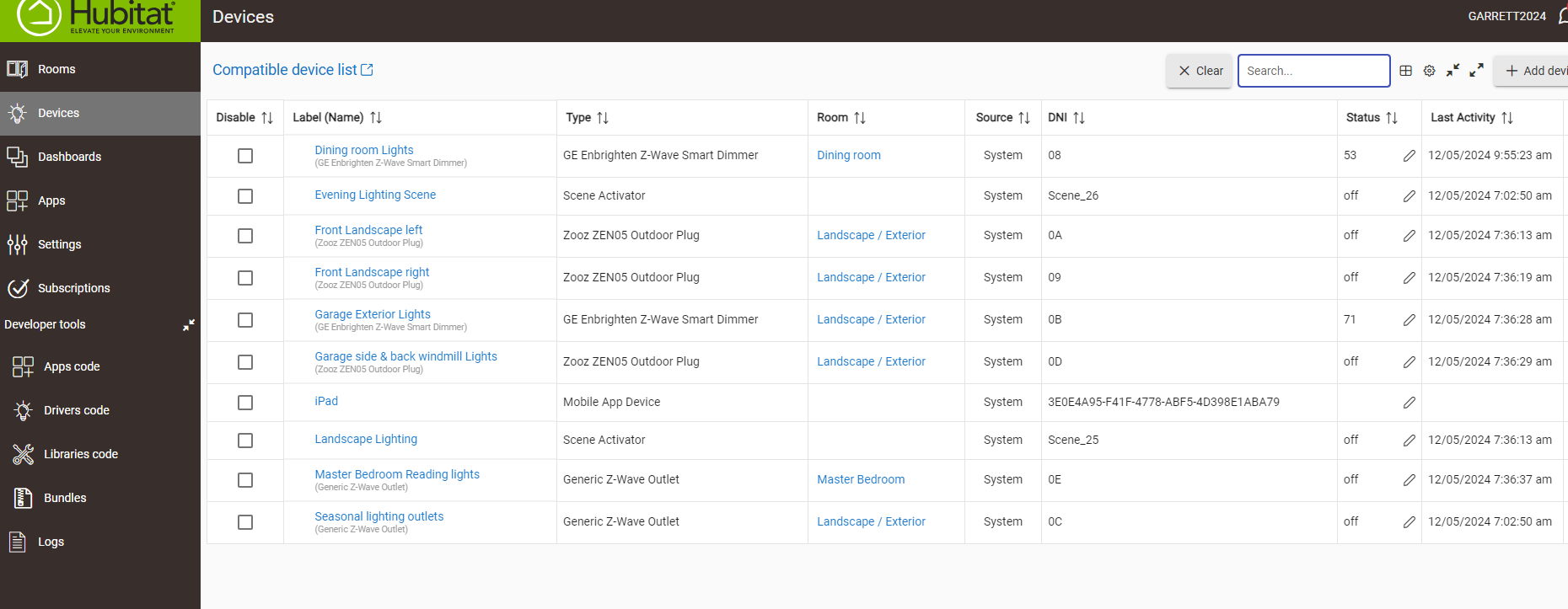

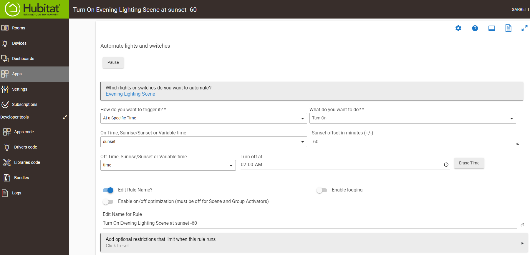

Up and running with Hubitat however I must be doing something wrong. Goal is to activate two scenes by time (simple rule) and button on dashboard,

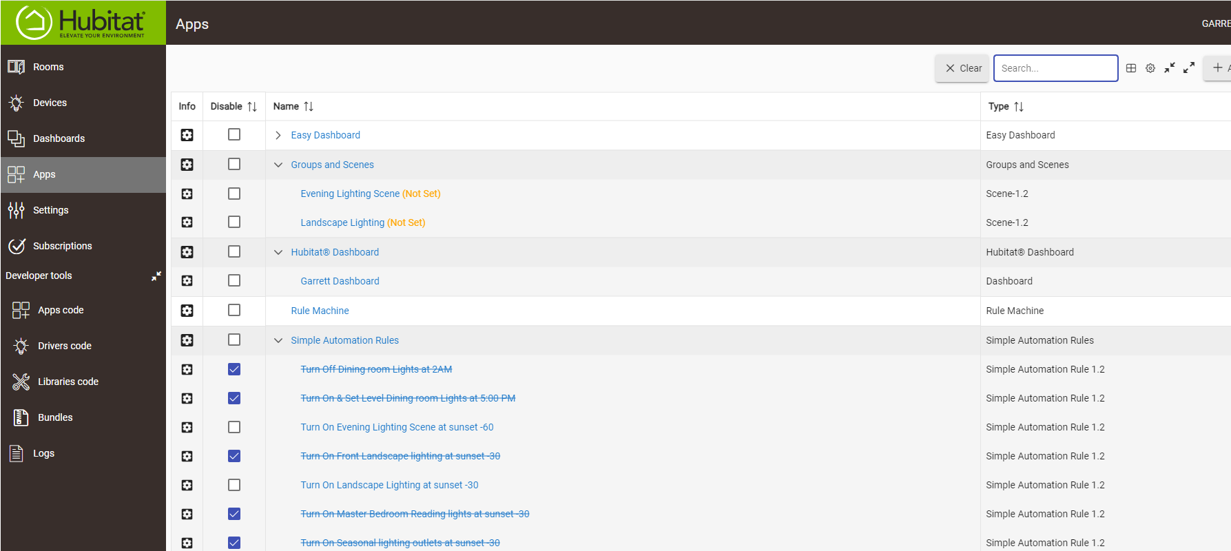

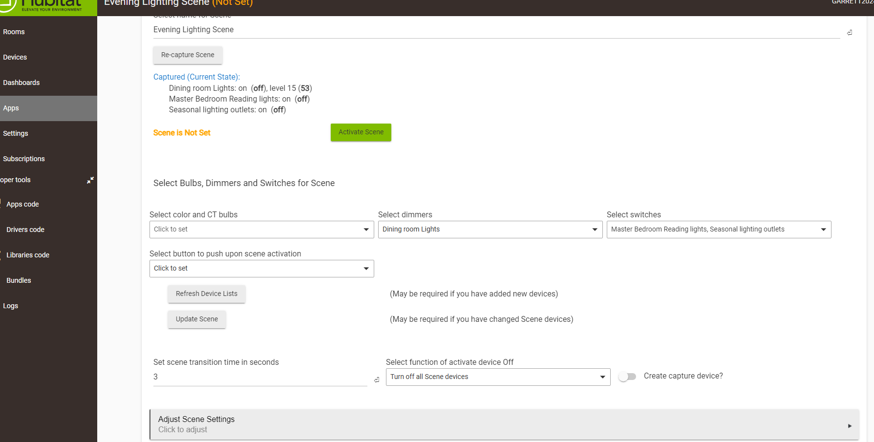

#1 why do both scenes show "not set" after I've successfully captured both several times? Are my setting correct?

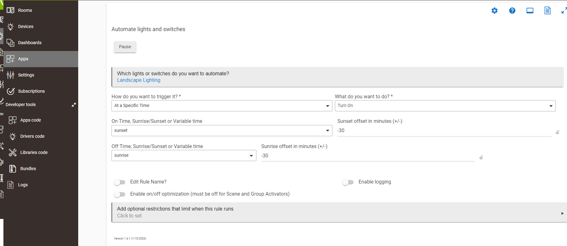

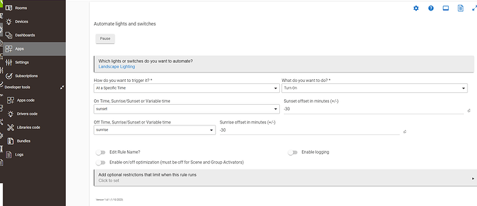

#2. Scenes come on and shut off at 2AM on the evening scene but the landscape scene is on longer than sunrise. I tried 60 and 30 offset then switched to -60 and -30... Goal is "off" at 30 minutes before sunrise What am I doing wrong?

I'm pretty sure this just means that the scene is not on. Does your app page say "On" next to the scene when its activated?
You would want -30 in the offset to indicate 30 minutes before sunrise. Positive numbers add time; negative numbers subtract time is how I keep it in my head.
Thanks for the quick reply, No it says "off". Still confusing to me, but as long as it held the scene settings originally captured, that's all that really matters. I'll leave it at that for now.
I'll adjust the simple rule to -60 to see if the lights shut off before it is daylight ...
What happens when you click the Green activate box in the first screenshot? Does it set the lights accordingly and change it to "Scene is On"? Personally, I use Room Lighting which can combine both Groups/Scenes and Simple Rules into one app.
It works, Green "activate scene" turns scene on properly, and yellow "turn scene off" shuts it off properly.

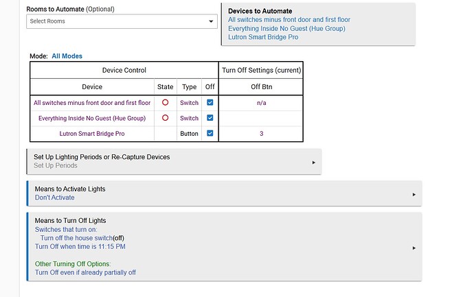

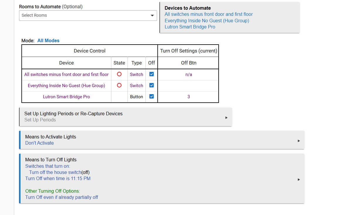

As for an all off RL, this is what I use:
At 11:15pm or if I flip a virtual switch (again dashboard or voice assistant), everything in my house shuts down.
