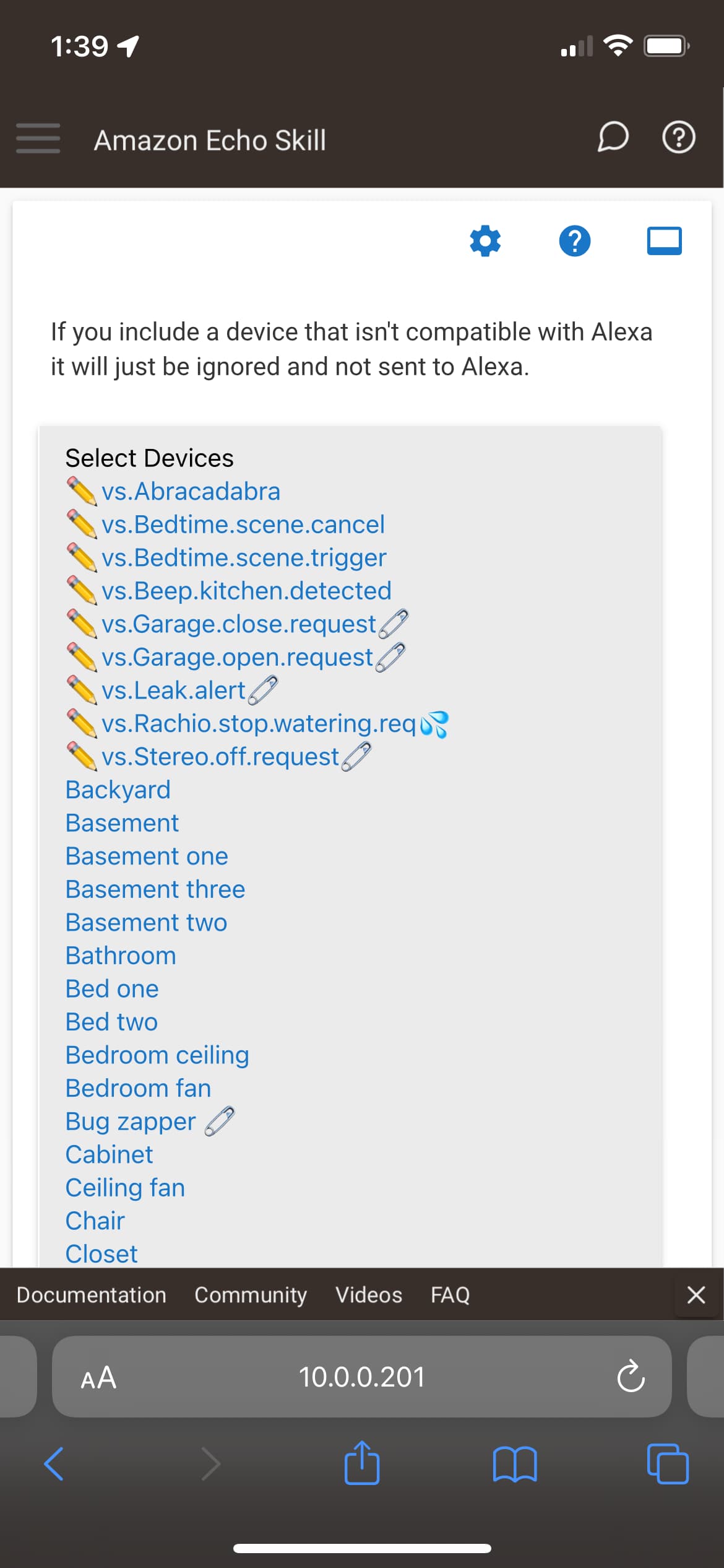

You do have the Amazon Echo Skill installed on Hubitat and linked to your Alexa account.
But you do not see your devices in the drop down menu to select them?
Not showing up as compatible or incompatible

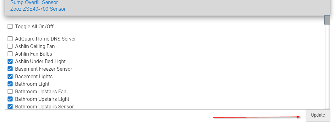

After opening the device selection menu hit the Update button at the bottom to refresh the list with current devices. Is not always needed but I think it forces it to reload the list of devices.
