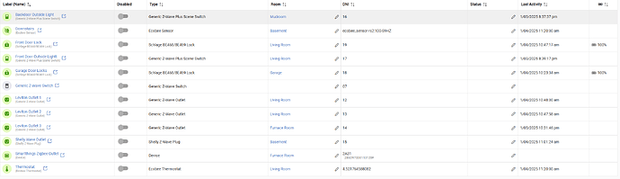

I'm an extremely novice user who is in the process of switching over from Smartthings.
I purchased a C8 hub and am running it wired into my router.
I updated it upon startup. Version 2.4.0.145
I added most of my devices (zwave smart plugs and several zwave light switches)
I had some issues pairing my Schlage connect locks and like an idiot turned off the power then turned it back on. I all of my devices however there were ghost devices in the Zwave settings.
Following instructions on here I attempted to discover them which failed in all cases I then removed them. I then factory reset them and readded them.
I have 2 remaining issues:

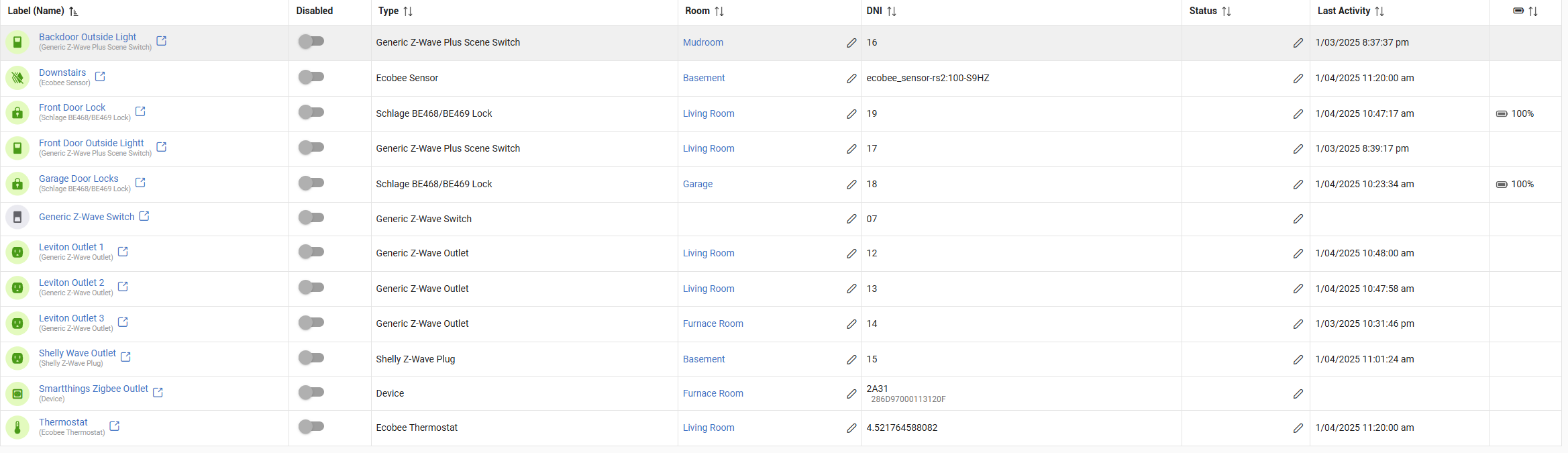

a. 1 zwave item on the device page that I am unsure what it is and does not respond
b. 2 listings in the zwave settings that are not tied to devices that I can not seem to do anything with (discover/remove)

You have one that is ready to remove (11), and another one that I would try to remove (10).

Sadly the remove button does not remove the node. I have done hub power down, wait and power up and then tried again however its still there.
The other one I have refreshed multiple times but remove never appears.
