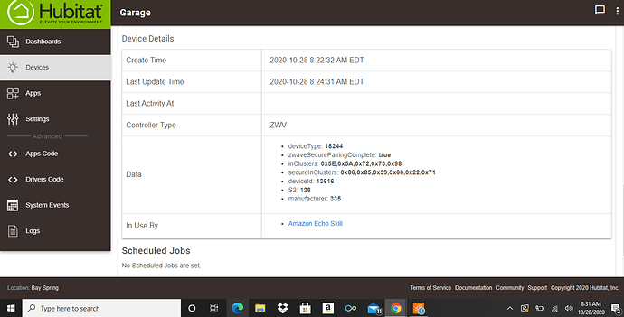

It worked yesterday, now its broken again this morning. I have excluded it and included in 3 times already. Same result. here is the screenshot!
Hopefully thats what you wanted
I was just able to open and close it in the command box. But still nothing from inside the dashboard.

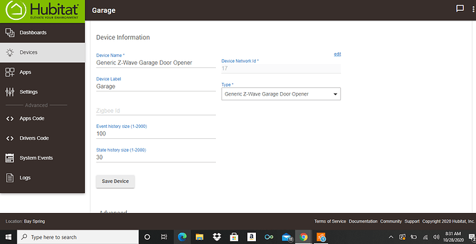

I don't use Dashboards, so I should let someone else (@neonturbo, @TechMedX) answer this. However, I recall there are two different dashboard templates for garage door tiles. Make sure you use a template that permits door control.
Yeah I did the garage(control) template and it worked for a few hours. Woke up this morning and nada. When I go into the devices menu I am able to open and close the door and the current status changes correctly. I have read that maybe its because the hub is far away. I'm on the second floor and the garage is directly below me. Also I have 3 z-wave devices within 3-5 feet of it.

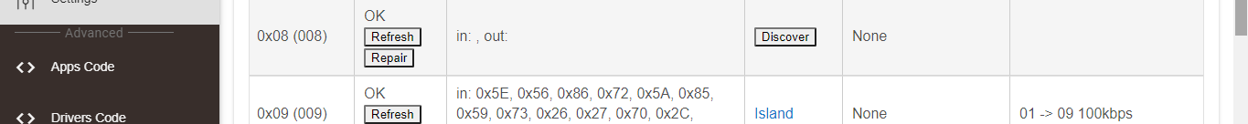

I really would not advise that. I would advise making sure you have no ghost z-wave devices. Run a repair to the GDO.

That could also be an issue. How long has that device been there? I heard something about ghost devices being removed during nightly maintenance, but then there was talk of that not working. This could be part of remnant z-wave issues @aaiyar mentioned above. I have not migrated z-wave over to my C7 yet, so not sure I can be of much help there.
ive had issues with the same ver 8 garage door opener as well , it is very picky what it uses as a repeater and will not use the switches i have in the garage but will use ge wall switches etc.. try getting maybe a ring or aeon v7 repeater and putting in the garage.
Did some work and the ghost is now gone. I went back and hooked the garage door back into hubitat and voila back in business. Thanks for all the help guys. Sorry if i am annoying, Promised the Mrs. this would be a easy transition. For the most part it has been. Just a few hiccups
