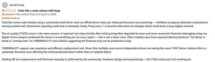

Amazon did publish my review:

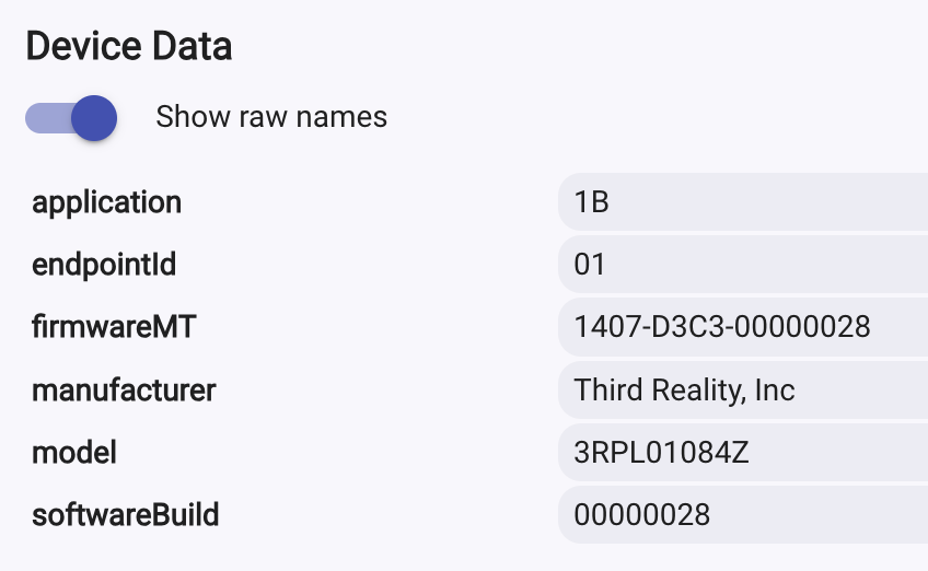

00000028 translates to 1.00.40, which is not mentioned on their website…
No, the system driver does show a FW update button. I’m not sure it works…
EDIT: I just checked a minute after I wrote this, the system driver update worked!
I can’t get it to update using the built-in driver. What’s your secret?
I was running my own driver for the R3 (it’s in a link above in this thread). I changed the Type to “DEVICE” and used the Command tab to clear everything clearable. I then switched the Type to the system R3 driver, saved, and clicked on the Update Firmware command. At that point, walk away for 30-60 minutes. Refresh your browser and look at the softwareBuild version, the system driver reports “00000028“ for the latest version. Then, if desired, revert the Type to whatever R3 driver you want.
