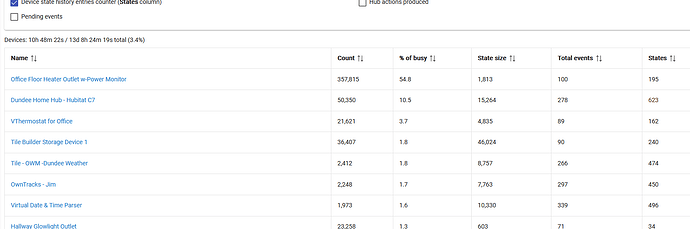

Got a message today - Hub load elevated. I use a 'Third Reality Power Monitoring Plug' driver from HPM - I see others have switched to generic outlet. Does it also report power?
I use "Generic Zigbee Outlet" and have no issues with it. I use it to monitor power for my washing machine, along with a couple other plugs for other items.
Same here.
I have a Third Reality Smart Plug Gen 2 w/Power Reporting using the Tuya Zigbee Metering Plug driver without any issues
