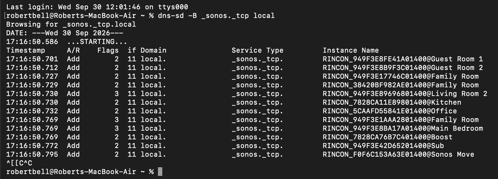

I connected a Mac by Ethernet to the same LAN and used an mDNS browser. All 12 devices advertise sonos._tcp and appear in the list (for example, RINCON_…@Family Room, @Kitchen, @Boost). So, the speakers advertise correctly on the wired network, and the hub still finds none.

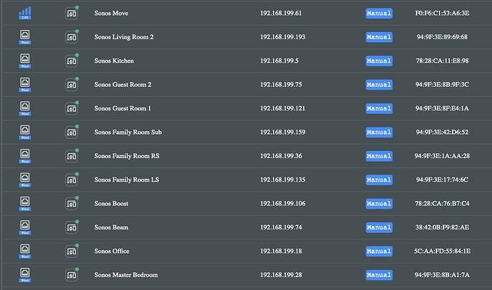

This is a snippet of the device list in my router.

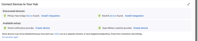

  • The hub's Connect Devices panel finds a Hue bridge and a Reolink device, so mDNS discovery works in general, just not for Sonos.

This dns-sd -B _sonos._tcp local from the unmanaged switch that the Hubitat hub and the Sonos Boost are plugged into. The earlier test I was connected to the primary router.
The lack of any airplay is also telling, most if not all of your Sonos players should also have airplay listings
If possible I would move your hub even if only temporarily to a different switch or try WiFi temporarily
Something's blocking mDNS at the hubs port or upstream from it

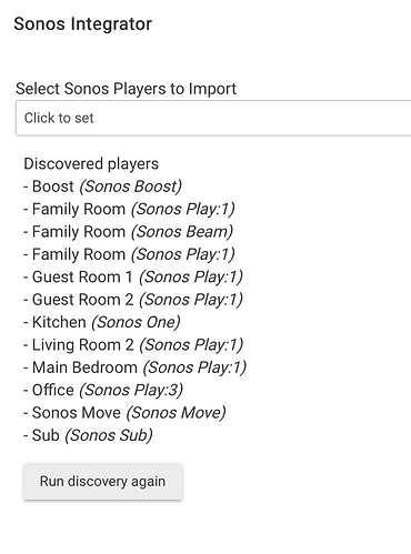

Thinking about this more, I had the legacy integration installed when I installed and ran the new integration. That generated errors which ultimately led me to delete the legacy integration and rebuild my Sonos infrastructure. Just now took a long shot and deleted the new integration then rebooted the hub and re-installed the new integration and ran discovery. All devices were discovered. Supposed something got hosed up with both the integrations running/colliding. Thanks for looking at it!
