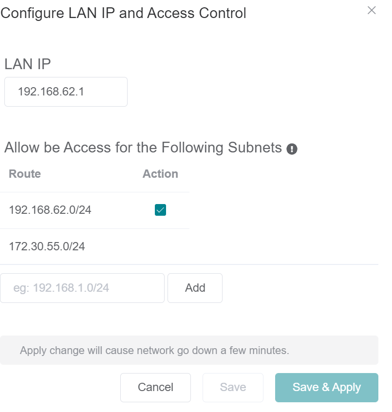

Here is the error I get trying to add the subnets. Subnets are the problem I believe. My site to site network at each location the HE is on 192.168.1.X and the site to site is on 192.168.X.X at each location.

If I havenโ€™t mistyped the subnets, this should work for you:
http://192.168.155.130/hub/allowSubnets?192.168.1.0,192.168.8.0,192.168.29.0,192.168.40.0,192.168.62.0,192.168.169.0
This is what I am getting even with the allowed subnets.
