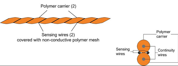

Those only sense water at the probe at the end of the cable, a sense cable like used on the Shelly Flood Gen4 and Sinope flood sensors, detect water anywhere on the total length of the cable. They are made of a spiral plastique with 2 grooves that go around on all the length, then bares wires are placed inside those 2 grooves so that when water makes contact anywhere between the 2 wires it triggers a sense.
These type of sensors are especially nice to use around a water heater, under a dish washer on it's perimeter, can be attached under a length of pipe to detect a leak (a pipe that could freeze and burst if it does), etc. Also nice that since you usually place around a perimeter, even if the surface is not level, wherever it is it will be in the path of the water.
