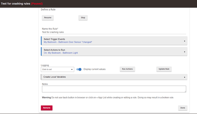

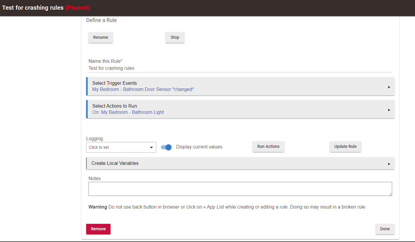

Similar issue here - I am glad I had a backup for each of my rules though.
This morning after the upgrade they were crashing a lot so I kept cloning them and then once I renamed my mobile phone then any new or existing rules containing it got affected.
I've posted this earlier as well so hopefully HE support get involved soon - Here's the error message anyway:
I am able to create and modify rules successfully though:
