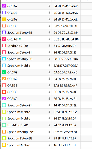

i wish someone would sue spectrum.. it is very unfriendly to leave their damn routers in setup mode thus tying up many of the wifi channels.. They could easily disable it after a setup amount of time..

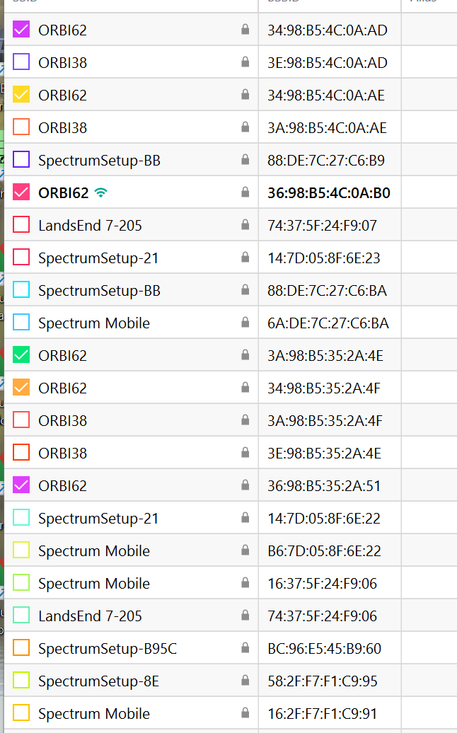

I suspect it's actually just people around you who never changed the default SSID when they set up their networks.
Sorta like how you left yours at the factory defaults of ORBI38 and ORBI62... ![]()

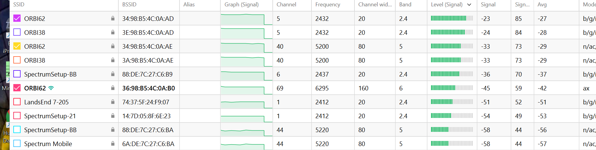

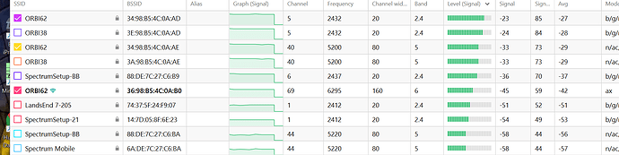

WiFi performance is largely dependent of carrier to interference margin (C/I). With the push to higher and higher data rates more complex modulation methods are used like 64 and 256 QAM which require more margin. So the presence of cochannel interference (your neighbors) and the larger margin required for high order modulation really makes it a tough dance. All you can really do is optimize your AP to device path and hope it has enough margin to reject your neighbors.
If the Orbi entries at the top are yours you should probably change the channel from 5 to either 1, 6, or 11. Those are the only channels you can ensure to atelast attempt to prevent overlapp on 2.4ghz. If you have two seperate devices i would also suggest using two different channels unless there is something with the mesthing on orbi that requires them to be the same. Otherwise they will potentially cause interference for each other. If anything is possible the best optionw oudl be to ask folks around you to see if they canturn down the transmit power of their routers. In many cases it is set too high, doesn't really help the communication much since the transmit power from the client is also important, and is just a good neighbor thing. If that is possible it reduces the range the AP screams the SSID and reduces interference.
As @a.mcdear suggested above those Spectrum SSID's are the default SSID's used during install. The customer may choose to use that or change it themselves. They are uniqe because along with the SpectrumSetup it also uses some randomized charecters. I would need to check what happened at my moms condo to be sure.

That’s not the case here in my area. I helped a neighbor with a technical issue who has spectrum and his SSID was spectrumsetup… and that was printed on the bottom of his router as well. Could have been a particular batch of equipment setup that way. So those SSIDs are legit ones being used by your neighbors not temporary setup ones.

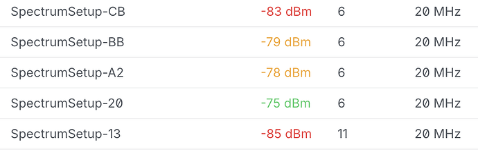

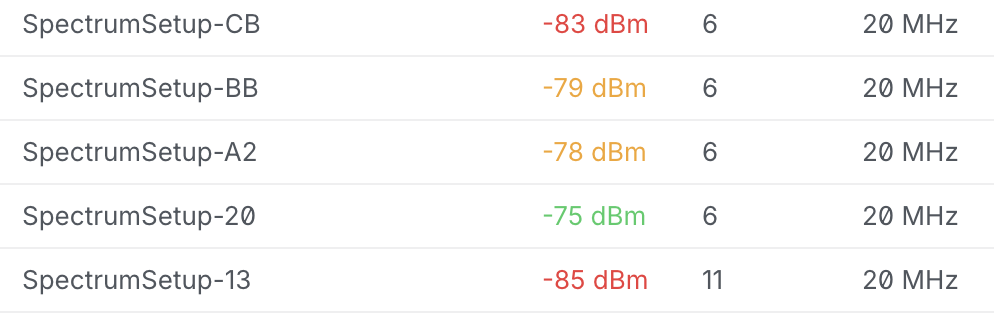

I run Unifi equipment at my home and live at the end of a culdesac so have many nearby neighbors. I just looked at its "Wifi Analyzer" and I see 5 Spectrum SetupXXXX SSIDs so again its not just your current location, equipment from Spectrum of a certain vintage defaults to this SSID.
As I said above it is also printed on the bottom of the router as well so my neighbors must have the same thought process of convenience and just using what is default and printed on the bottom of the router.
