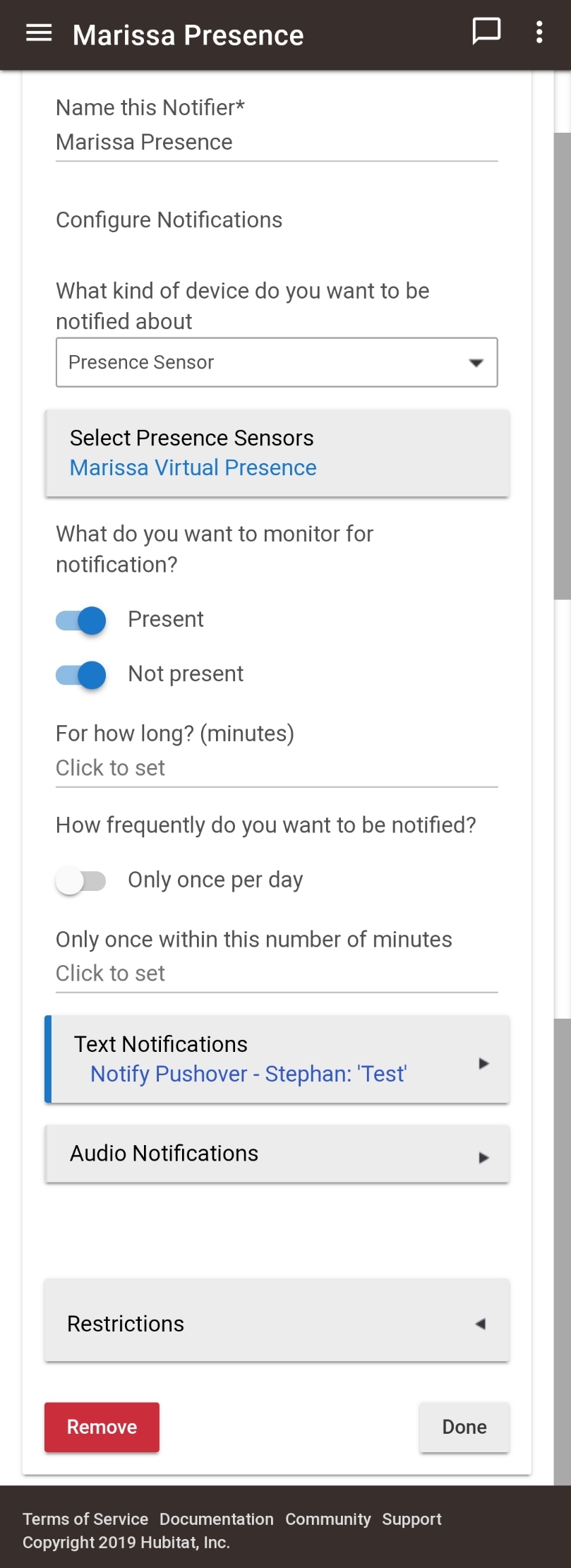

@patrick I've been moving my simpler notification from RM to the new app. I setup a presence notifications as shown below but none are being sent.

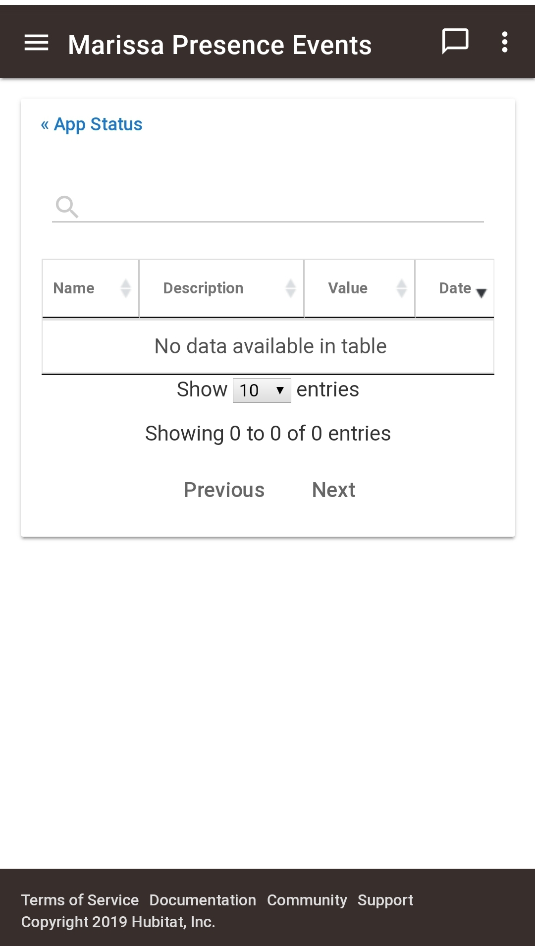

I am not able to reproduce this. So, need more info from you, such as app status page, app event logs. Notifier does create app events.
I'm not able to tell anything from what you've showed me. How about showing the Notifier setup page? How about the app status page? How about screen shots from a computer instead of a phone? I've been using Notifier for all of my presence notifications for a month now without a hitch. Have you tried removing the Notifier and recreating it.

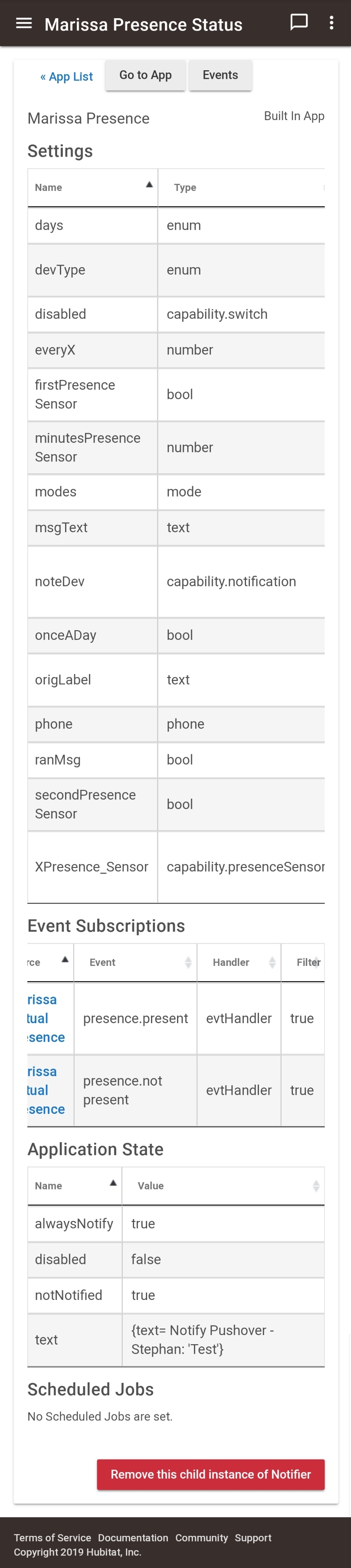

I'm confused. The screenshot is from the child app status (cog). I thought that is what you needed. I am at the office (trying to catch off after being out sick) so all I have right now is from my phone. The screenshot should have what you need is you expand the full picture.
I will send the parent app status shortly but it will be from my phone and will also require expanding the full pictures.
The setup page is in the OP...needs to be expanded as well.
Phone screenshots are super hard to see. But, your subscriptions appear normal. And, as I've said, I cannot reproduce any failure with presence devices. Forget parent app status, it is unimportant.

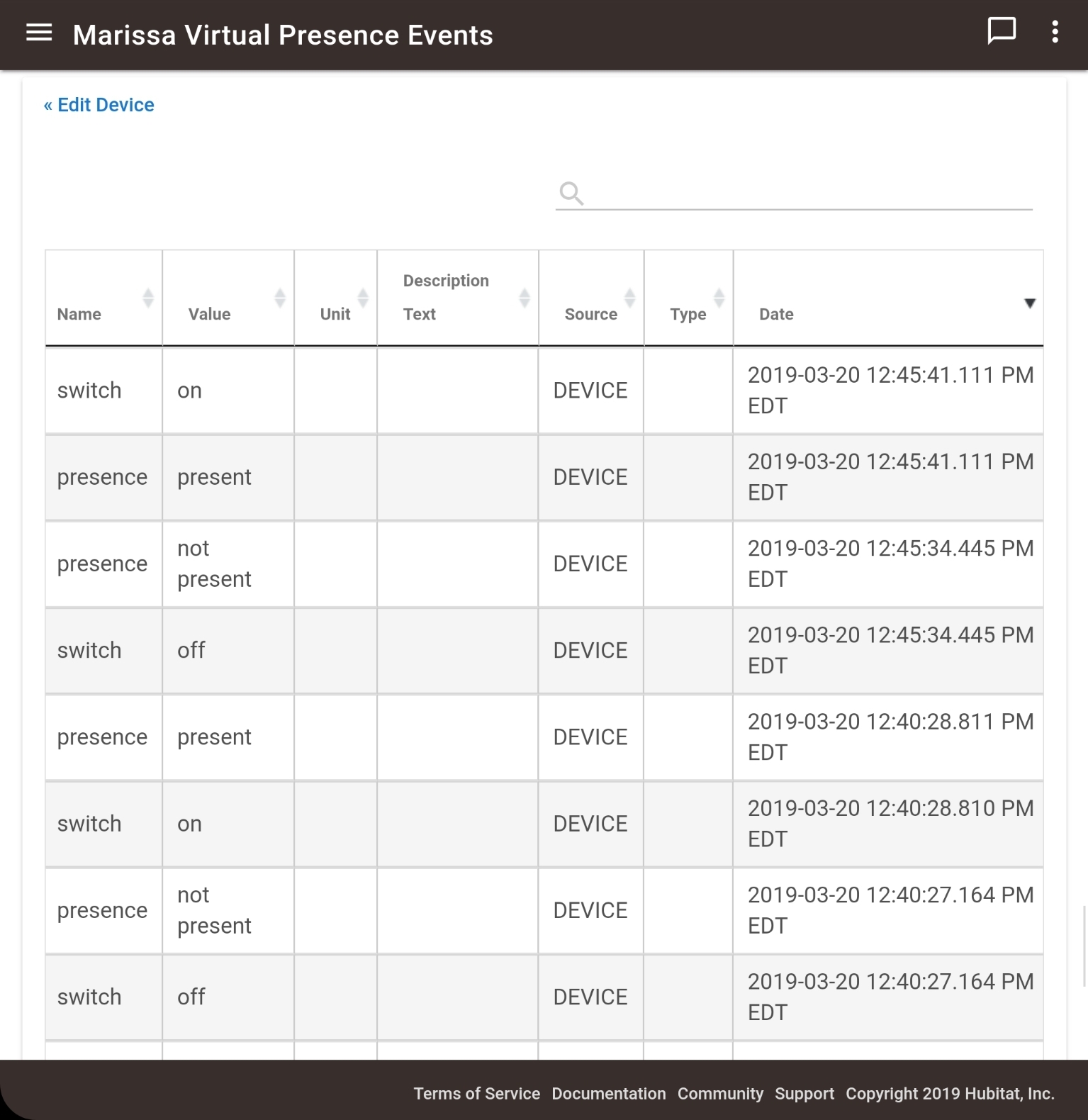

Using the custom Virtual Presence Plus driver is does not respond to present or not present events. I would normally chuck this up to something in the driver but it's send the same events as the built in...and Rule Machine (and every other app) processes the events from thus driver without any issues.

See device logs below...and sorry but it's a phone screenshot. I'm not going to be at my desktop anytime today.

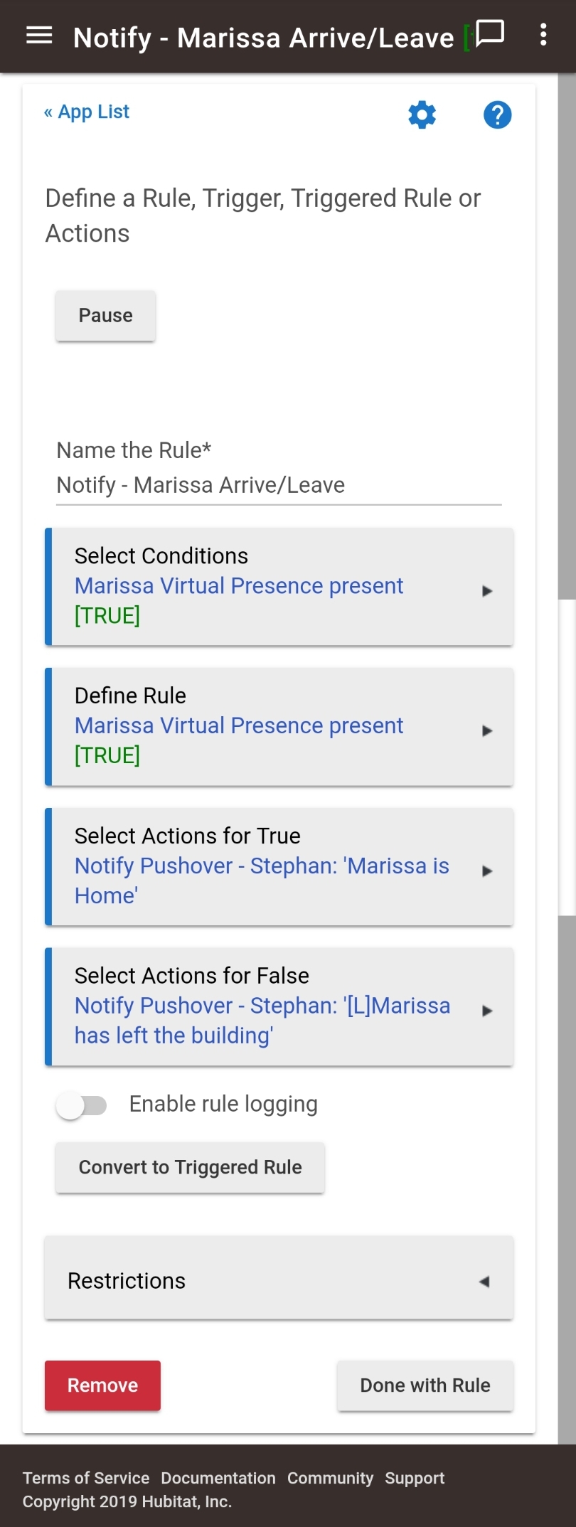

See my RM rule below that works fine with this same device...apologies again for the phone resolution.
