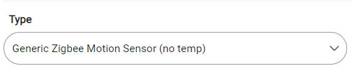

Have you tried the built-in "Generic Zigbee Motion Sensor (no temp)"?
Capture

Some Zigbee devices if the correct driver is not selected when you first pair them will do this. You have to change the driver and then pair again so it can initialize with the correct driver. That might be what fixed it for you?
I guess that's possible. I did pair it multiple times after changing settings without removing it. I am just glad it finally worked.
