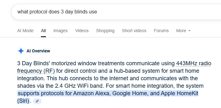

Assuming that is correct, you would need their hub and you may possibly be able to bring it into Hubitat using the HomeKit Controller app (for C8 Pro only). The C8 Pro can basically pretend to be a HomeKit home hub, and you can then pair Homekit compatible devices to it similar to pairing a Zigbee device. This should be local control between Hubitat and the 3DB hub, that is how Homekit typically (always?) works.
Or what @chrisbvt said below, and use Home Assistant with their hub. I assume this would be cloud control where HA connects to the 3DB cloud and controls things that way.
Unfortunately, that is a cloud based hub, so there is probably no way to make these shades locally controlled by Hubitat even with the hub.
A cloud driver could potentially be written for direct Hubitat cloud control using the 3 Day cloud APIs, but I don't see that available anywhere.
The good news is they can be added directly to HA with the HA motionBlinds integration. That integration does still need the 3 Day hub involved, unfortunately. The blinds do have to connect to something locally to get to the cloud.
