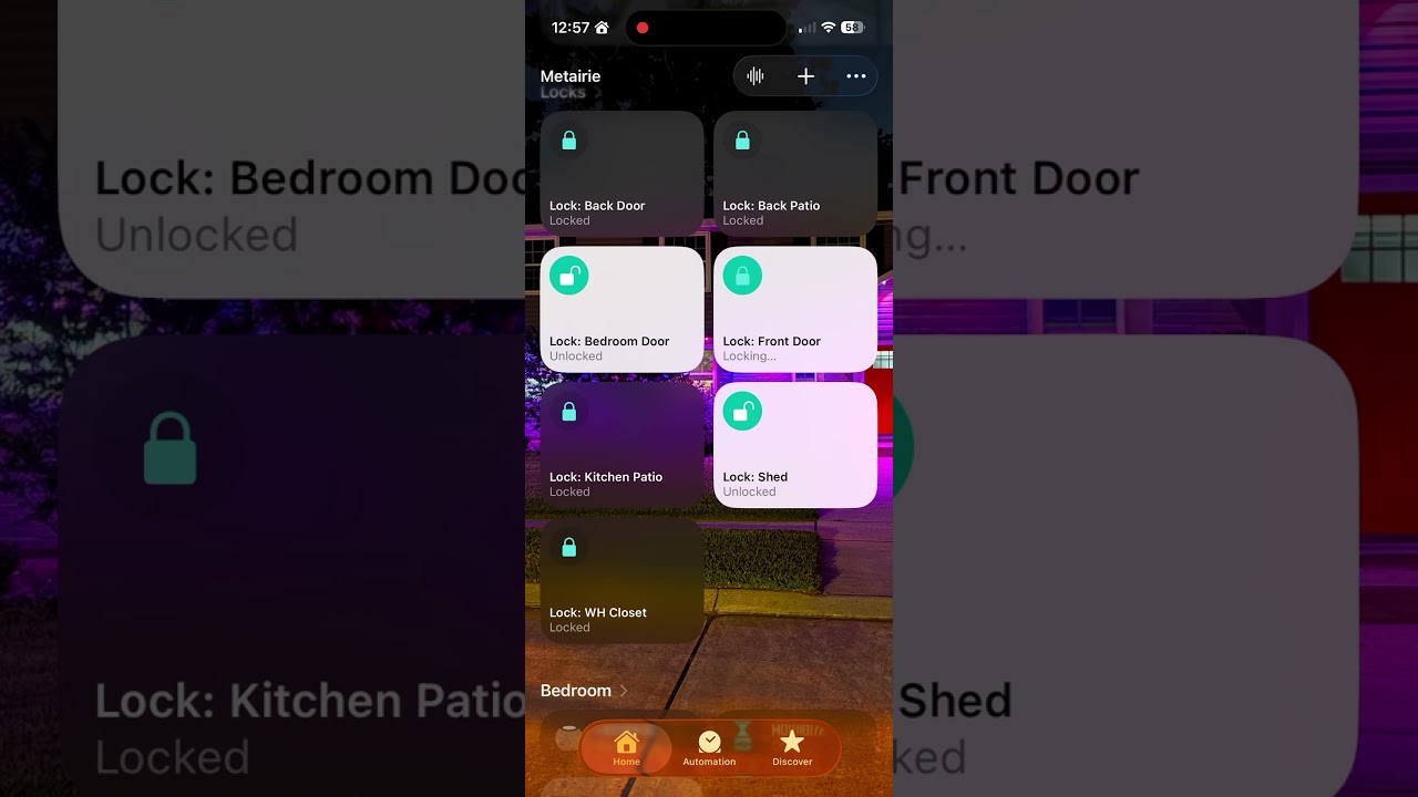

Could this be Homebridge version or plugin version related? I’m on 2.0.0, with plugin version 0.5, and Apple Home seems to receiving updates - I made a video just to confirm that we’re referring to the same thing:
