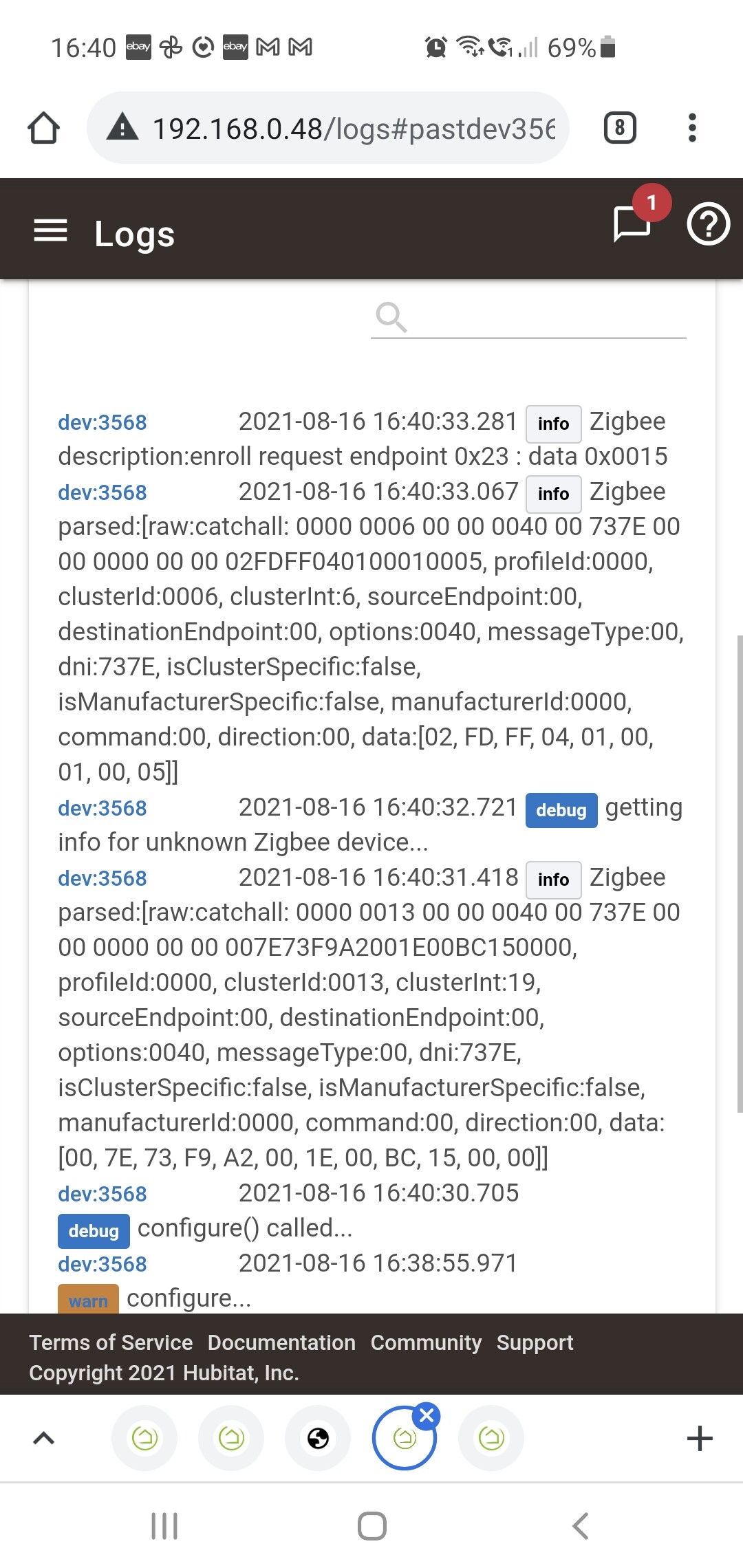

Remove it and pair from scratch with live logs open?
I don't think that is needed. YOu can get the fingerprint using the Device driver. @mike.maxwell can add that to the built-in contact sensor driver. When that new driver is added to your system, then a reset of the sensor and re-pair should get it working as expected.
Some Frient devices are problematical for generating fingerprints that will match the way HE currently needs them, so you probably won't get much luck trying to extract one the usual way.
You might get lucky if you change to the Generic Zigbee Contact Sensor (no temp) driver and then re-pair the device in-place (i.e. without removing it first). This means it has a reasonable guess at the correct driver already assigned to it, so when it re-pairs it will run through any initial configuration.
