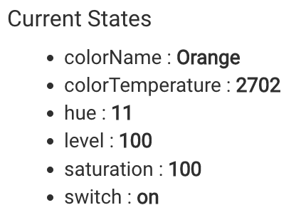

@mike.maxwell just letting you know that this is still an issue. When I refreshed my new bulbs (firmware updated to the latest) it showed:
Screen Shot 2022-11-02 at 2.48.26 PM
I couldn't get it to add to Google, even after manually setting the Hue, Saturation, and Level values, hitting Configure, hitting Refresh... So I swapped to the Generic Zigbee RBGW Light driver, and hit refresh to this result: when I switched back to the built-in Sengled driver it now shows colorMode:
Screen Shot 2022-11-02 at 2.50.04 PM
This might be a different issue than the previous one (I feel like I fixed it with bulbs in the past by setting the Hue value), so I wanted to let you know in case an update can be made to the driver to recognize the bulb type. I hope RGB is correct, I would have expected RGBW.
If it helps to know, the device was automatically added under the Sengled Element Plus driver and I changed it to the (proper) color driver. Maybe that was the root of the issue?
probably, I'll need the fingerprint for the bulb, and the bulb type (color, color plus, ect)
