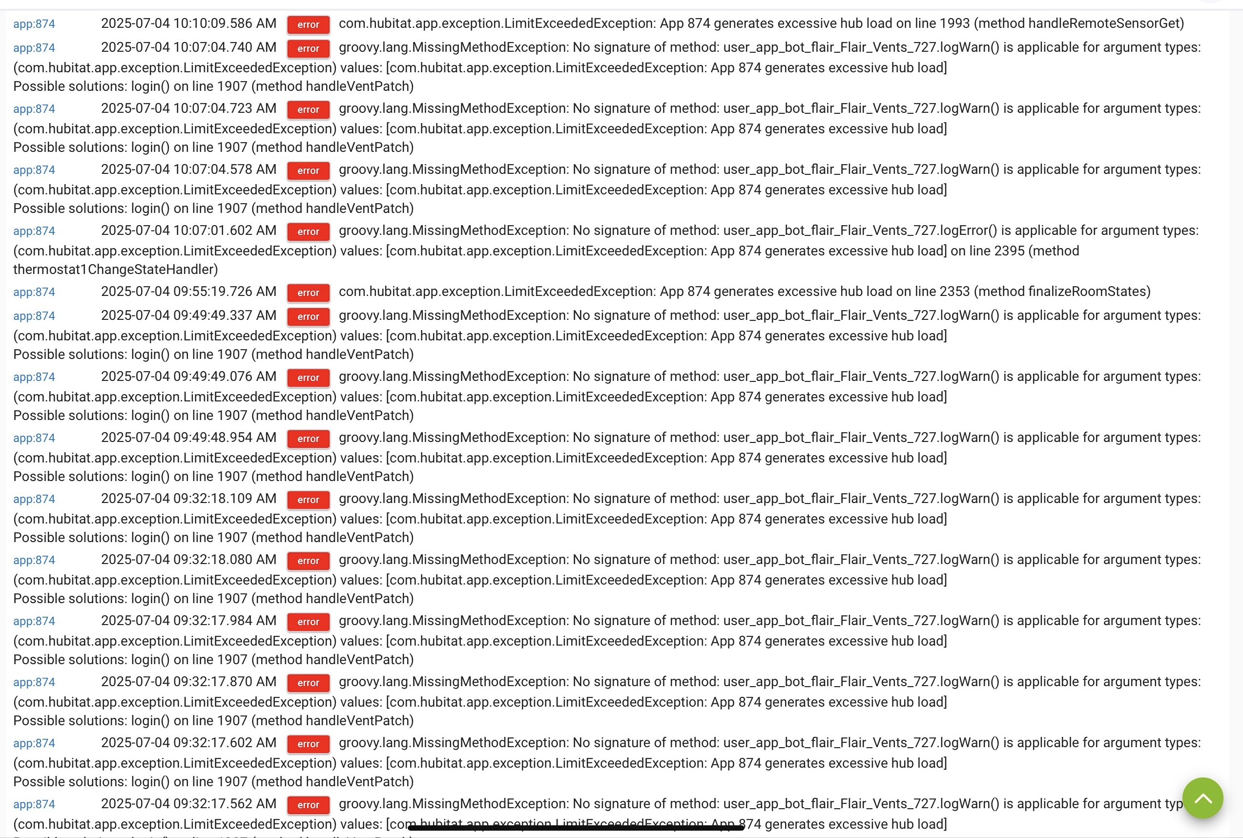

@ljbotero, I had to disable your app because I was getting flooded with these errors (log below). I’m suspecting this may be unique to me as I have 3 instances running in parallel (one each for upstairs, ground level, and basement) since each is its own HVAC zone. This is happening only for the one zone where I have relatively many vents (21). But I never had this problem with prior versions, so maybe there is a fix I can try?
FWIW when I check “app stats” and “device stats” in the HE log, your integration doesn’t show up anywhere close to the top of the list in resource consumption, so I’m confused why it’s happening.
error log

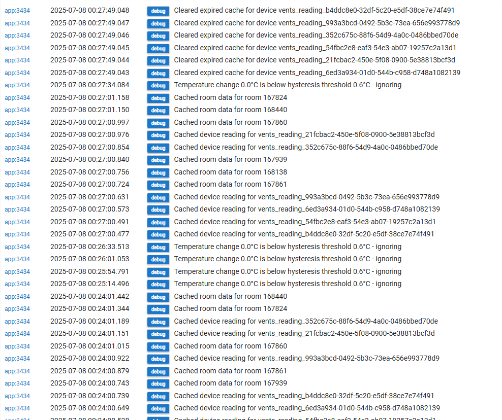

I am getting TONS of these debug messages:
A clue as to why the
Temperature change 0.0°C is below hysteresis threshold 0.6°C - ignoring
is showing up so much? I know that the room temps are changing more than 0.6C.. more like 1-2 F.
Does this indicate that the temperature sensors are not being used?

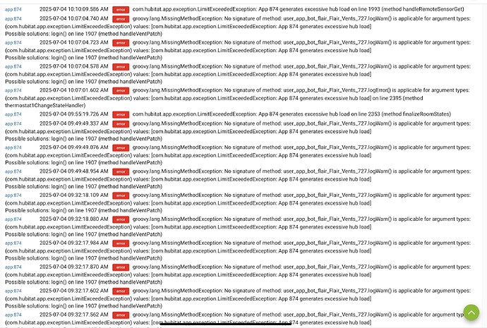

Similar to some others, I am just now transitioning to this app from MyFlair due to deprecated status. However, after 48 hours of running the app, I am getting a lot of repeat errors on excessive hub load that I'm not sure how to resolve.
I am not using the dynamic balancing feature, just using the app to bring in my pucks and vents for control and monitoring via webcore. Any assistance/guidance would be much appreciated! Errors I'm seeing repeated constantly:
[app:1094]2025-10-21 06:24:01.976 PM[error]com.hubitat.app.exception.LimitExceededException: App 1094 generates excessive hub load on line 1821 (method handlePuckGetWithCache)
[app:1094]2025-10-21 06:21:56.275 PM[error]groovy.lang.MissingMethodException: No signature of method: user_app_bot_flair_Flair_Vents_202.logWarn() is applicable for argument types: (com.hubitat.app.exception.LimitExceededException) values: [com.hubitat.app.exception.LimitExceededException: App 1094 generates excessive hub load]
Possible solutions: login() on line 1939 (method handleVentPatch)
