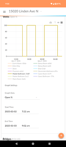

So, I'm still at the point where I have installed 13 vents, installed Hubitat Elevation, installed Jamie's program with Dynamic Air Balancing but haven't done anything else. The good news is that my vents are opening and closing with 10% increments (I believe). The bad news is I'm not sure why but I am not sure it's balancing. Here are my current temperatures and % opening. The coldest room in the house now is our master bathroom (as we are remodeling and it's down to the studs). You can see the temperature is super low (57) but the vent has been at 0% for the last few hours. Additionally, this is going from 0% to 100% where others are going up and down at 10% increments.

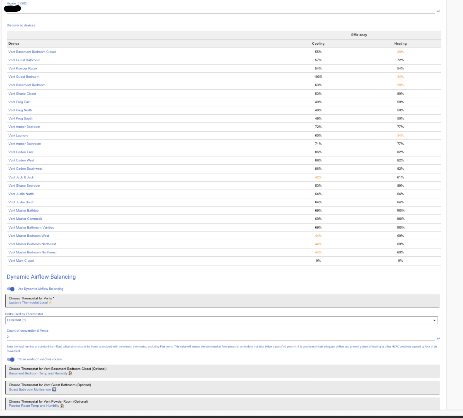

  1. I use the in-built Dynamic Air Balancing to open/close the vents based on temperature differences between the respective in-room temperature and the zone's thermostat. This I accomplish just through the HE app settings, as follows:
Flair App Settings
Flair app parameters (note I have cut off all the repetitive vents fields at the bottom):

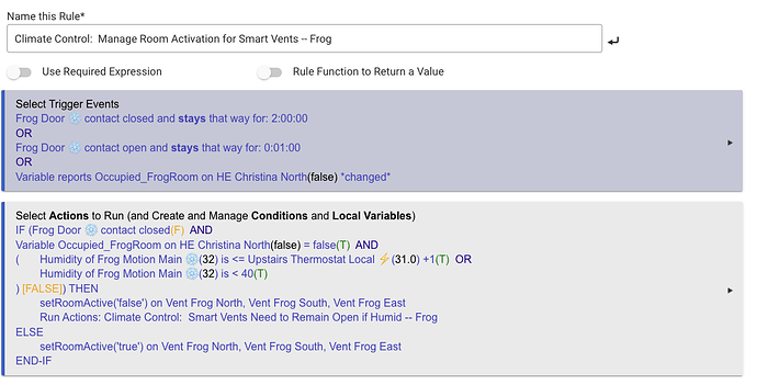

  1. Then I have a series of RM5.1 rules (one rule for each room) that sets the room as active or inactive based on whether it's occupied and also whether the door to the room is open/closed. As you probably know, if a Flair room is flagged as inactive, then the dynamic air balancing is essentially overridden and the vent can remain closed. This is important for us because we are empty nesters so we have a bunch of rooms that are basically never used any more -- for these rooms, when we close the door for a prolonged period with no occupancy, it's our way of mothballing the room. No need to heat the space to the same degree. These rules accomplish this. (By the way, you'll see in this rule reference to humidity also -- this is because if the house gets overly humid, we don't want the vents closed even if there's no one in the room. See the next rule!)

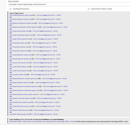

  1. Make sure all the vents have a strong wireless signal so they don't miss messages (you can see I have a couple on the edge of what's acceptable):
Monitor Signal Quality for all Vents

Maybe post the efficiency stats in the HE app page. That gives you a sense of how much balancing is going on.
Lastly, take an extreme example (like the Master Bathroom that appears way underheated) and post the events over time for %-open value. Try to get a sense where the Flair app is attempting to reroute more heat to that vent.
