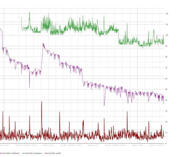

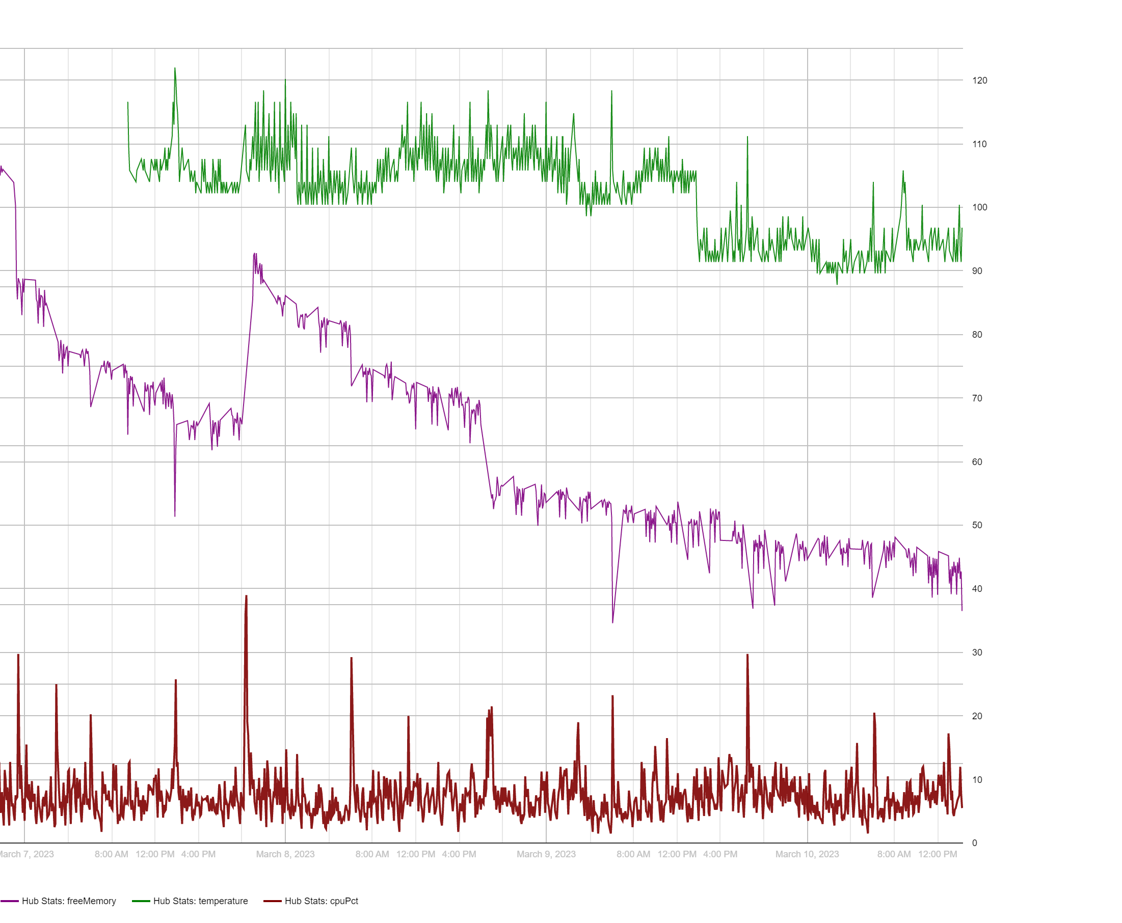

New c8 running a little hotter than my c7 was... fan solution,
this fan works well for cooling.. silent innexpensive and dropped it about 14 degrees on average.
https://www.amazon.com/dp/B00G05A2MU?psc=1&ref=ppx_yo2ov_dt_b_product_details
you can see drop here... i have it on the lowest speed of the 3 available.
