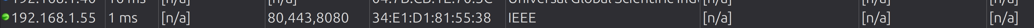

Another way of finding it.
If you are using windows, you can download a program called “advanced ip scanner”, or “angry ip scanner”.
There is also a version for Linux that is downloadable.
You are looking for something like this:
Notice the first 6 digits of the mac address.
