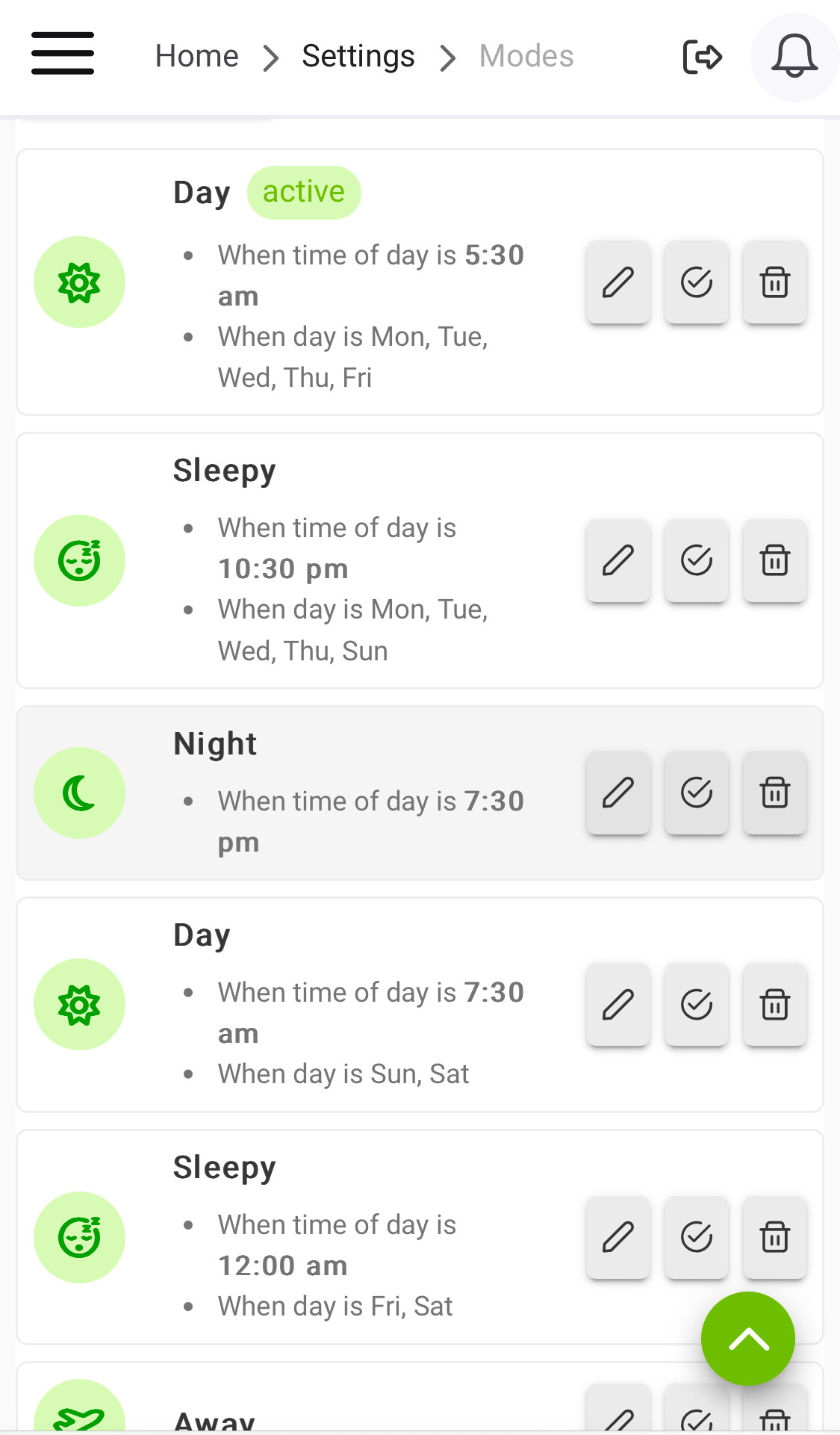

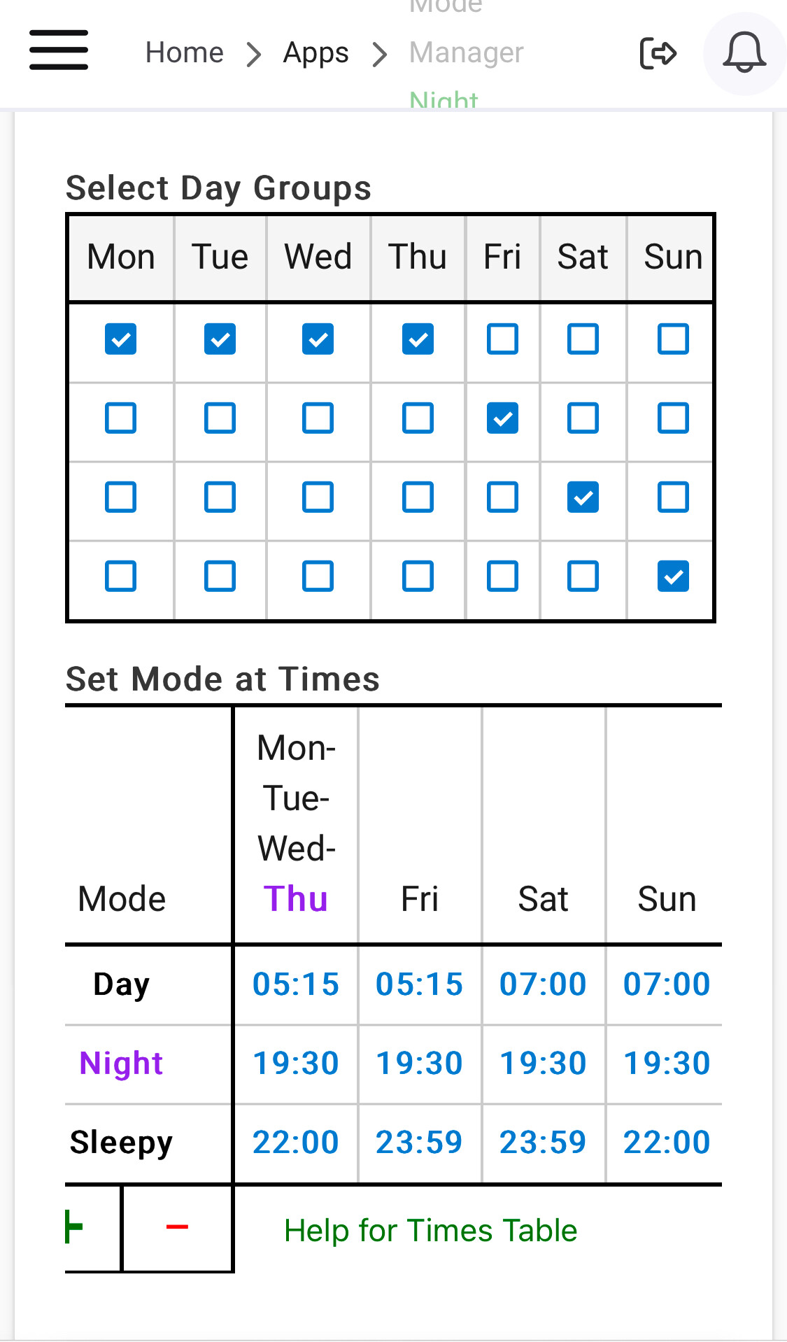

Yeh I can’t work it out in the old app it looked like this
In the new integrated app in seems I have to make another mode of day to achieve the same, unless I’m missing something.

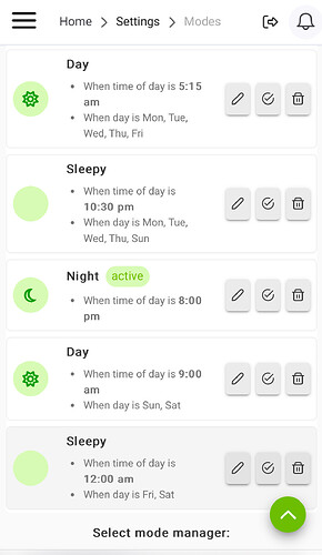

I think I have it sorted, well at least it appears to be working as it should duplication of modes seems to be the way forward, there must be something in the background that recognises the second day is still day. (If that makes any sense).
The thing that caught me out was when I added an additional night I had to go back in to each instance or room lighting and re select night and the appropriate light configuration.
I’ll see how it pans out, but generally if there is a neater solution I’m all in (and I don’t like being beaten by tech)

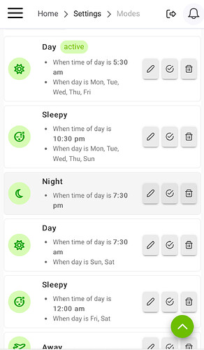

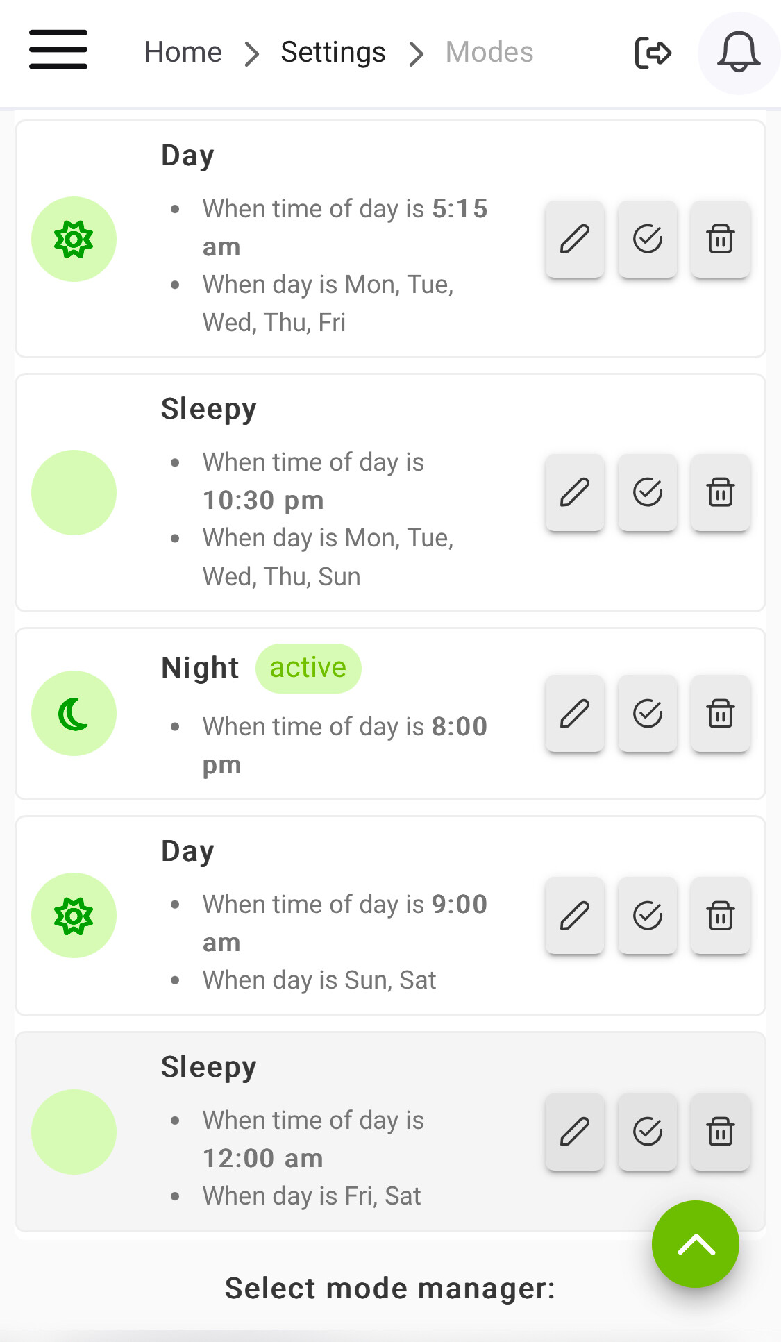

Mode setup as it stands.

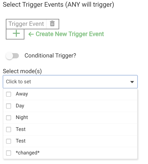

I was thinking "modes with the same name must be the same thing". Looks like that's not the case. I had a mode named "Test". I created a second mode also named "Test" with different day/time triggers. I then tried to set up a rule in Rule Machine to using Test mode as the trigger. In Rule Machine, there are two entries with the same name:
I created two rules, one triggered by the first "test" mode listed, and one by the second. The rule just writes a log entry to say it was triggered.
When I went to the integrated mode manager and manually activated either "Test" mode, only the rule where I selected the second one fired. No matter which copy of "Test" I tried to activate, the rule I created where I had selected the first "Test" on the list would not trigger.
I switched the first rule to use the second trigger, and then both rules fired. So only the second instance of "Test" on the drop-down list was working. A rule based on the first instance of "Test" in that drop down would never fire.

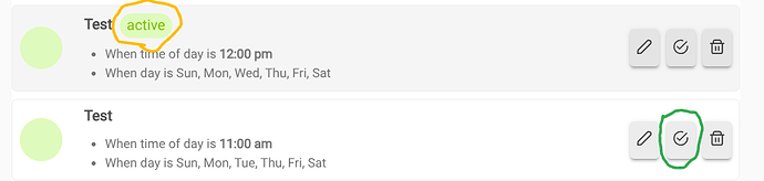

To clarify, no matter which "Test" mode I tried to activate, the FIRST one that I created was the one that showed active. But that seemed to correspond to the SECOND one in the drop down list in Rule Machine.

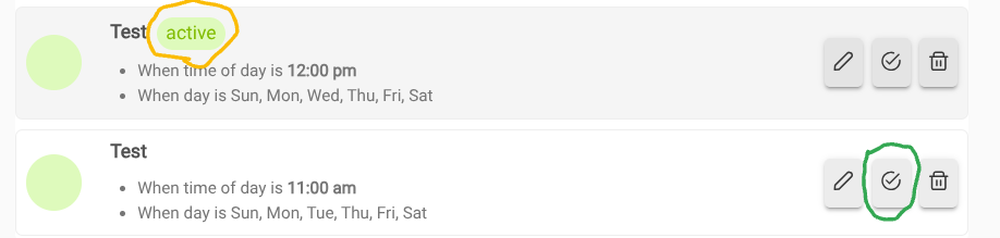

When I click the button I circled in green, the active flag gets set on the other mode.

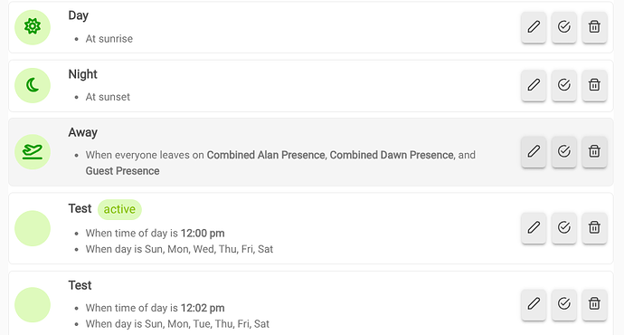

I couldn't find any way to activate the second Test mode. To make sure the bug isn't only with manual activation, I switched the second Test mode to activate at 12:02 PM. When that time arrived, the OTHER test mode activated. This screen shot was taken at 12:03.
