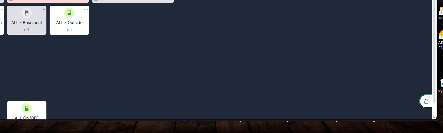

The fix is not in on .142, from what I'm seeing, for scrolling/scroll bar, or moving tiles below the bottom edge of the screen.

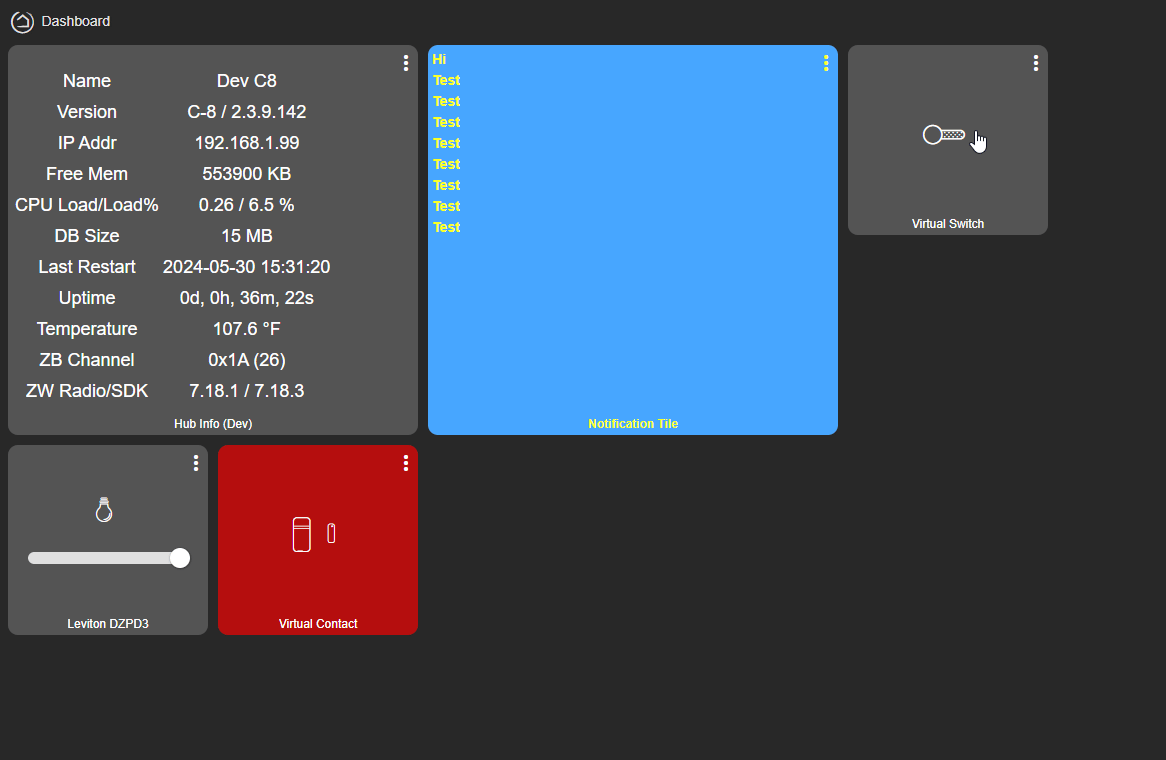

Are you dragging the tiles to an empty space on the dashboard? In the current implementation, you can only drop tiles on an empty space, not on top of another tile.

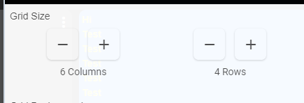

What is your grid size (click the gear)
And click the ... on any tile, what does this grid look like?
