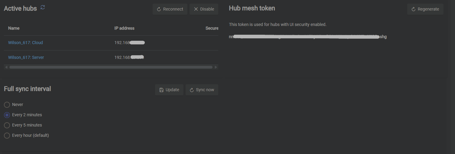

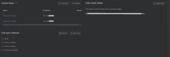

My concern was with the Hub mesh. Once I identify the new addresses, wont the only thing I really need to do be to update the hub mesh settings? I'm guessing disable and reconnect? Not exactly sure there. Is there a better or recommended way?

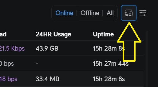

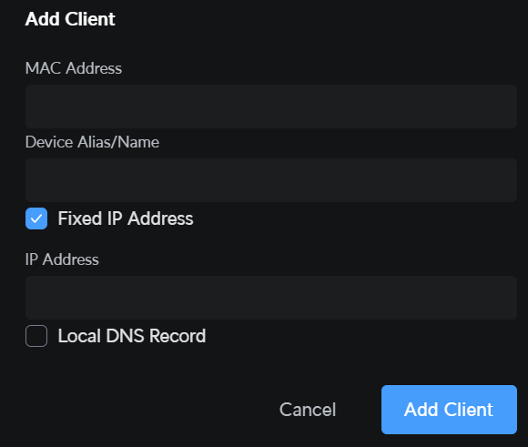

Pre-switch use Add Client to setup your reservations:
Client Devices Page, top right corner.
add client
Add MAC, name it, select ip. Repeat.
I havent started this project yet. I want to have a moredefiend process planned out before I dig in . The equipment arrived last night. Are these shots from the Unifi interface?

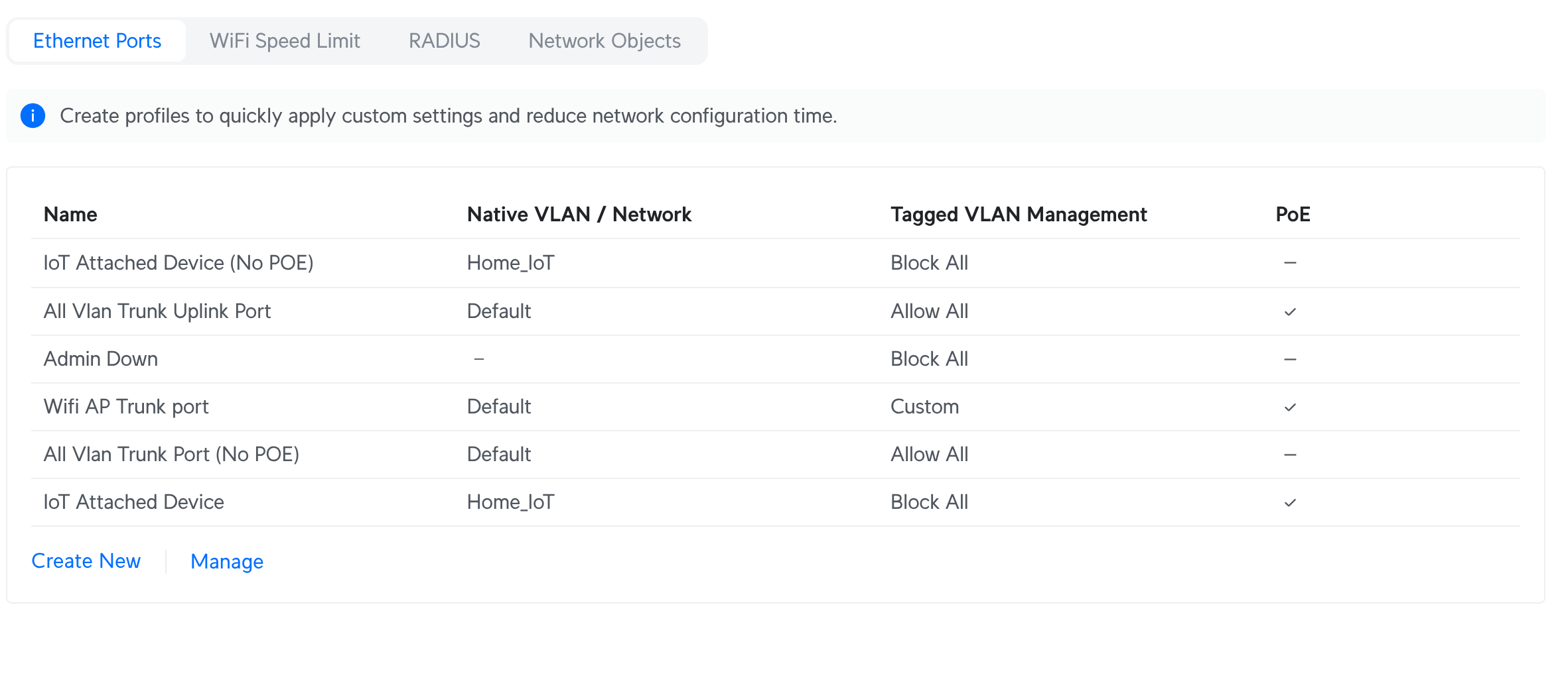

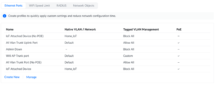

You could also setup some port profiles before hand to help with certain functions. I know use them allot on my gear to determine if POE is used or to lock a port to a network port to a specific VLAN. If you use ethernet allot you will likely want to setup some profiles to help device connect to the right vlan when physically connected.
Here is my list of port profiles and I use this to ensure a certain setup on a given port based on use case.

Addresses. Just need to know how to make sure my hub mesh gets working again.
