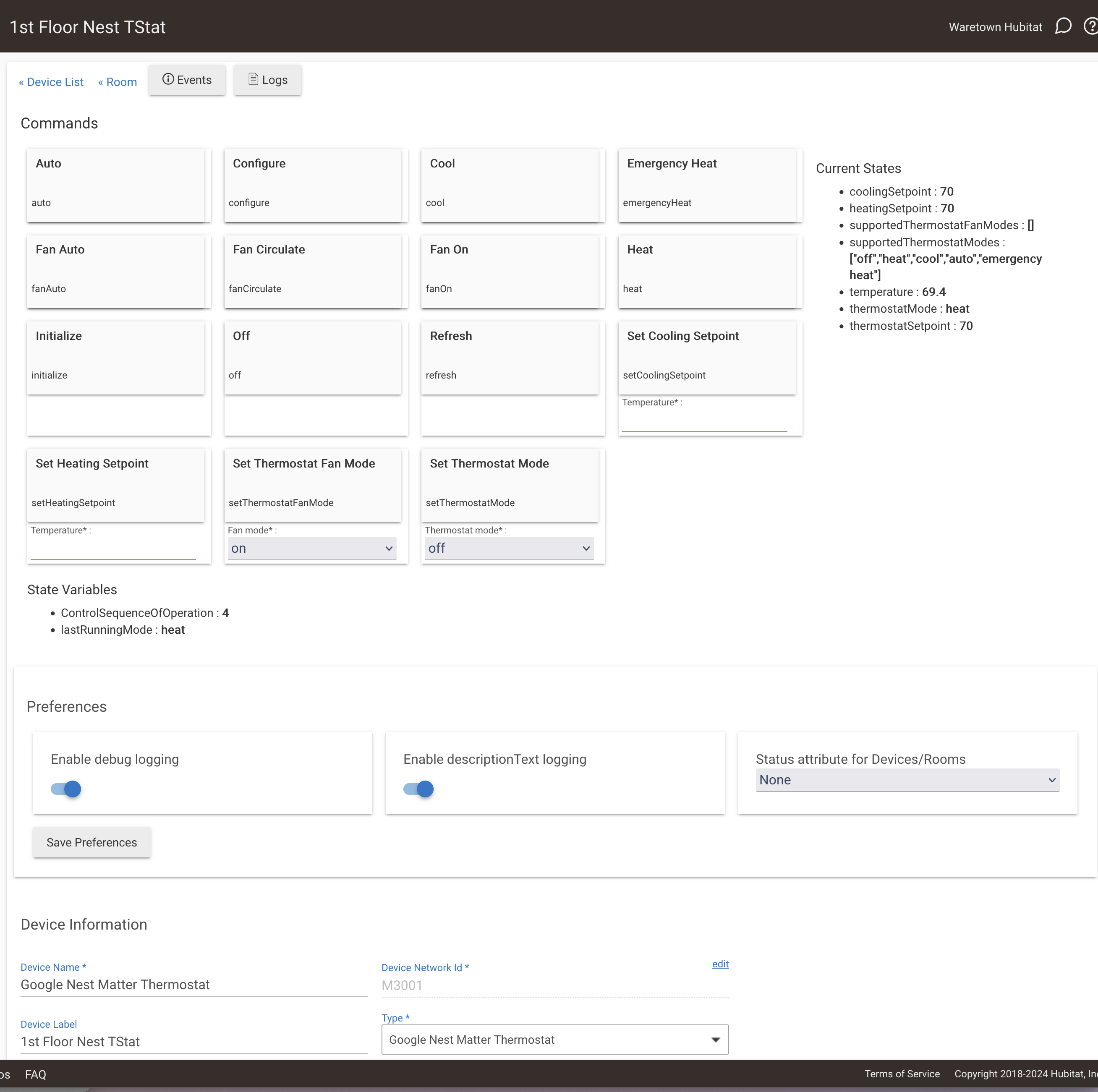

I added a Nest thermostat successfully, but under the device’s Current States it shows supportedThermostatFanModes as an empty list (just 2 brackets). Why wouldn’t the built-in driver populate it with all the fan modes (e.g. Auto, On etc)? More importantly, can I somehow fill in the supported fan modes?
In addition to the expected On and Auto fan modes, the Nest tstat also allows you to set the fan to run a specified amount of time (e.g. 15 mins, 30 mins, 1 hour…). Perhaps this complicates things for the driver ?

Hi - I saved your app, then ran it. No error messages, but the tstat's supportedThermostatFanModes still shows as blank when I look at the device details page. The supportedThermostatModes did not change either - still shows ["off","heat","cool","auto","emergency heat"] - I would have expected your app to populate it with ["off","cool","heat","auto"]
Maybe the default Matter app/driver can't be modified - as far as default values?

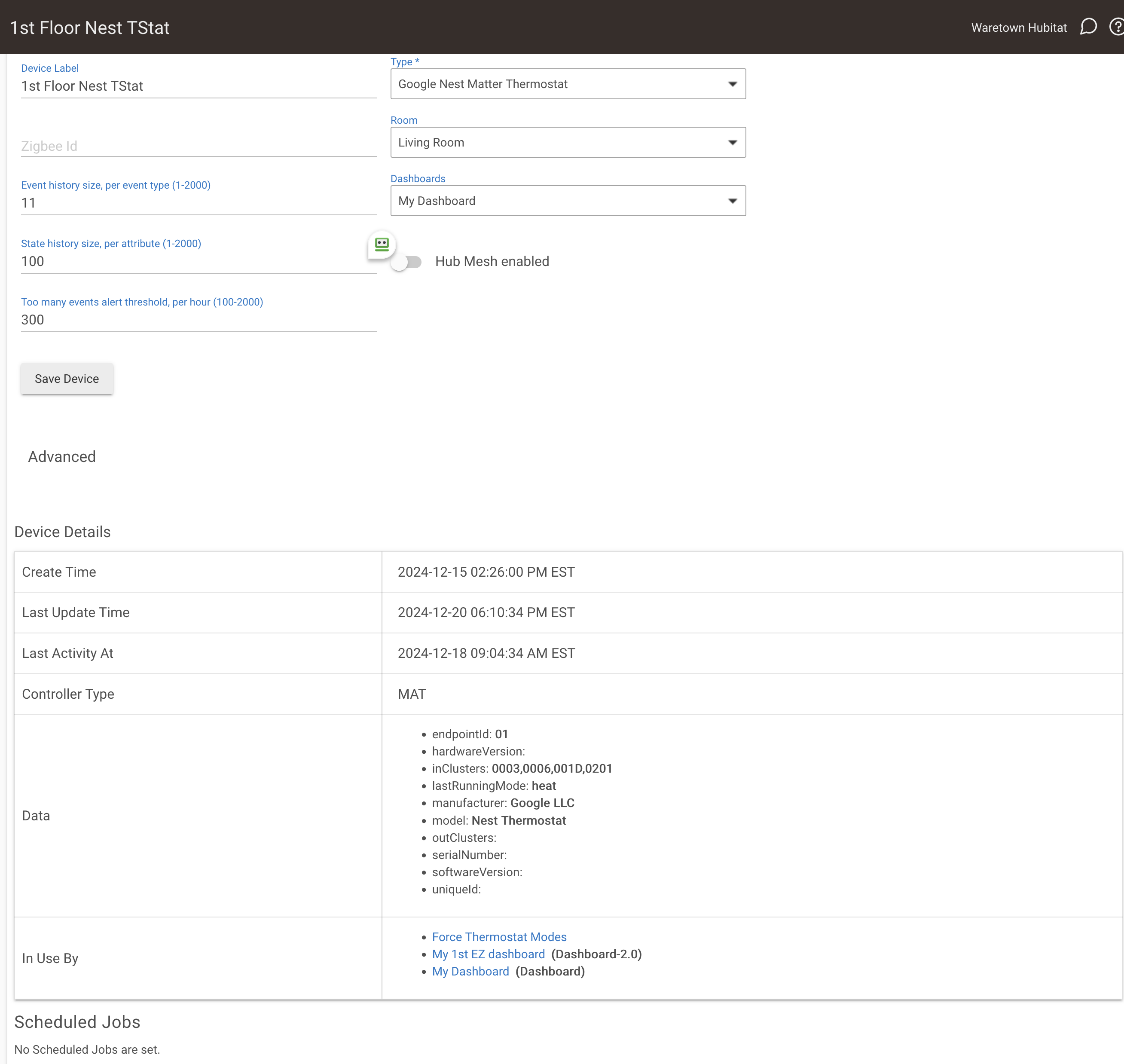

And here's a screenshot of the device page for this Nest tstat (v1.3 - 10):

The most recent activity under device's Events or Logs is back on 12/18 (4 days ago). It's almost as if it's stopped working. On the screenshot of the tstat's device page you'll see Last Activity 12/18/2024 9:04:34 am. I just did a reboot of hub, and still this tstat device shows last activity on 12/18. Almost sounds like the connection between HE, Matter and device is messed up. Then again, I'm a total newbie :slight_smile:
I think I am going to [Remove] this tstat device and add it all over again. I just tried to change the tstat's heating temp on the device page, but it did not change the temp when I look at my Nest tstat. So something's broken...
So I removed device, then reinstalled again using Matter. Now the Events show temperature readings. And I can change the temp by typing in a value in F under setHeatingSetpoint and then click on the [Set Heating Setpoint] button and it does change the tstat temp and shows in Events. BUT, after I run your app, nothing shows under device's Events or Logs (other than temp being reported). Not sure what to try next ?

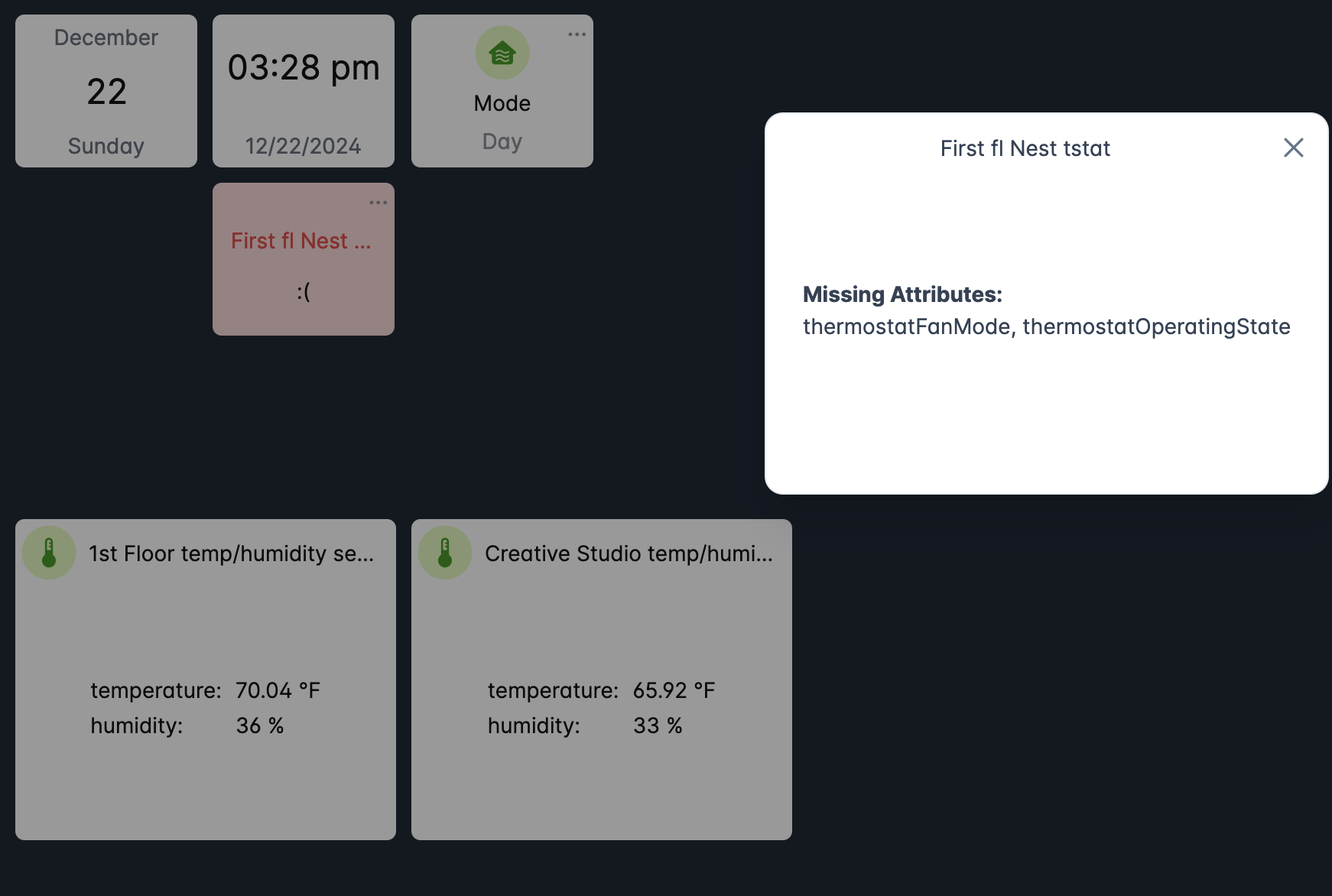

Below is what I see on an EZ dashboard that contains this tstat - you'll see it's a red tile and when I click on it I got the Missing Attributes warning...
I could force those too, but should be able to set them using a command in the driver.
