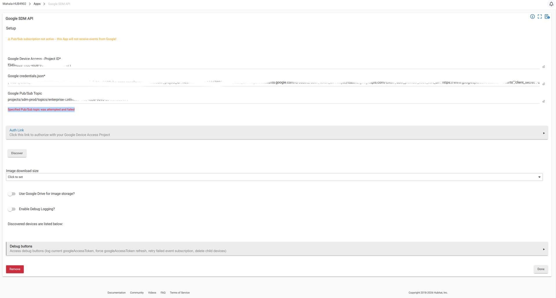

Has the API finally closed for Nest integration? I have been using the Nest Integration and App by David Kilgore (which has worked flawlessly) until this year. The issue is the state status will not update unless I refresh it manually at which point the rule triggers and other logic runs based on the state changes within the rule.
I see the Google SDM API (a sub-component) of the app is failing (see below). I have tried un-installing and re-installing. No luck. It the app no longer operable because of Google?
Have I once again been bitten by cloud based equipment?. I continue to phase out cloud devices. I know there are much better thermostats out there than Nest. I would still like to stay with Nest for now though if I can. If it is dead would you please confirm so and recommend others?

This isn't a Gen 1/2 Nest is it? AFAIK, the API hasn't closed.

Thank you for you quick response. Very much appreciated. I am glad to hear the API is still an option.
It is definitely a Gen 3 therm. I just purchased them at the beginning of last year.
