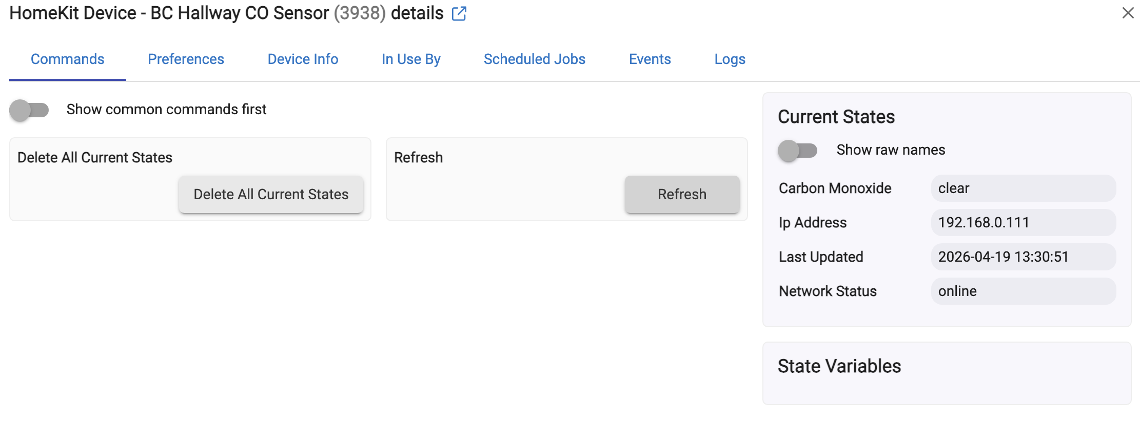

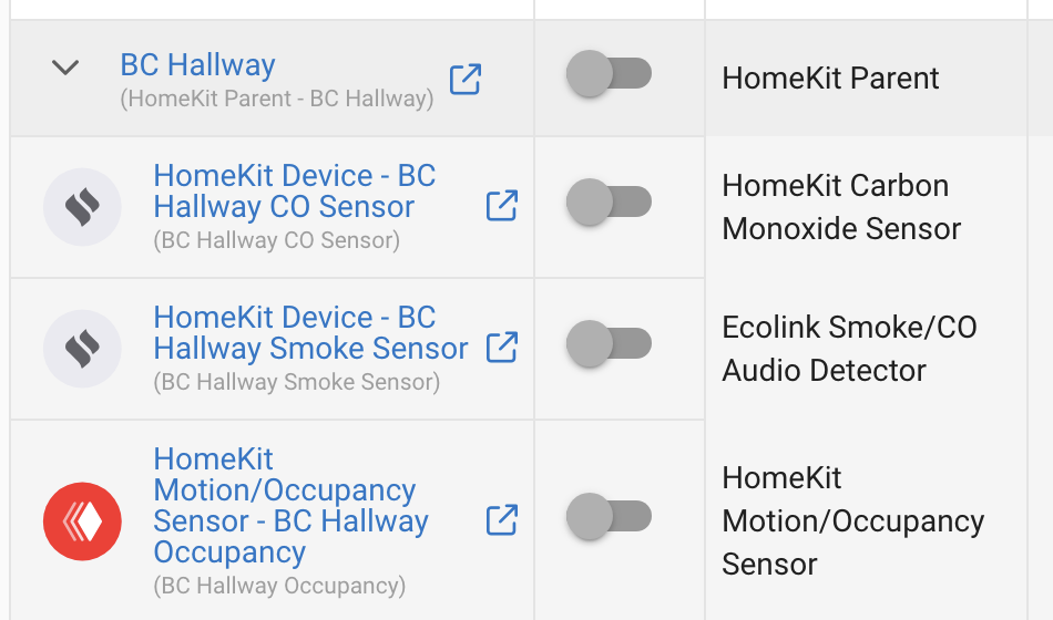

I just tried adding the Starling Hub to HomeKit Controller and it's only the smoke that doesn't currently show statue because there's no "HomeKit Smoke Detector" driver. As you can see from the screenshot below, it appears to work for the Carbon Monixide sensor. You have to change the driver, click Save, and then click Refresh on the Commands tab.

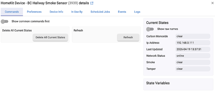

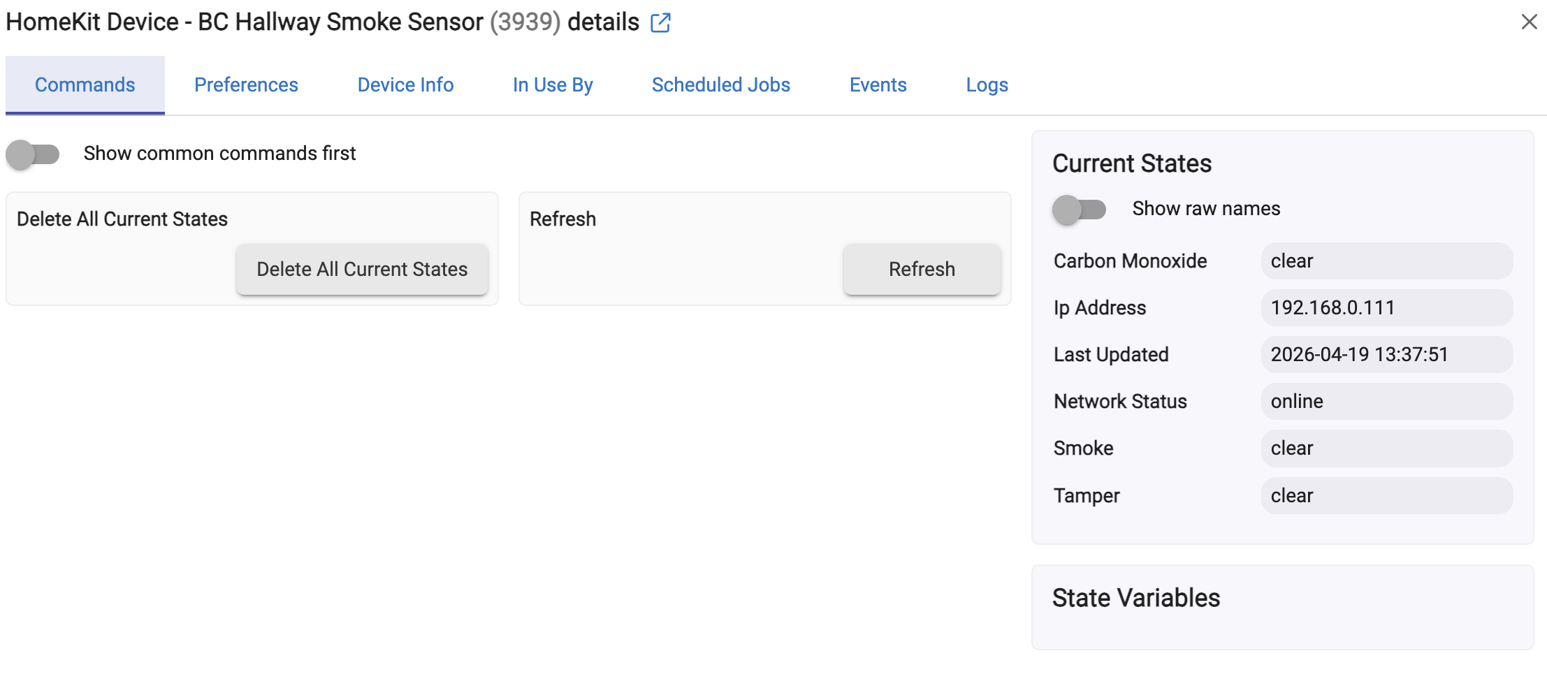

I did try the "Ecolink Smoke/CO Audio Detector" driver with the Nest Smoke Sensor device and the does show Smoke Status after I click refresh (see screenshot). If that works, then you could probably get what you need from the smoke device until @gopher.ny has a chance to investigate and create a "HomeKit Smoke Detector" driver.
