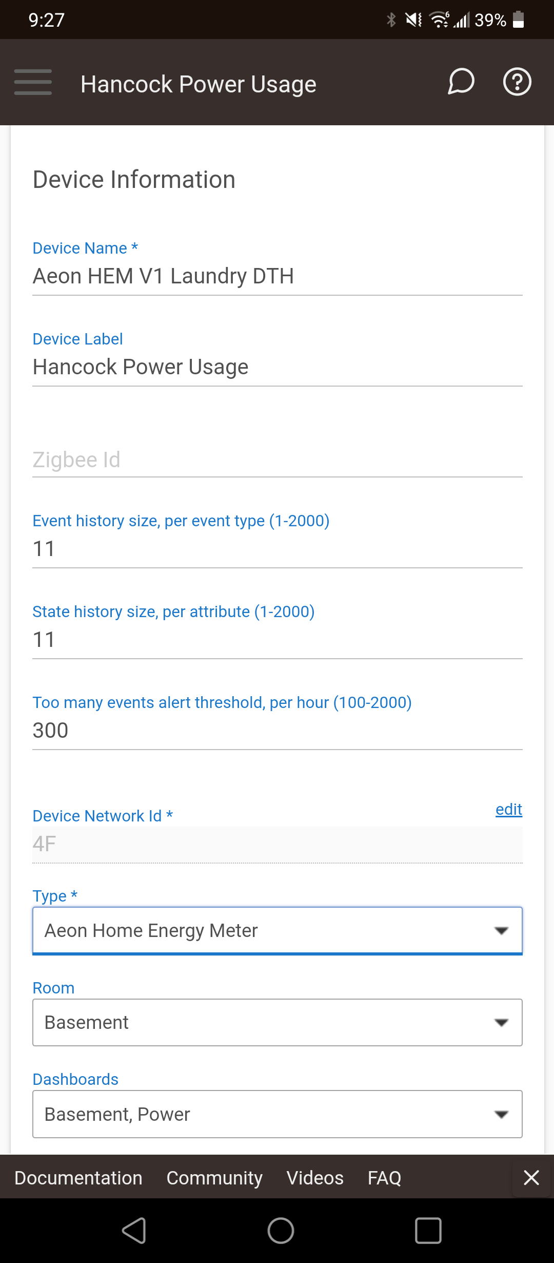

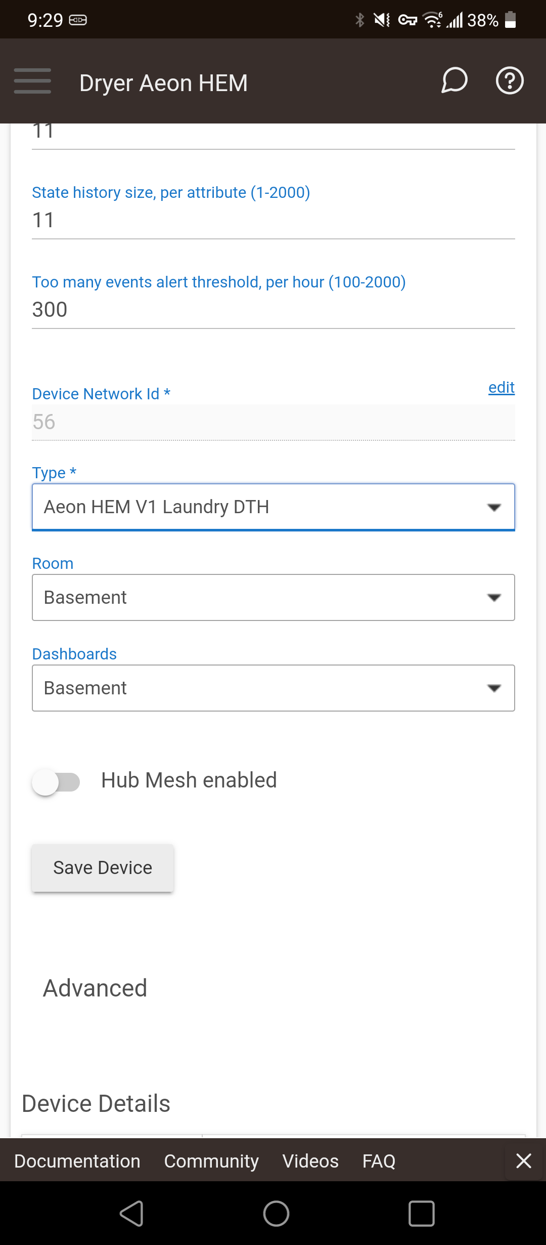

These are the drivers i use; one built in for whole house power and the other (user) for dryer monitoring.
Could you point me to the source code for the HEM driver... Thanks

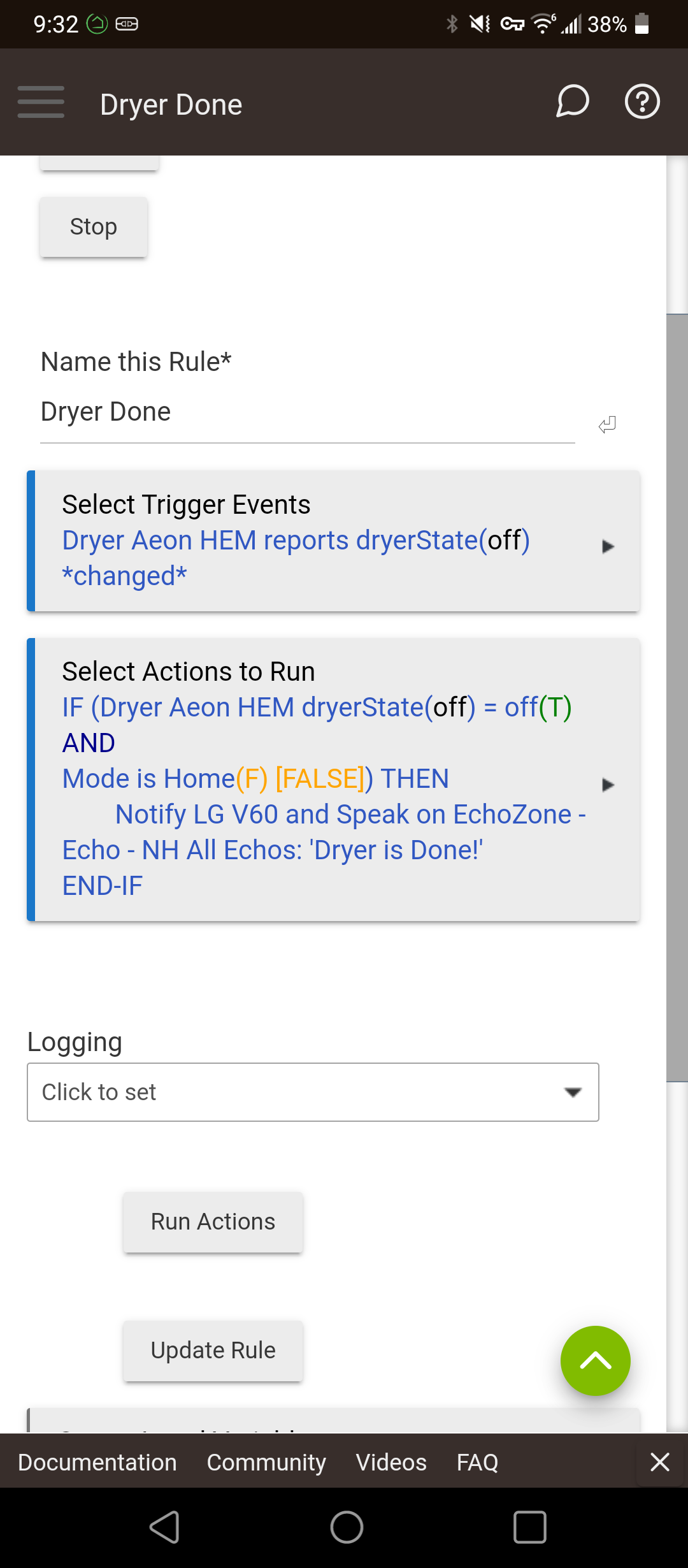

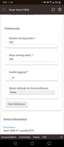

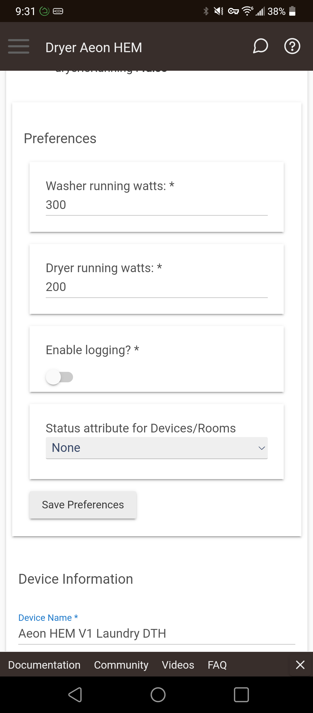

put a new version of my code for this app up there with the following cleanup/modifications
Custom Laundry monitor device for Aeon HEM V1
  • 3/25 modified by lgkahn add preferences to enable either dryer or washer tracking and check so as not to do extra send events
  • also check current dryer and washer state so as not to send extra on events when already on so as not to trigger extra rule firings.
  • also add dryer and washer ignore watts setting default 15000 so as to ignore eroneous data.
  • also updated fx to dump out status when saving preferences. Also add missing voltage update before washer/dryer turn off so you can see event.
  • also fx to turn off debug logging after one hour
