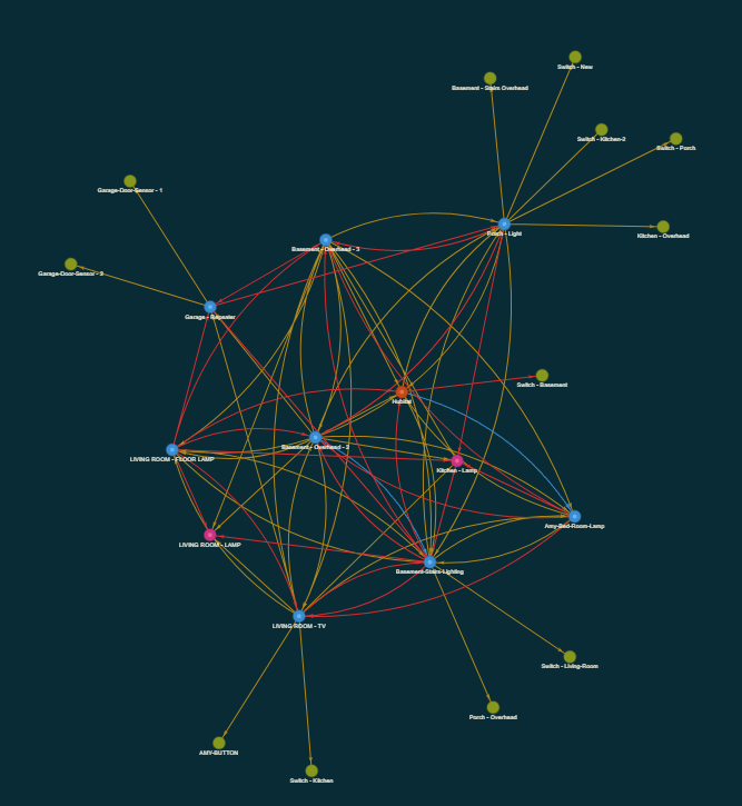

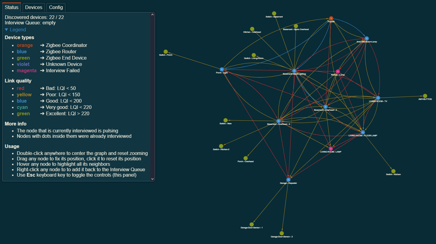

90% of my automation are plugs that have repeaters. and my maps shows way to many bad connections i think away .. lots are red or yellow .. very few are blue to green :frowning:

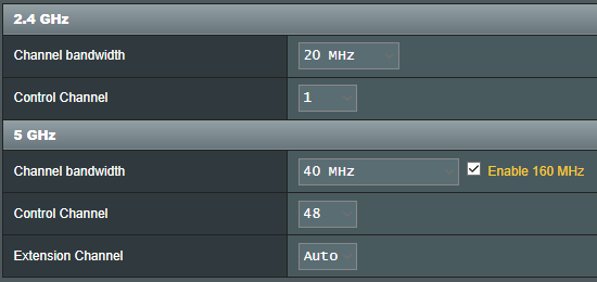

I changed channel 2.4 to ( 1 )
I changed channel 5g to ( 40 )
was set to ..
I will try chan-25 for the HUB
Any Thing Else ?
5g doesnt matter . Only 2.4
Well you would think so ..
But it sure seems having a bandwidth of : 20/40/80/160 < seems kinda big?
And having the Hub on 17-20-25 is really close ? to that ? IDK .. grabbing at straws at this point.

The WiFi and ZigBee overlap is likely the primary cause with their distance from each other being secondary.
The 2.4 GHz band of WiFi is the only one that overlaps with ZigBee. Having WiFi on channel 1 (regardless of selected bandwidth) and ZigBee on 20 will just about eliminate frequency interference.

Well Ok .. have set channel for the wifi to ( 1 )
and did the hub to channel ( 20 ) < thats always fun ..

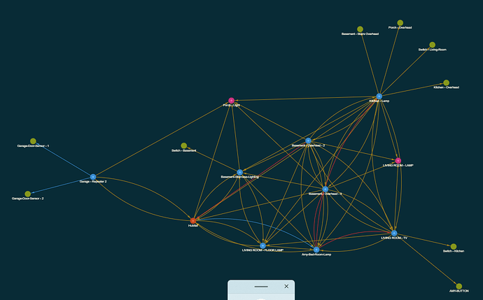

I was looking at my map. and had so many red connections.
I was trying to figure out a way to fix that..
I have been using all THIRDREALITY Zigbee Smart Plugs / Repeaters.
So I went and got these Smart Plug / Repeater's. ( On Sales btw ( 4 ) for $45.00 )
And they seem to work way better than the THIRDREALITY Zigbee Smart Plugs / Repeaters.
The system seems way more stable now. since updating and changing just. 4 of the repeaters
And my zigbee map kind of shows that with way less red connections now.. More on the way!
