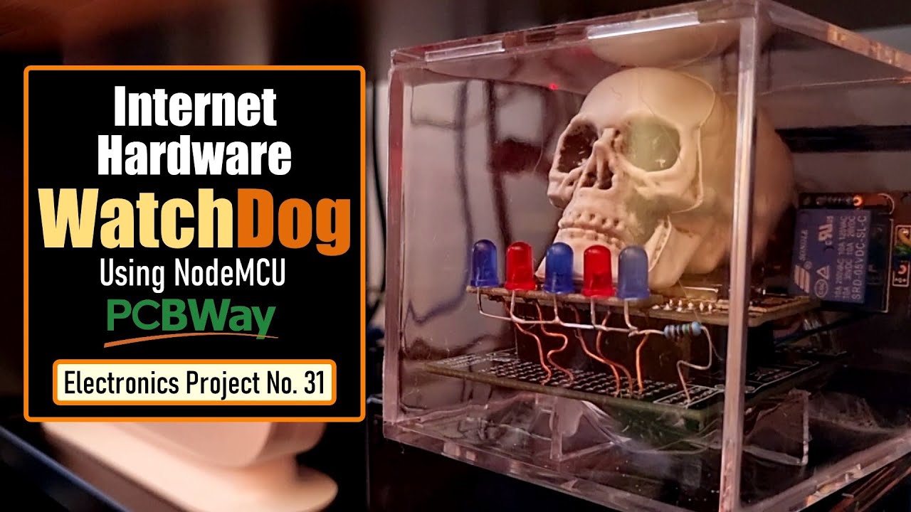

I guess it is time to get serious about a hardware watcher.
Most likely this would suffice, only pinging the hub instead of 8.8.8.8 :slight_smile:
