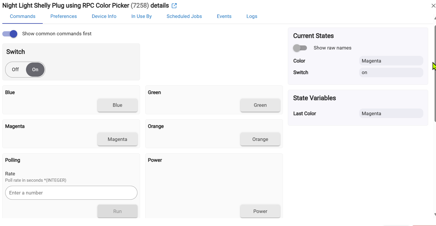

@TArman has not been sitting on his heels...more updates to his RPC driver, including simple on/off switch option, ability to choose color for each state (or all states) of the switch via Set Level command, ability to set power monitoring reporting intervals via Polling command, and an option to provide individual instances of power reporting via "Power" command. Nice stuff!
Code:

def Blue() { push(1, "Blue") }
def Magenta() { push(2, "Magenta") }
def Yellow() { push(3, "Yellow") }
def Green() { push(4, "Green") }
def Orange() { push(5, "Orange") }
def Red() { push(6, "Red") }
def White() { push(7, "White") }

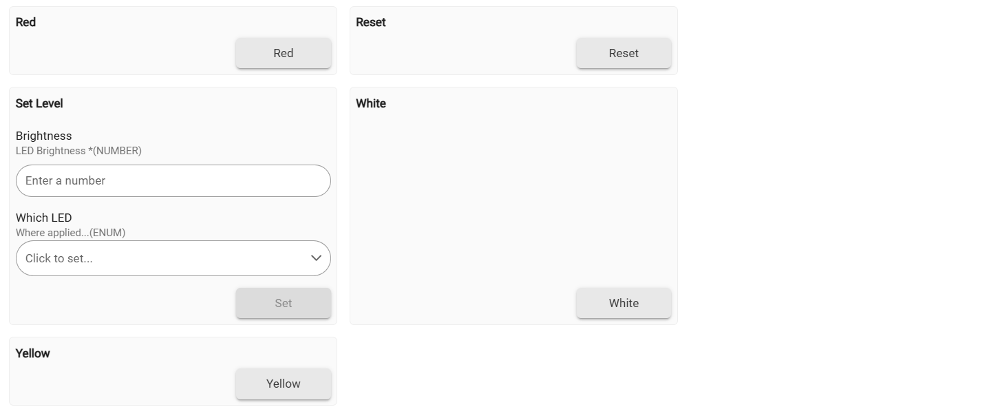

private void setLevel(Number level) {
	setLevel(level, "BOTH")
private void setLevel(Number level, String where) {
    if (level < 0 || level > 100) {
        log.warn "Brightness not 0...100"
        return
    Map config
    if (where == "BOTH") {
 	    config = createLedBrightBoth(level)
     	sendEvent(name: "OnLevel", value: level, isStateChange: true)
        sendEvent(name: "OffLevel", value: level, isStateChange: true)
    if (where == "ON") {
 	    config = createLedBrightOn(level)
    if (where == "OFF") {
 	    config = createLedBrightOff(level)
    if (where == "NIGHT") {
 	    config = createLedBrightNight(level)
        sendEvent(name: "NightLevel", value: level, isStateChange: true)
    if (!config) return
    Map rpcBody = [
        jsonrpc: RPC_VERSION,
        method : SET_METHOD,
        params : [ config: config ]
    String whereLevel = where  + "level"
    sendRpc(rpcBody, "Applied ${whereLevel}=${level}")

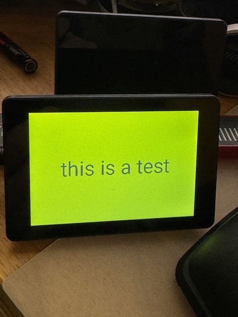

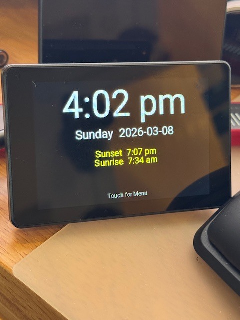

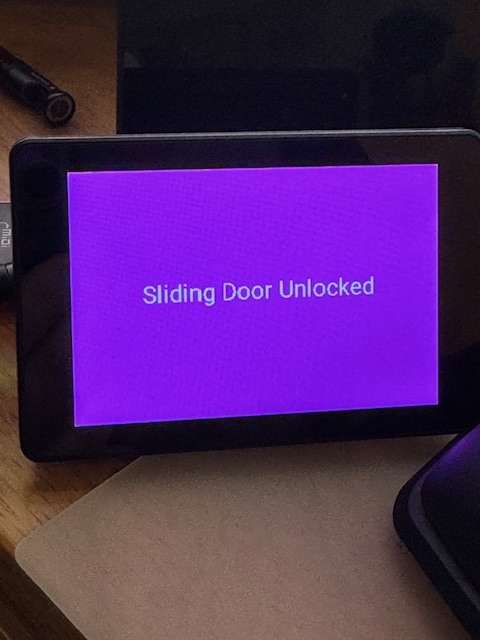

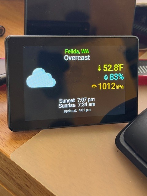

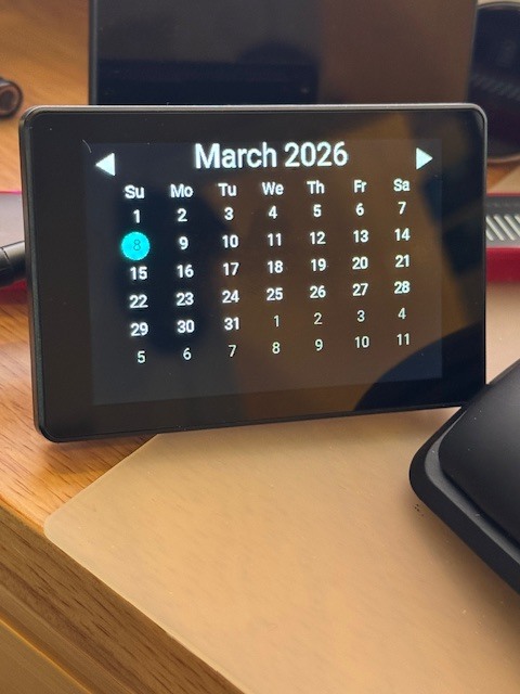

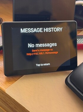

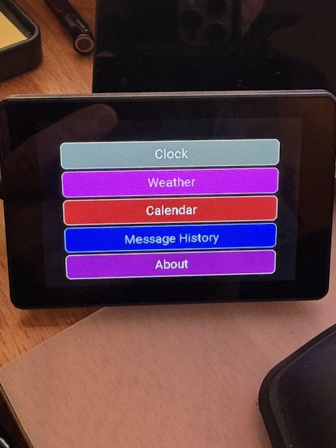

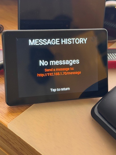

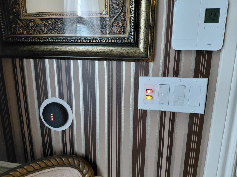

I know this has been solved, but reading through it gave me an idea related to the first post:
The leds are connected in the back to a zigbee power strip with individual usb control. I think it looks neat and not bulky.
Now the only thing left is finding a use for it.
Looks great, nicely done.

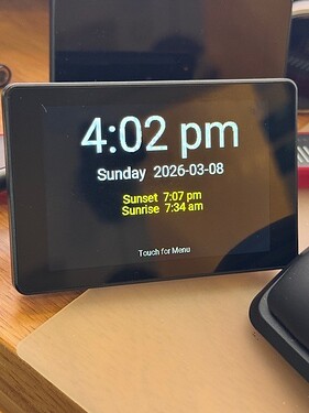

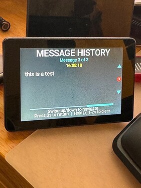

I use Inovelli Blue switches/dimmers throughout my home. The LED bar on selected strategically positioned units is used to indicate various events, such as pulsing red when a door lock is open between late at night and waking hours the next day. Some of my experiments are noted here:
and here:
My home office Inovelli Blue unit got a bit overloaded with notifications, to the point that I sometimes didn't remember what color and pattern meant what for the less common events. So I put together one of the Zigbee USB block+LED's for a discrete indicator of the most important notifications:
I still was not satisfied: what I really wanted was a compact indicator unit that actually told me more about events. So I started playing a couple of months ago with Cheap Yellow Displays (CYD's). With the great help of Claude and ChatGPT, I programmed a 3.5" capacitive display unit to show messages sent by Rule Machine POST commands, like this:
The photos don't show all of the available characteristics of messages: flashing, pulsing, scrolling (vertical or horizontal), font size and color selection, etc., as well as a message history buffer:
The display doesn't sit idle while waiting for messages from Rule Machine. It's also a clock, local weather reporter, and perpetual calendar (either or both of which can be enabled to automatically show for X seconds every Y minutes):
There is also an HTML interface that allows message construction, shows device status, allows over-the-air updates of the CYD's (I have 4 of them now), night mode (reduced brightness between specified times), full clock configuration (colors, fonts, time and date format, screensaver settings), a web log for debugging, dark and light mode settings, and much more.
If anyone is interested, I can make the source code available. You will need the Arduino IDE to compile and load it into the CYD, and you MIGHT have to tweak 2 or 3 lines of standard graphics library code to get it to run. And, as-is, it will ONLY run on this device (about $25):
https://www.aliexpress.us/item/3256807380001174.html?spm=a2g0o.order_list.order_list_main.58.ec741802NIw0QC&gatewayAdapt=glo2usa
I'm only an amateur "programmer" (more of a "AI, add this feature" kind of guy), so the code is strictly on a permanent "beta" status with no guarantee of support (that's why you get the source code).
This is great. I have just bought a CYD to play with. Can you offer any guidance for the best place to find some code or sketches for them? What did you use to program it, did you use the Arduino IDE / Visual studio or something els?. My initial idea was to stream a CCTV camera to it
Below is a link to the current versions of my ESP32 MultiDisplay sketches. One variant is for a 5” Elecrow Advance device with capacitive touch screen, and the other is for a 3.5” JC3248W535C_I_Y device [i.e., a CYD device] with capacitive touch screen. I have older versions that run on a Waveshare CYD and on a resistive display CYD if you are interested (contact me), but they don’t have all of the functionality of the two github versions.
The Elecrow version includes MQTT Broker functionality. Below is a driver that allows Hubitat rules to publish messages to the broker. The non-broker β€œPlus” version of the code has MQTT subscriber functionality. I also have POST drivers if you are interested.
Note: I like the larger Elecrow display for my desk, but it has a problem with β€œtearing” at times, sometimes showing artifacts (e.g., random short line segments); my able coder, Claude AI, says it’s just the nature of that device. I have the smaller CYD’s in various areas of the house and garage.
I use the Arduino IDE v. 2.3.9 to compile and to monitor serial (print) output because the serial monitor auto disconnects during uploading and auto reconnects after loading completes. I edit code with Visual Studio Code. VSC and the Arduino IDE both monitor β€œsaves” to storage so saved code in VSC is automatically shown in the IDE.
