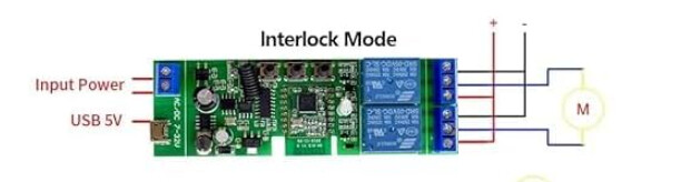

You can reverse polarity with a two relay Zigbee board, if Zigbee will reach out there. Or any two relay board that has interlock and NO, COM, and NC terminals.
Below is an example circuit given on the Amazon page, but it would be what you need. When one relay is open and the other closed, it will have one polarity, then when they switch states it will have the other polarity. The motor goes to COM on both relays. When the one relay is on, it gives + to COM, and the other closed relay connects - to com. Then you can reverse the states of the relays to switch polarity. The Interlock mode turns the other relay off when one is turned on, so they are never on together. You would need another relay to turn off the motor itself, by switching the + feeding the board, or turn off both relays.
