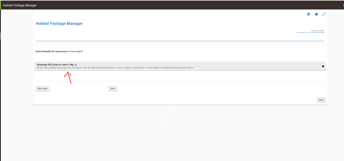

I installed the HPM but I don't see how to search by @thebearmay.
Could you elaborate a bit?

simply use the keyword synaccess in your search...
Thanks,
What threw me off was I was looking for something like "Find A Package".
I wasn't thinking of installing a package so I didn't select that option.
Frederick
