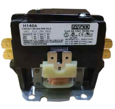

40A definitive purpose contactors are common in air conditioning units. Any thermostat could drive the coil side of a 24VAC coil contactor.

You can use 24V smart thermostat of your choice together with high amp contactor with 24V coil. The contactor will control the heater and thermostat will control the contactor.

This is the solution I would use. Just a plug-in 24VAC transformer to power both a regular 24V smart thermostat, and the 24v contactor. Just replace the 240v thermostat with the contactor, and control the contactor with the smart thermostat.
