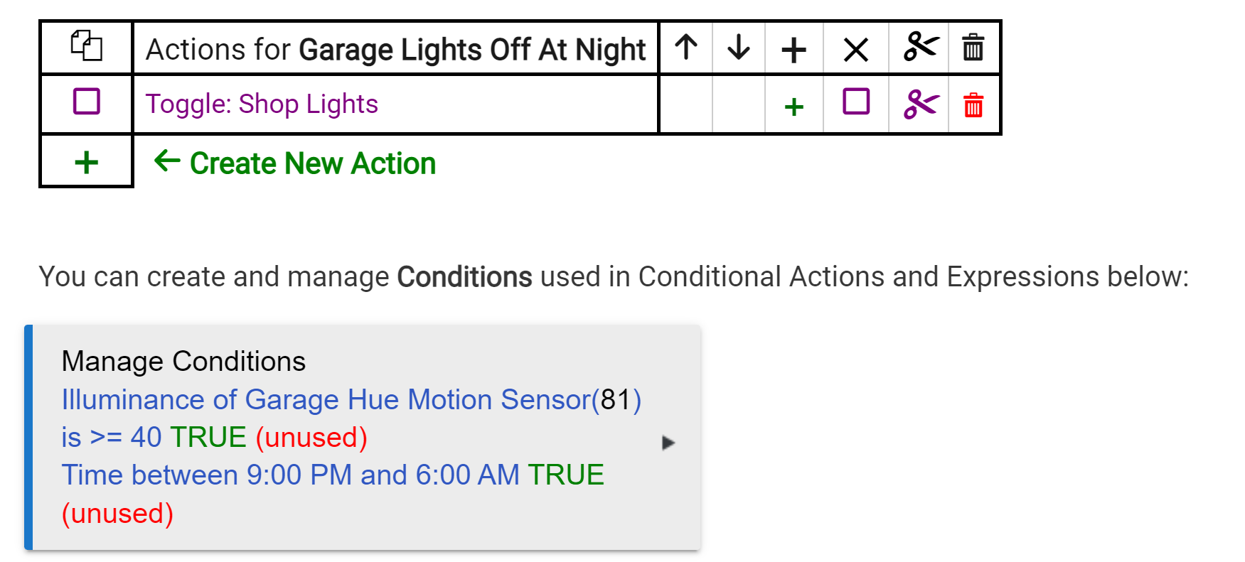

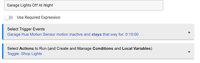

So I tried that and here is my rule:
I did set the start time to 9pm for testing. It didn't work. Not sure why it says "(unused)" behind the conditions that are true. Does not make sense to me. The conditions appear to be correct. Light is above 40 lux, no motion for more than 10 minutes and is within the time frame. Not sure why it did not try to turn off the lights.

One problem I see is that I was trying to "toggle" the light (from on to off). I'm using a zigbee relay to turn my garage opener lights on and off that are also tied to the garage door opener light button which is basically a momentary switch at that point. So to turn on/off the lights I send an "on" signal no matter the condition as a "toggle". I cannot "monitor" the actual status of the lights at this point. I do plan a change to a smart outlet that can be controlled and monitored as a better solution, but I have not gotten there just yet. I guess that would be the next step. But now my Hue motion sensor is not returning an update lux after resetting the lights. Ugh. I can "run actions" and it will turn the lights off but looking at the logs (I did activate all logging) there are no logs. :pensive:

The conditions don't do anything unless you actually use them in the rule in an IF statement. You can see that both conditions are marked "unused."
I'd do it slightly differently than the suggestion above. Something like:
Required Expression:
Time between 11:30 PM and 6:00 AM
Trigger Events:
Motion sensor inactive and stays that way for 0:10:00
Actions:
If Illuminance => 40
   Turn off lights
End-if
*** ETA ***
The reason I'd use motion as the trigger is because it will happen less frequently. Using illumination => 40 would cause the rule to run every time the illumination changes; at 40, 41, 42, 43, etc. Probably not really what you want.

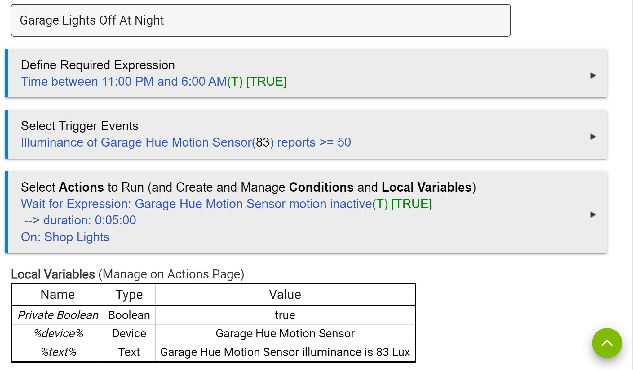

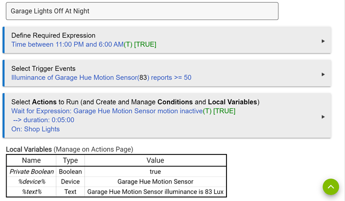

Thank you sir for your example. After tearing my hair out trying to figure out what the heck "RE" was I spotted the "switch" for the Required Expression. I really had to tweak things and used a simple smart bulb as my rest light (in the room I'm sitting in) for simplicity. I had to tweak everything to get any kind of results. Once I did it was just fine tuning the conditions. Here is my current automation that appears to work.
I have no idea what the "Required Expression" is used for as I would think it was a trigger, but whatever, this appear to work. I will run with it for a few days and see if it continues to operate as intended.
The whole thing for this was to be able to not have to get out of bed when my wife says, "Are the garage lights off?" I could tell "Ms. A" to turn them off, but if I don't know the status of the lights, and I don't, she could wind up turn them on instead. This is what I wanted, the "system" to "see" that the lights are on, make sure that no one is out working in the garage (hence the 5 minute no movement) and then drop the hammer on the lights. Now, I will have to remember that there is a 5 minute window to keep moving in there. I do have a diode laser and have to be present when it is operating and I will spend time sitting at the computer watching YT or designing in the software for the laser and be still enough to not trigger the Hue motion sensor. I might have to set the sensitivity to "high" so all I need to do is wave a hand. I'll probably need to make an automation to turn the lights on if there is movement if the lights are off. Perhaps a simple automation or basic rule. I'll play with that.
Thanks to all. This was a great help to me as I would have gone to bed without having any success and it would cause me to lose sleep trying to figure out what I was doing wrong. I greatly appreciate everyone's help and suggestions. I do love this community.
