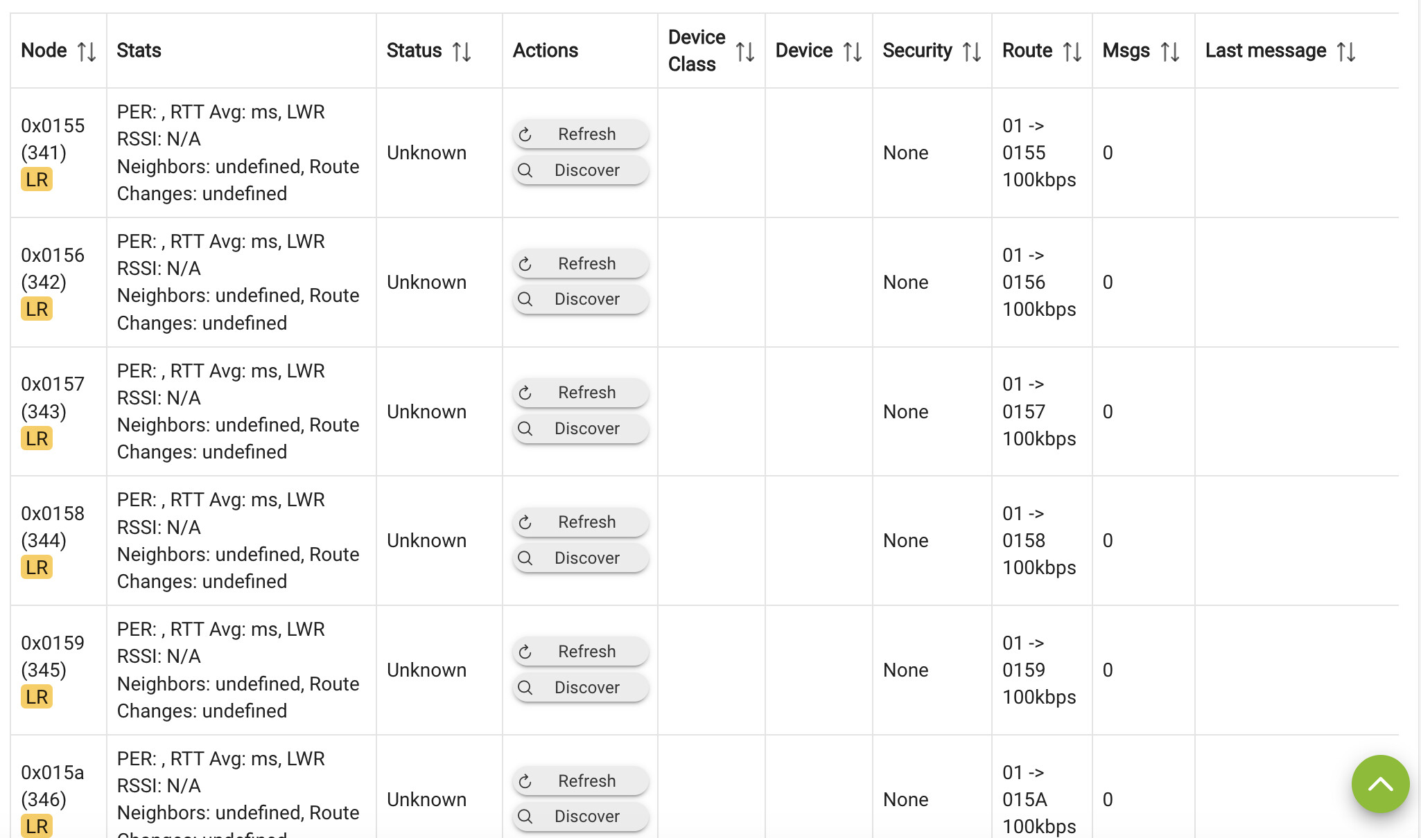

Need Hubitat Support: Z-Wave NVR Erase / Phantom LR Nodes (C-8 2.4.3.137)
Model: Hubitat C-8
Platform version: 2.4.3.137
Issue: After every inclusion I get phantom "Unknown LR" nodes (0x011Aโ€“0x0127).
I cannot access /hub/zwave/radio (404) and have no option to disable Z-Wave Long Range.
Request: Please perform a Z-Wave NVR Erase and disable the LR flag on my hub.
Where did you get that endpoint? As you can see itโ€™s not a valid one (never has been to my knowledge). Could try /hub/zwaveDetails/json but most, if not all, of the detail is on the Zwave Details screen. If you really, really, really want to wipe out the zwave radio use /hub/zwave/reset - Iโ€™d make a cloud backup before in case you change your mind later. Note that the 800 chip will always have LR capabilities available if ZWave is enabled.
Thanks. I have tried a zwave radio reset and a full hub reset and I still have the same problem. Pages of phantom LR nodes. I have not added any of my zwave devices yet as I want to get this issue resolved first. I don't want to have to rebuild my zwave network twice.

Support - any luck yet? Hub still has over 1000 ghost entries. Multiple full resets, zwave radio resets, database resets have been attempted. Power off and unplugged each time for more than 5 minutes. This is the analysis from Chat GPT:
" The Root Cause
Hubitat 2.4.3.x (especially .135โ€“.137) introduced a regression:
  • It enabled Z-Wave Long Range by default on C-8 hubs.
  • It hid the LR toggle and broke the erase-LR command in the firmware.
  • Result: every time you include any Z-Wave device, the firmware spawns โ€œUnknown LRโ€ nodes (0x011Aโ€“0x0127).
This is not user-fixable on those builds โ€” the LR subsystem must be toggled or cleared through the internal SDK, which only Hubitat Support can currently access."
It has been a few hours now and no more LR ghosts appear. What finally worked for me was I disabled the Z wave radio, rebooted the hub, enabled the Z wave radio and then ran a zwave exclusion. Since I did that, the ghosts are gone. Will advise if they re-appear.
The only ghosts I have in my house after Halloween are two LR ones living in my C-8. Power cycling does not remove them and there is no remove button. I guess they will be haunting my C-8 for life. I'm running 2.4.3.137 and hope Santa will bring me a fix for Christmas.
