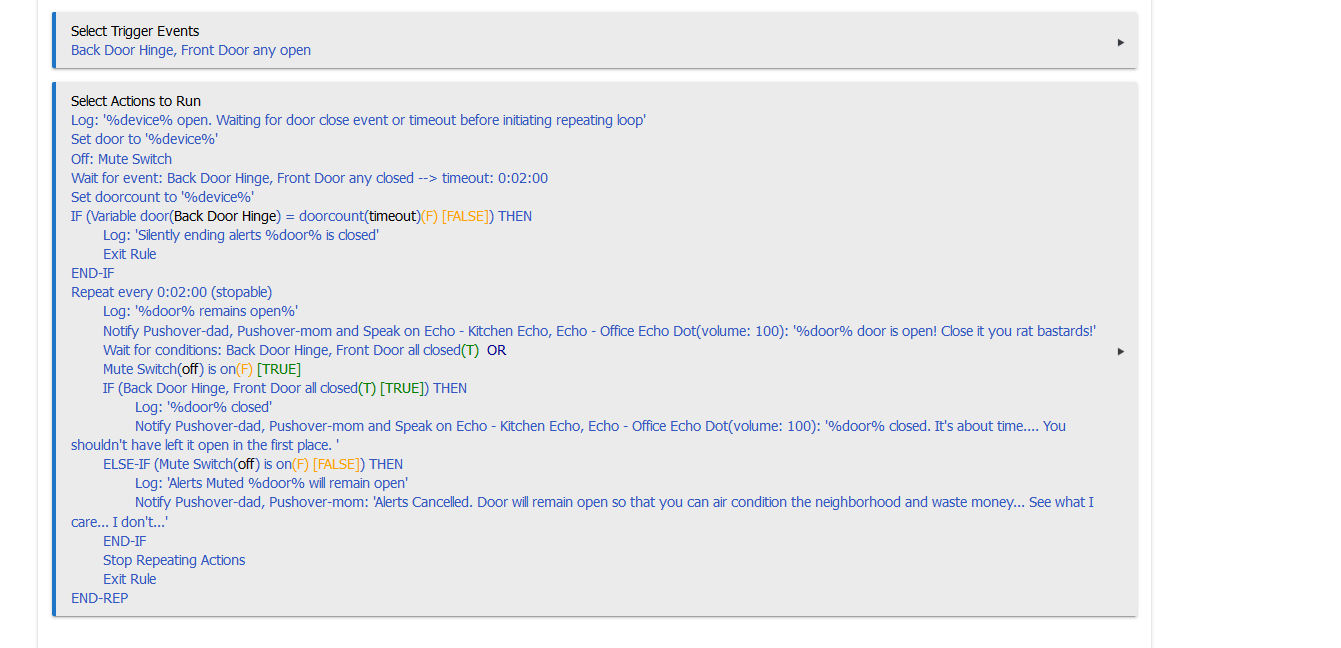

This is what I use for my doors... Easily adaptable to your garage...
Might be worth calling out the parts that are relevant... I am thinking the trigger.... the wait for... the Repeat every.... with some mods...
